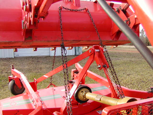

This is the only use I happen to have a picture of.
I have 5 grab hooks & 3 receivers on this bucket. /forums/images/graemlins/blush.gif

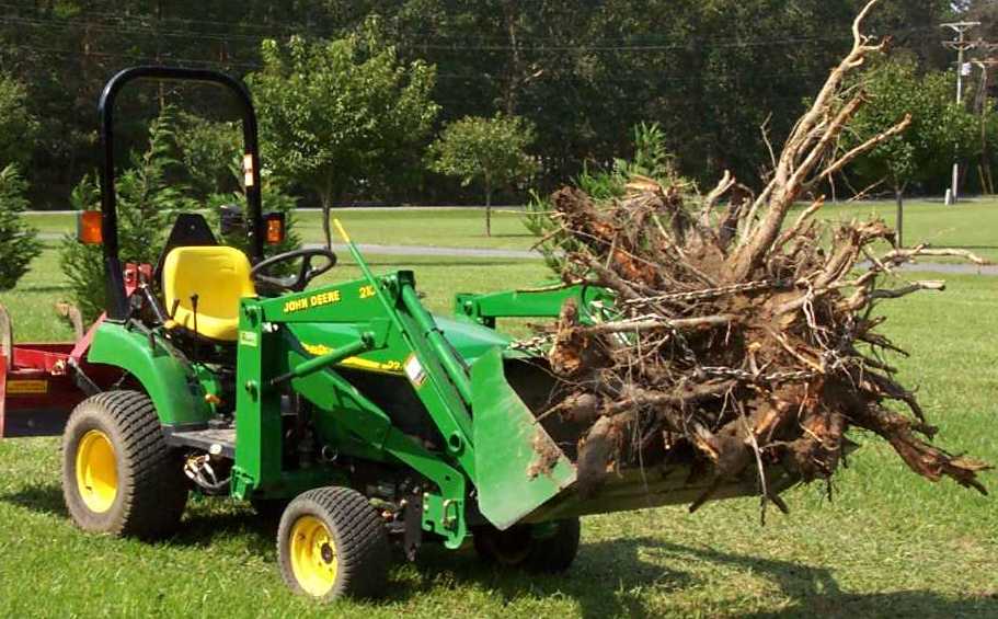

Pulling shubs and dragging logs are my primary uses. I also use the hooks with chains to transport unwieldy items. Here's a pick of the use of chains on my 2210 transporting an "unwieldy item."
