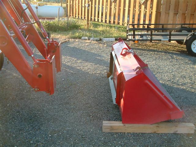

My old tractor had a hook on the ends of the buckets...used it for over 14 years without any issues.
My new tractor has hooks in 4 places. 2 in front of the lift arms and 2 on the outside edge. the outside edge ones are used to help keep loads from rotating more so than for lifting or pulling. I added double layers of 3/8" steel plate (inside and outside) of bucket for added support for the hooks AND for the 2-5/16" trailer ball.

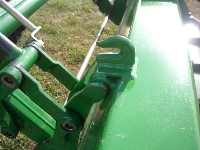

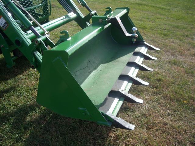

Here's a good location for hooks on a Deere bucket.....right in line with the cylinders. The bucket attachment plates provide a good place for the hooks.
My light duty bucket has been re-enforced along both sides and the top with weldments just like the heavy duty buckets....and has a bolt-on tooth bar. The receiver hitch is handy for moving trailers and provides another location to hook onto.

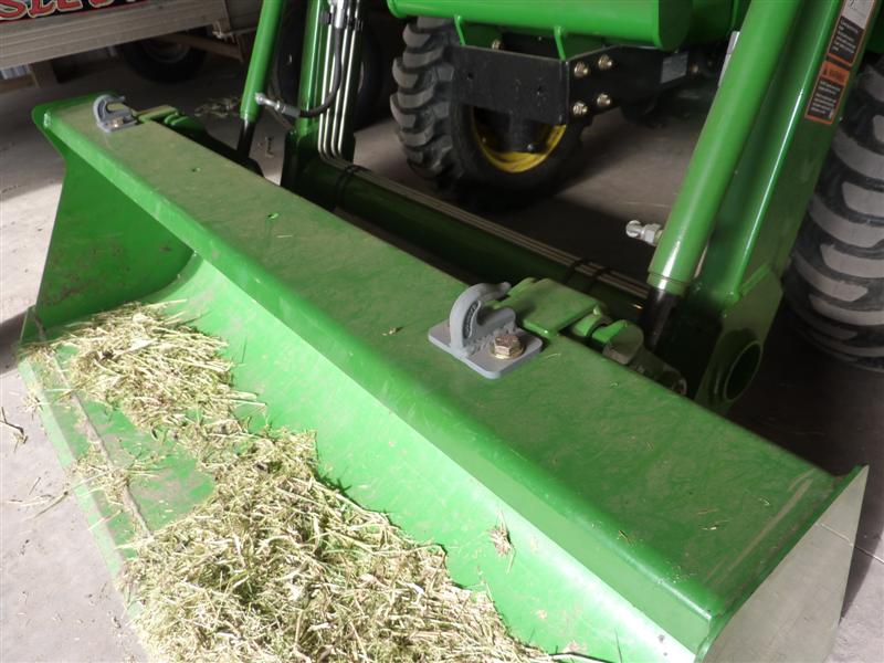

Of course....there's always Ken's bolt-on hooks - if you don't have a welder. This is where my SIL put his - right in-line with the cylinders. (He knows he should not lift super heavy loads without having re-reinforcement on his bucket.)
This has been an un-solicited endorsement of a fine product: Ken's bucket hooks. (nice product Kennyd ;) )
