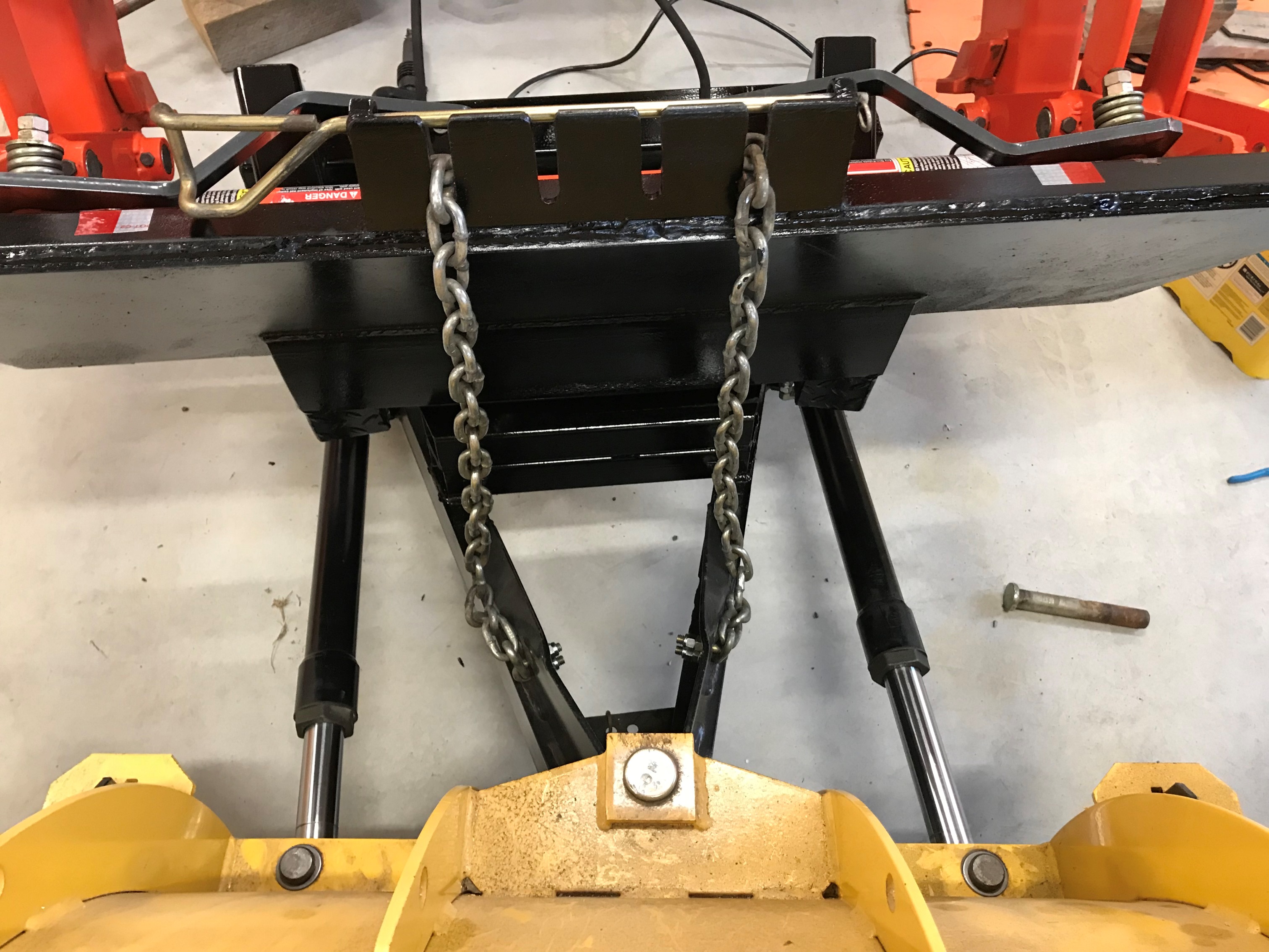

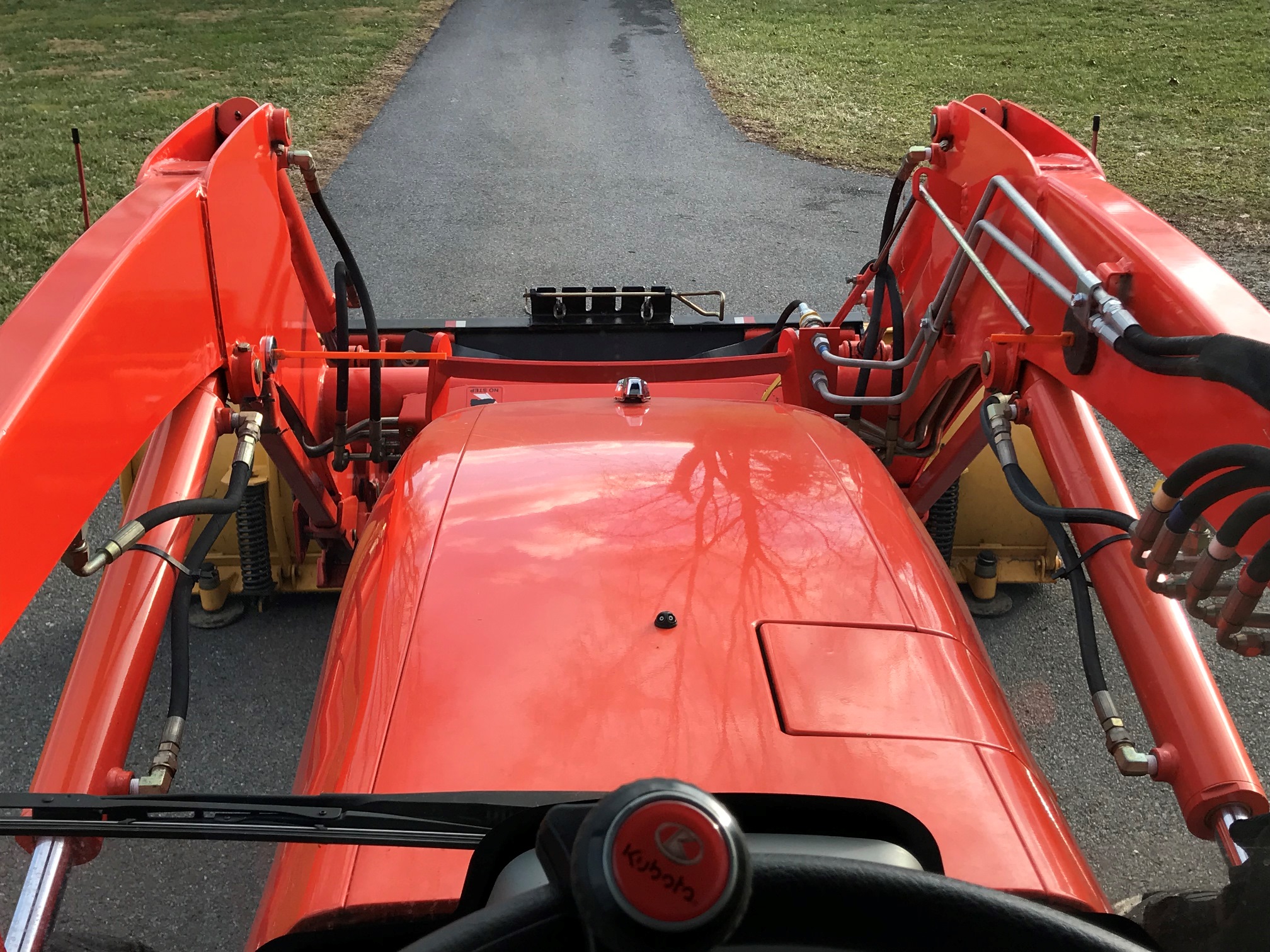

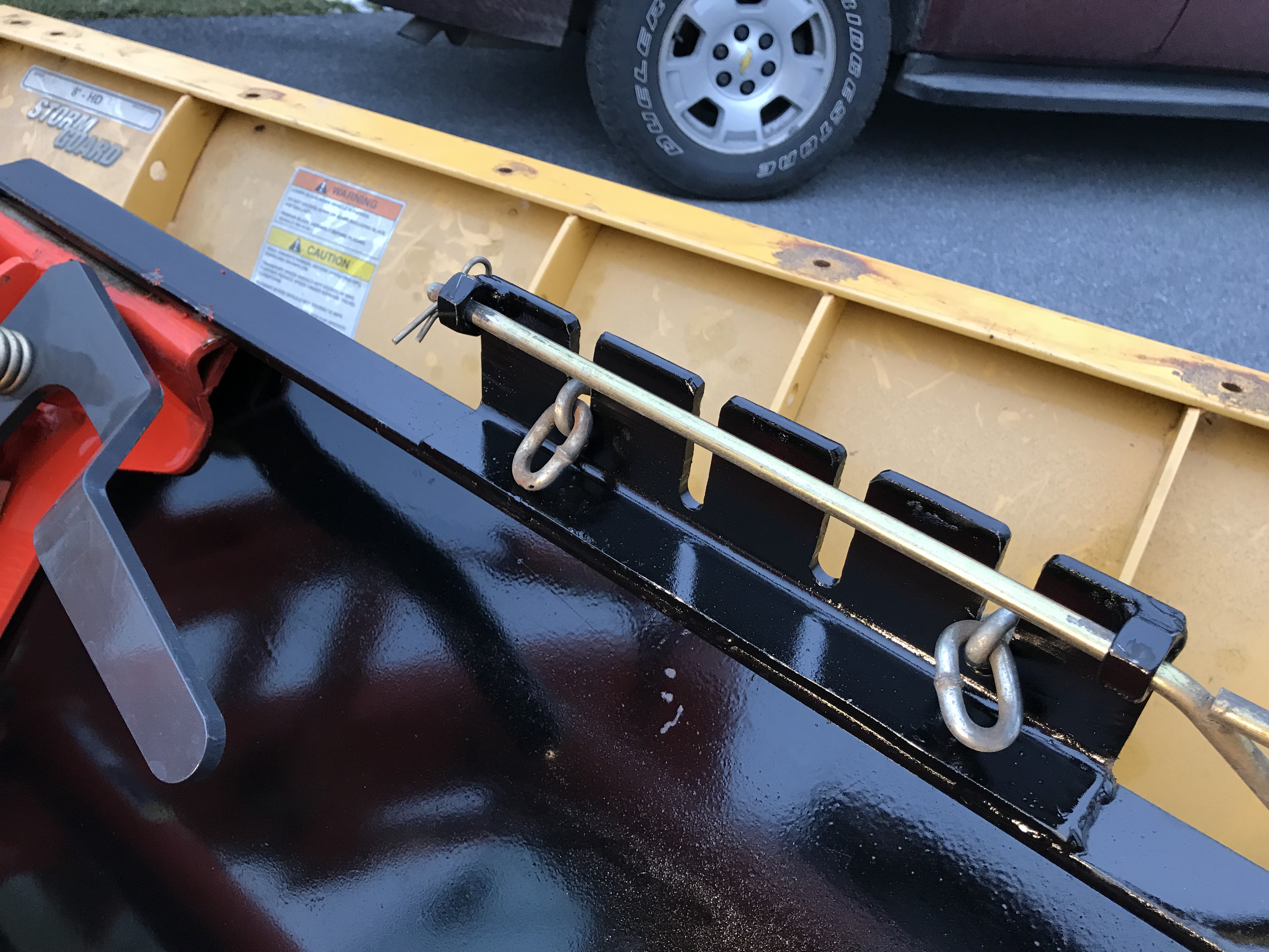

On my SSQA plow mount, there's a slotted angle for the float chains and it has a couple extra slots.
