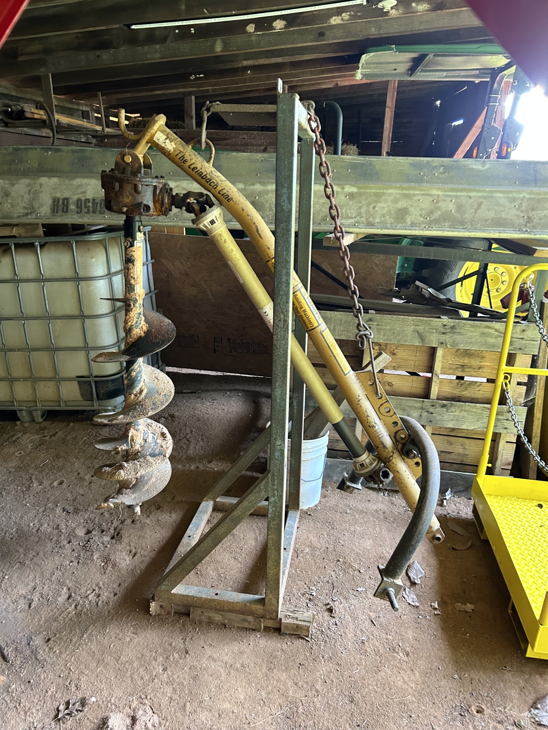

The key requirement is supporting the weight of the PHD. My PHD is hung from a hook welded to a salvaged frame.
Using one hand, I connect the PHD arch to the draft links. Then using the 3 point control, I lift the arch till the PHD top link meets the tractor. The PTO shaft is connected after this.
Then the tractor lifts the PHD off the hook ... At no time am I lifting more than a few pounds. The tractor end of the PTO shaft is tied to the PHD to keep it out of the dirt.
