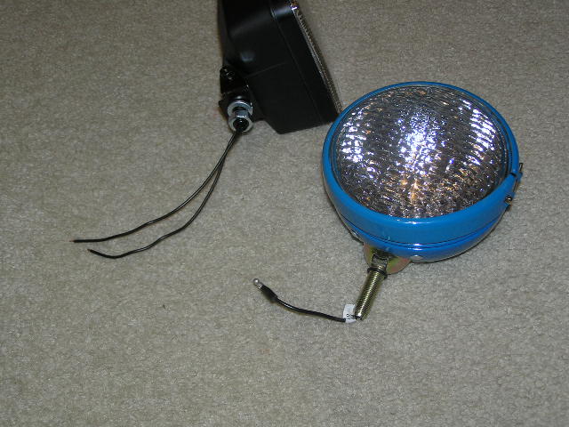

I am planning on hooking up headlights (standard replacement) and a backlight (50watt/4amp) to my 8N this weekend (see pic of headlight and backlight). Have some questions on installation.
How do I hook to my 12V battery? Each headlight has one wire coming out of it and the backlight has 2 wires (see pics). Do I use both wires on the backlight?? I believe the positive battery cable has a small wire coming out of it near the terminal connection- do I hook into this?
What type (amp) toggle switch should I buy and how do I connect (I"d like all lights to be connected to one switch). Where is the best place to put the toggle switch?
Is there a recommended place to hook up the backlight where it"s least likely to get damaged?
Any other tricks in hooking up the lights to a 12V system?...I"m not good with wiring so any tips will help.

John I'm no electrician but you probably should either open up the light with 2 wires or use a testor on it because I'll lay you odds that one of those leads is riveted or connected to ground inside that light. Just touch one lead of the meter to a lead and the other to the mount if you get a continuity reading thats your ground (take the bulb out first before checking). Another easy way if no meter is take a good d flashlight battery into a dark closet and touch one end of the light lead to the bottom and the other to the top if you see a faint glow you'll know positively that the wires coming out are 1 positive and 1 negative. You probably should still crack that light open though to see which is which the light stands a good chance of being grounded to the case and to one wire.
I'm sure with all the electrical engineers on this site someone will chime in and give you a more technical, correct way to hook it up and check it but for sure don't try it until your certain because if your circuit is fused heavy enough you'll blow a big hole in your brand new light or worse start a little electrical campfire on your tractor.

The light with one wire should just need a battery source and will ground itself to the tractor (ofcourse it needs to be mounted to a metal surface. The two wire light will probably need a battery source and ground (unless maybe it's a dual bulb light?). If you wire direct to the battery make sure you get an inline fuse and put it in between your battery and switch. I would imagine just about any toggle switch at the local parts store will get the job done. You may also be able to find a power source at the fuse block and you could simply tap into the dead side of the fuse (the side that doesn't have constant power).

You may want to add a couple of relays to that light system, use "in-line" fuses on your main hot leads if no room on the main fuse block. If the back light has a plastic housing then one lead is a ground and if the bulb is a "bayonet" type (not push 'n' twist) base then either wire can be grounded. /forums/images/graemlins/cool.gif

Don't trust your 50 year old rusty sheetmetal as a ground for the 1 wire lamps.. run a seperate ground and terminate it with a ring terminal under the lamp base mounts.
Get a switch rated for the total load.. fuse it.. and have fun.
