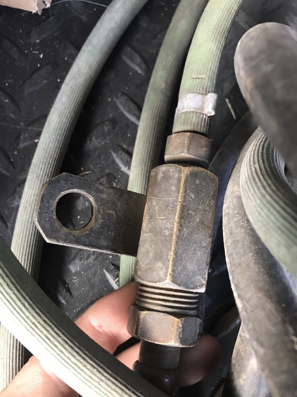

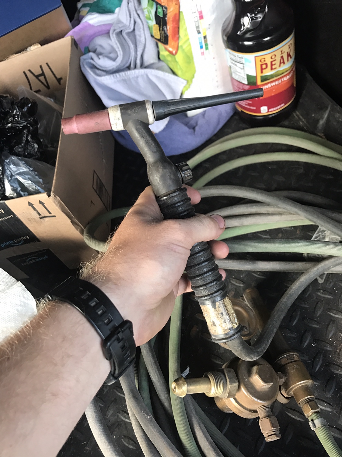

   / Hook up gas valve tig torch to everlast power arc 200 st
Heres 2 pictures that hopefully will help describe what I'm working with, i was told today this unit was used with an engine drive before i got it. It has a victor flow regulator on the other end, im unsure the brand of the torch itself. Are tig consumables pretty interchangeable? And after doing some more fooling with the torch itself it feels like theres a wire inside the hose, i assume i can make a lead that attaches to the brass lug and put a male dinse plug on the other end to get power to the torch from my welder

   / Hook up gas valve tig torch to everlast power arc 200 st #9
View attachment 560424View attachment 560425
Just take your stick stinger and hook it up to negative, then connect the tong end to tab with the hole in it on the power block. You can insulate this connection by sliding an old glove down with one finger slightly cut out for the cable and dinse connector to run through over this. You are then good to go.
   / Hook up gas valve tig torch to everlast power arc 200 st #10
I also use my stick welder leads to simply connect to the power block on the manual tig so no need to buy anything at all if you have that power block lug. I find me an old plastic bottle in a size I like (e.g 2 liter pop or 1 liter pop) and cut the bottom out of it and slide the cap opening over the tig hose and then slide the bottle cut open end over where where the stinger connects to the power block as a crude insulator just for safety sake. I always use the stick weld stinger on the power block connection and that leaves my ground clamp still free for the clamp to the metal being welded connection just like always. I do the polarity flip with the dinse connectors at the welder.
