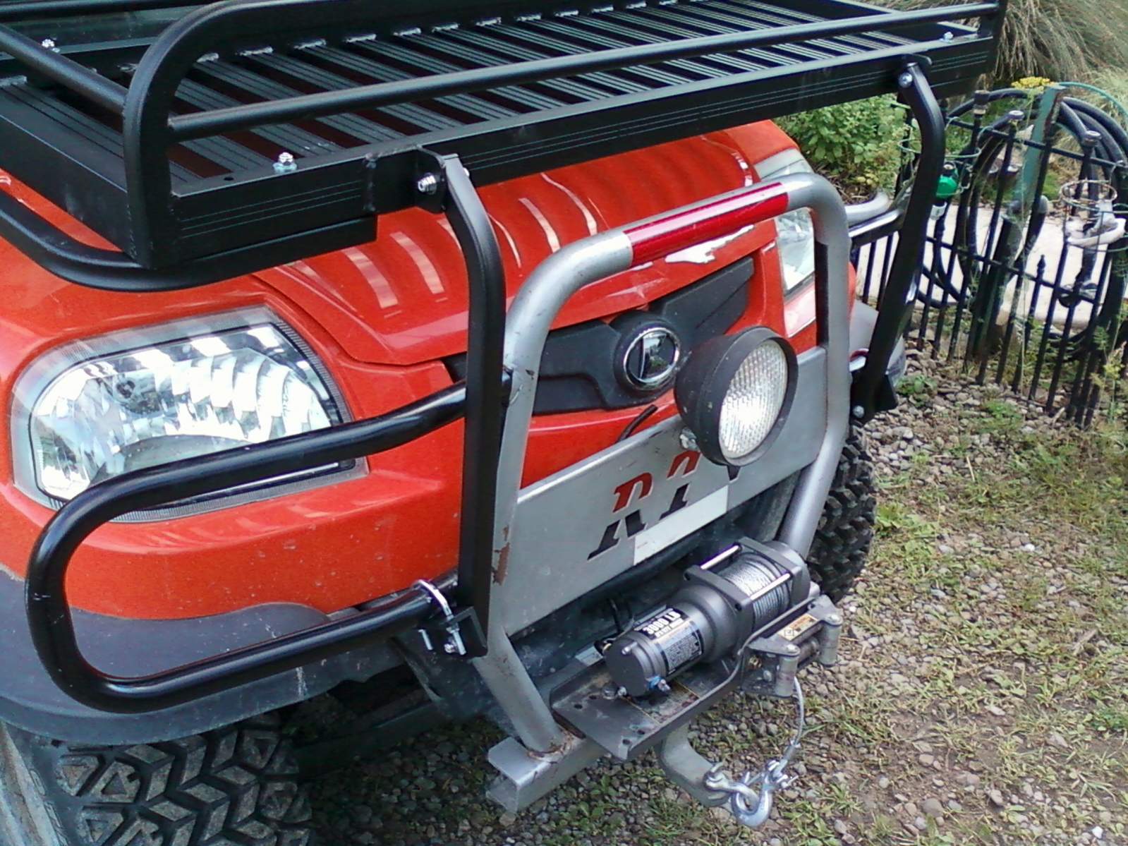

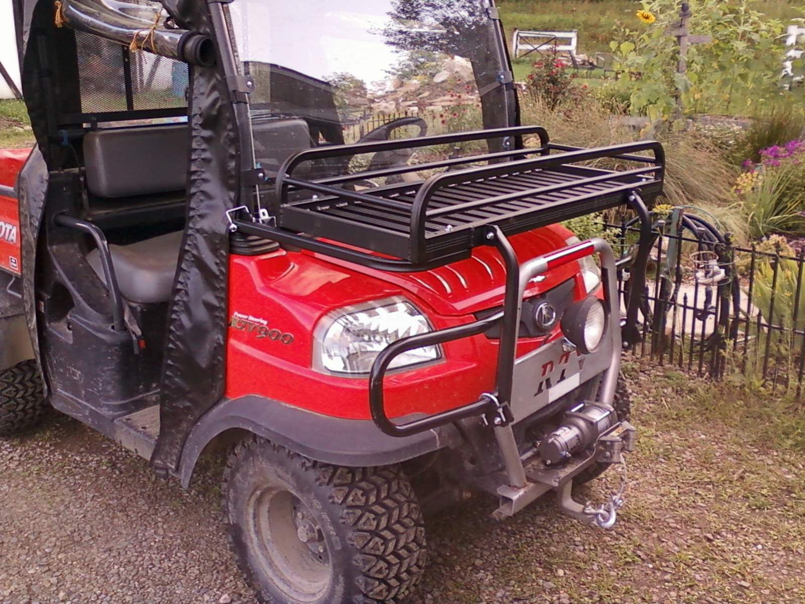

The rack arrived via FedEX today, and I'll give it a A- and call it a very good value.
Documentation BAD (D)
Quality of construction VERY GOOD (A)
Made in U.S.A. EXTRA CREDIT!
Flexibility of installation VERY GOOD (A)

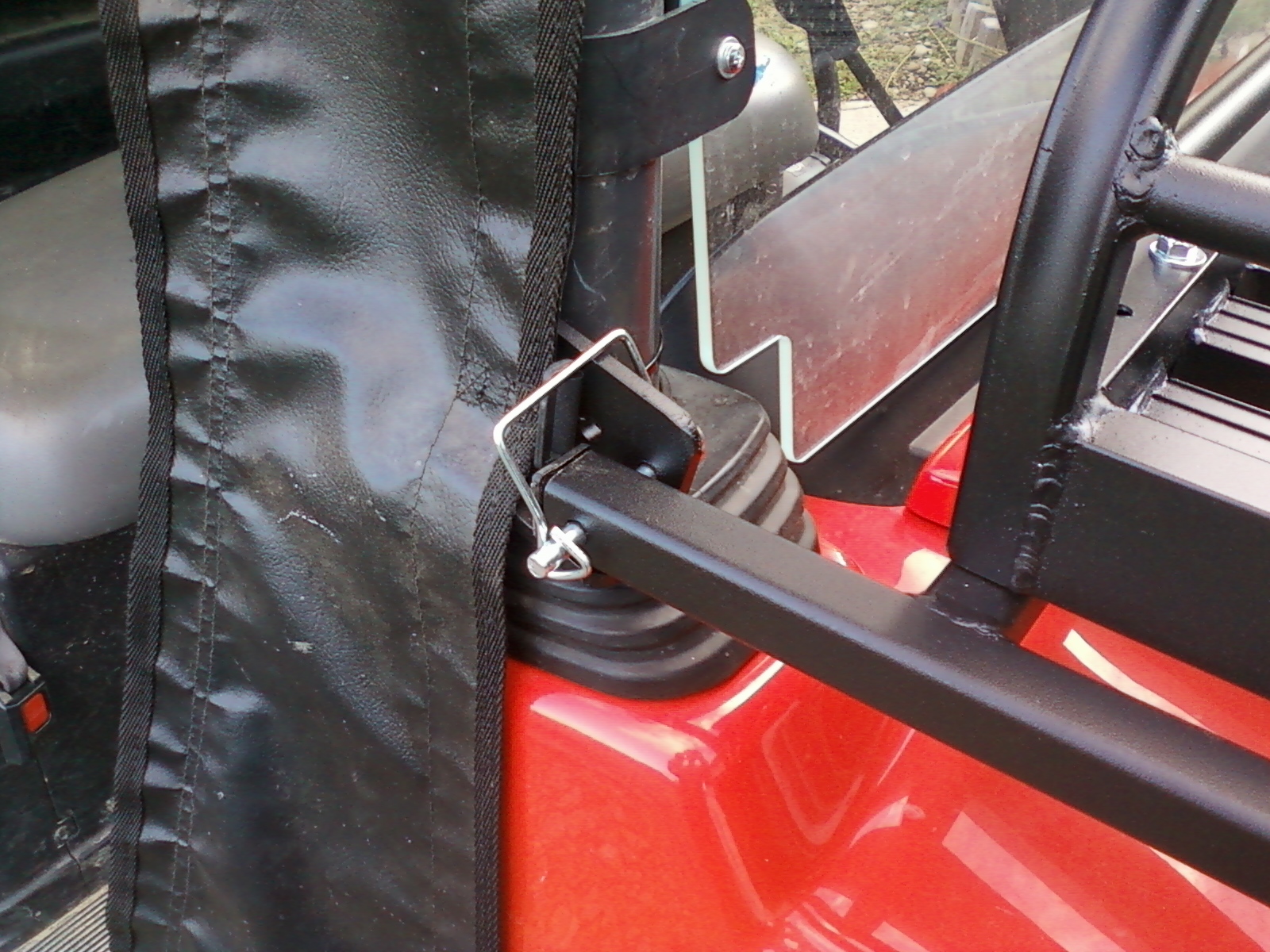

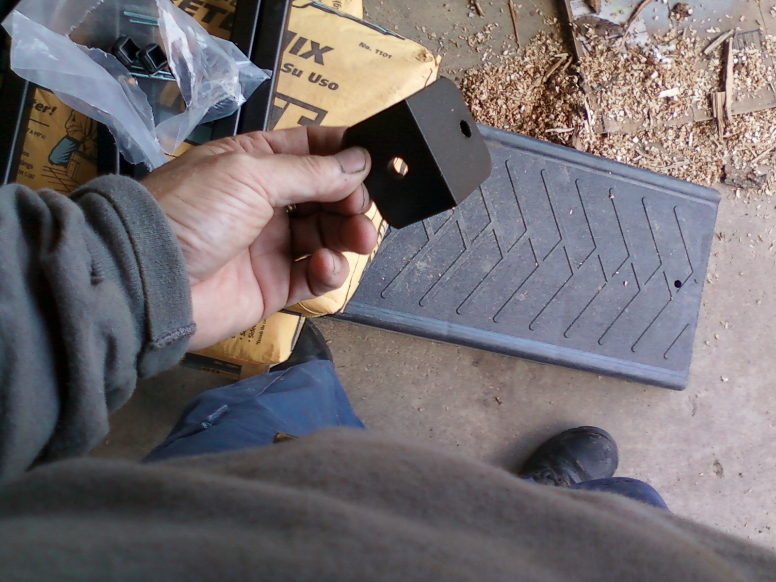

Step 1 in the instructions stopped me dead since my ROPS is 2" O.D. and they provided hardware for a smaller ROPS. A call to Michael in technical support has replacement hardware on the way. (Very good customer service) I used ty-raps to hold the original brackets in place until the replacement hardware arrives.
The finish on the rack is very nice. A dull matt black that looks like it will hold up well. The depth of the rack is great and will hold my saw in the case with no problem.

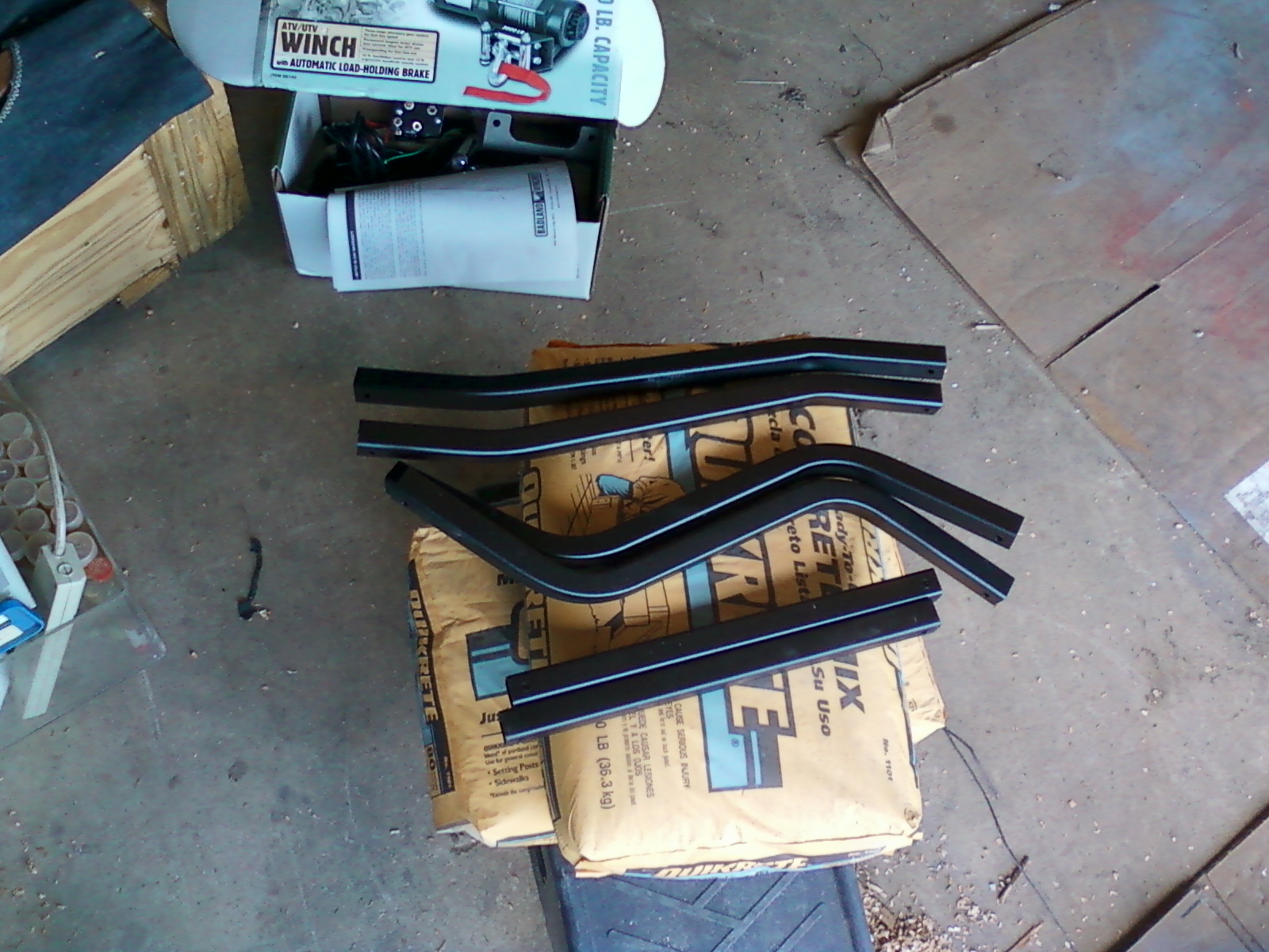

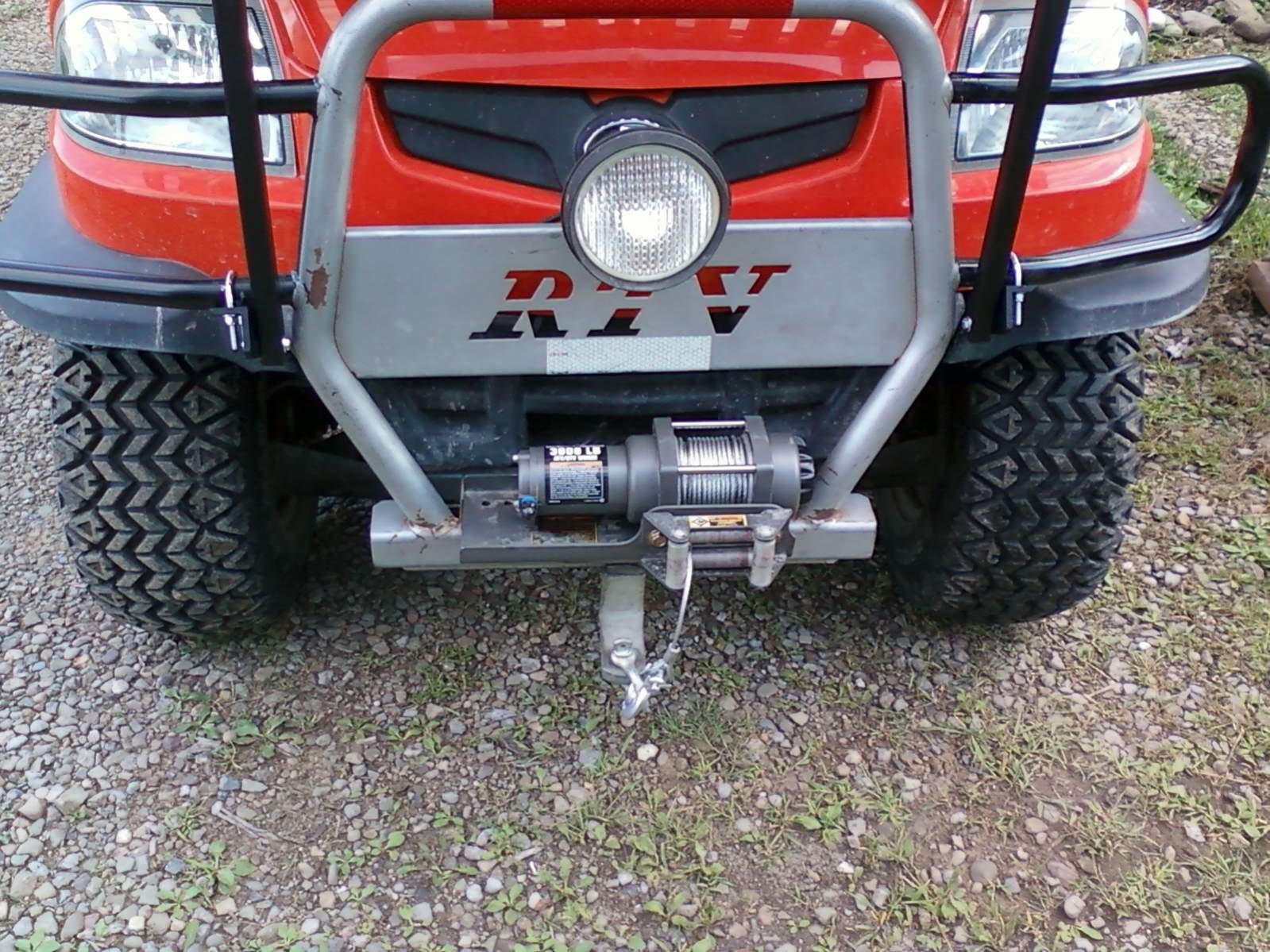

They provide four different front support solutions so that you can pick the mounts that best match the geometry of your front grill. Very nice! (Three in photo, and fourth used in the installation.)
I had a pair of brackets left over. That makes me nervous, and I chalk it up to the very (VERY) poor installation instructions. I encouraged them to put a bit more effort into them, and a second sheet of paper in the box to cut down on the phone calls!
I got mine through shopperschoice.com for $176.25 delivered. This is a very competitive price, and I think it's because they have a drop-shop arrangement with Great Day. (Search under UVFR751 to find it fast)
http://www.shopperschoice.com/item_name_Great-Day-Inc-UTV-Front-Rack_item_2565936.html
I'd give this rack a thumbs-UP! :thumbsup:
