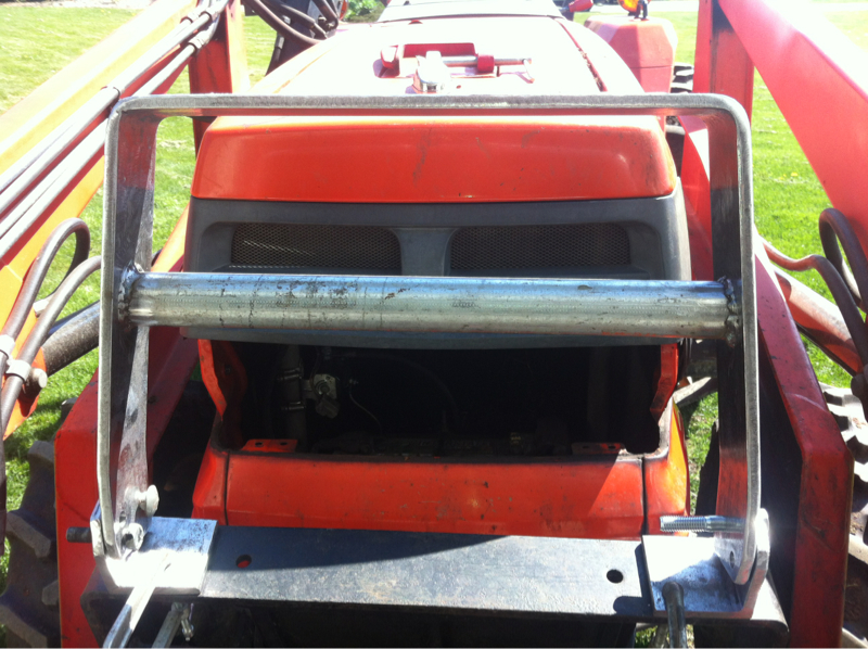

Needing to build or buy a hood guard for my Kubota B9200. Could use some help on design or guards on the market. I'm thinking of one that comes back about half way over the hood and may or may not include a grille guard.

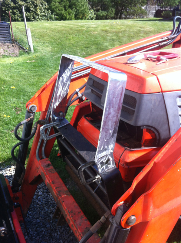

Here is one I built for my L3300. Hope this helps.
J.

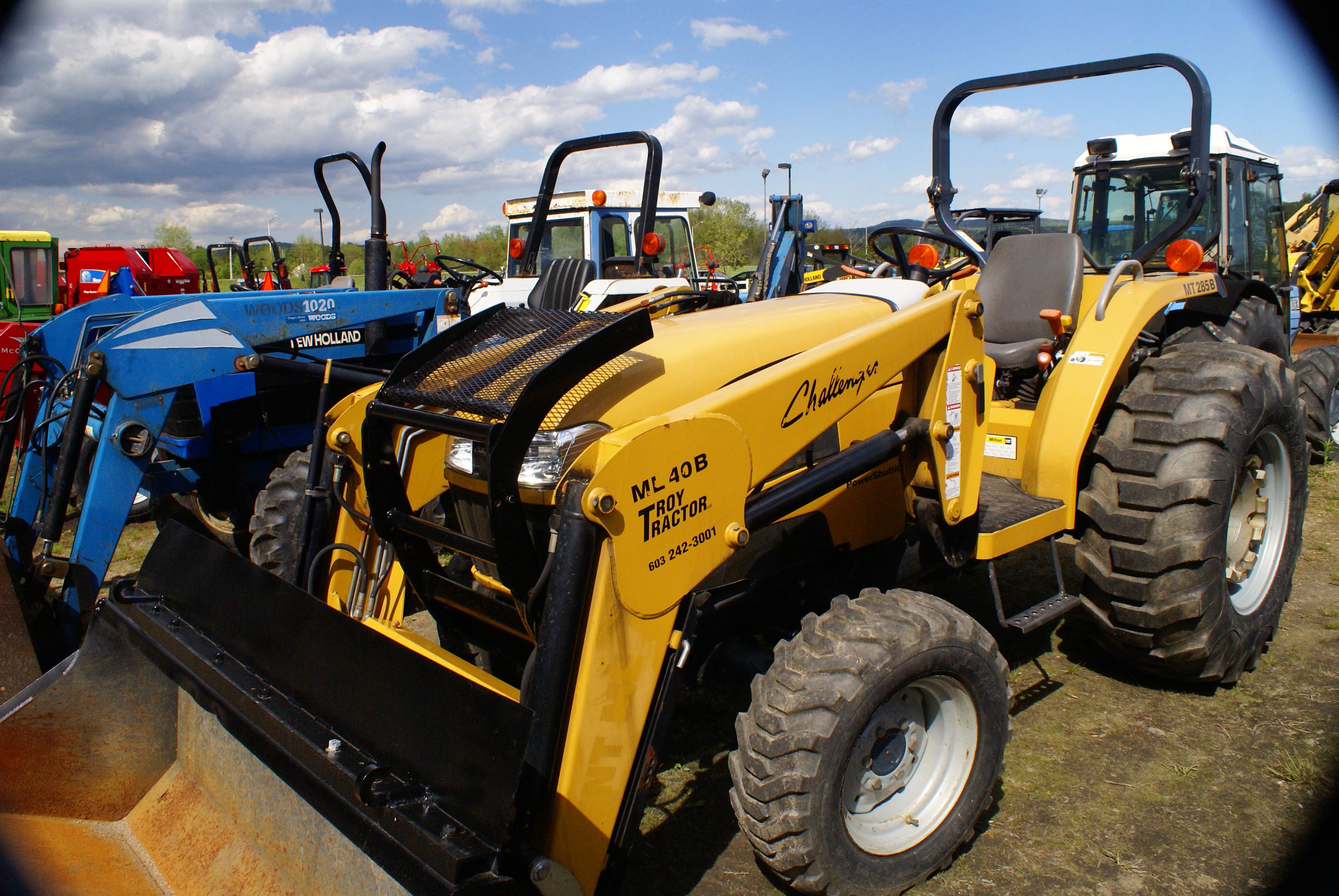

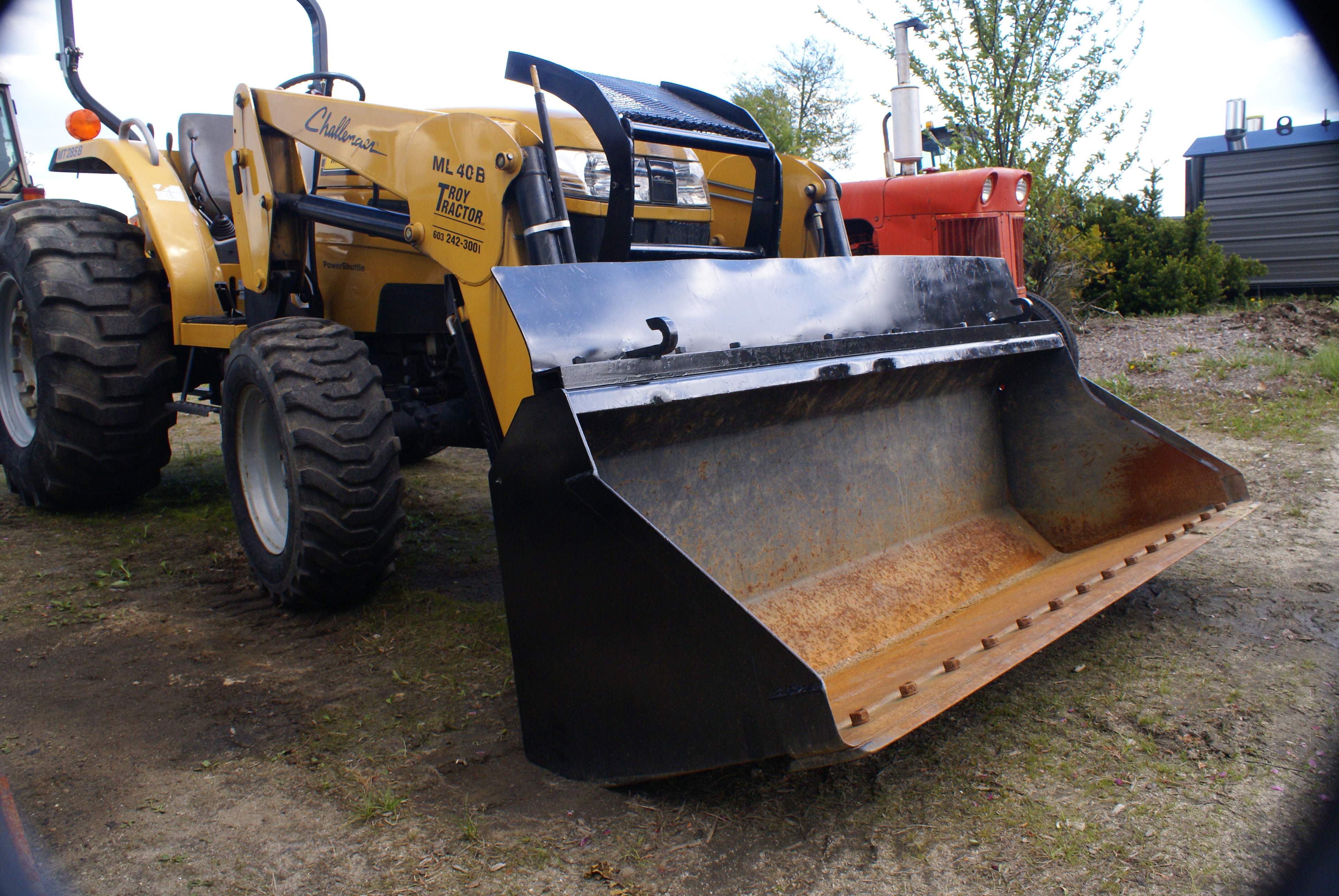

I'm looking for something like this Deere Xtra Armor hood protector:

I built a heavy duty grill guard for Dad's Kubota that sticks above the hood a couple of inches and covers the hood by a couple of inches. It seam to be enough, even when dangling large logs from a chain on the FEL
