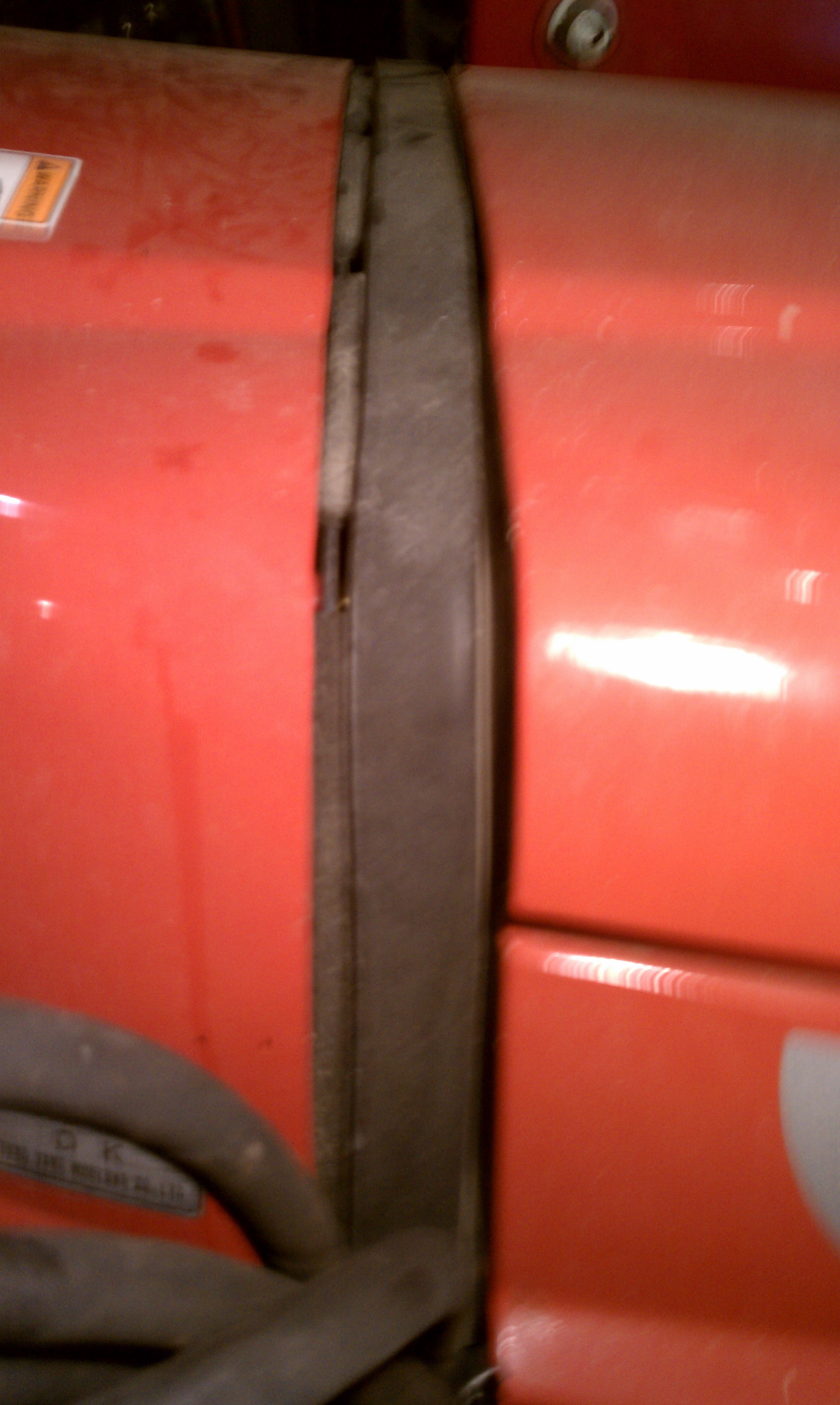

On my Mahindra 4110 the hood and dash seem to be separating. The strip where the rubber casket between the two is much wider than when I purchased the tractor. Has anyone experienced something like this and fixed it?
Thanks, Mike

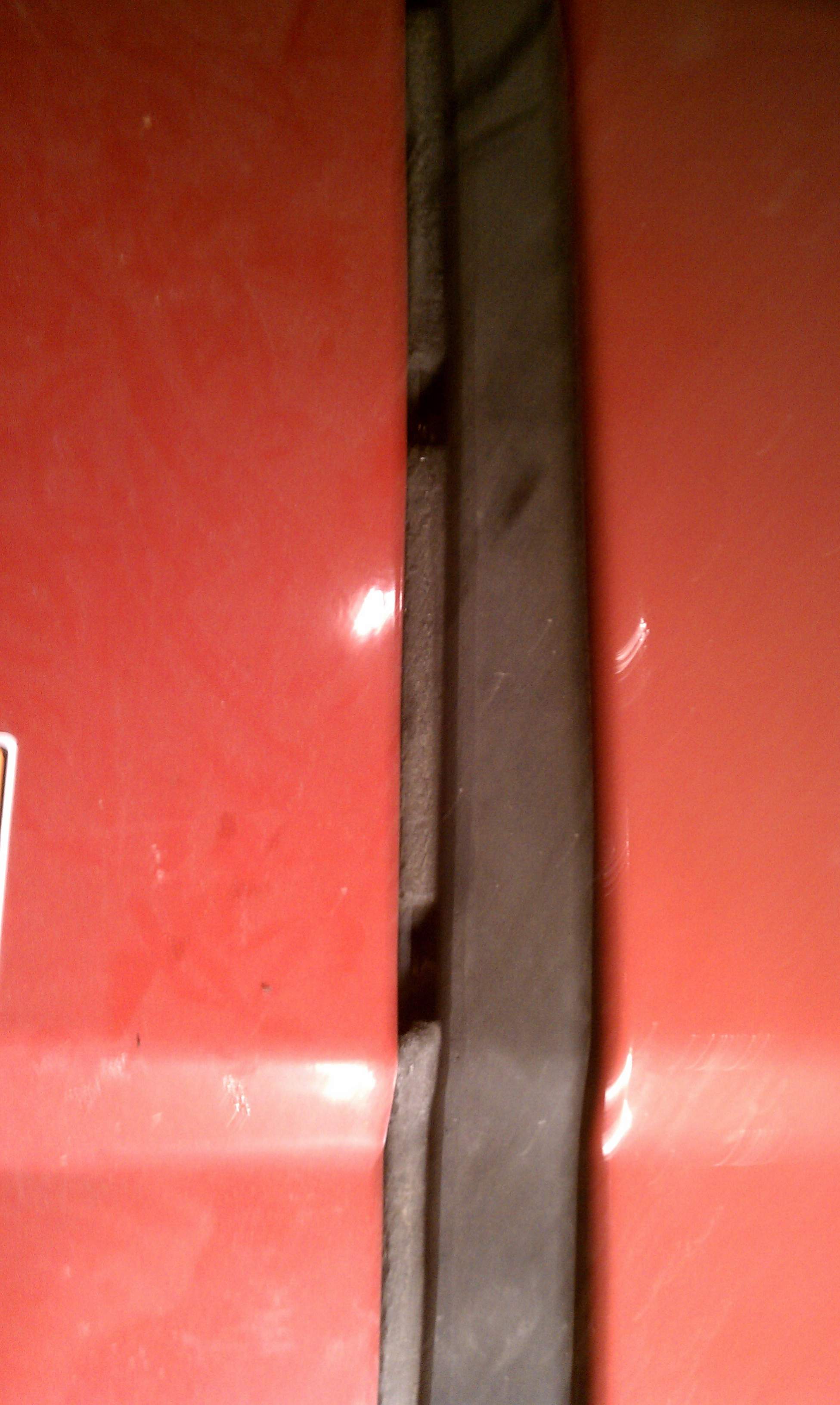

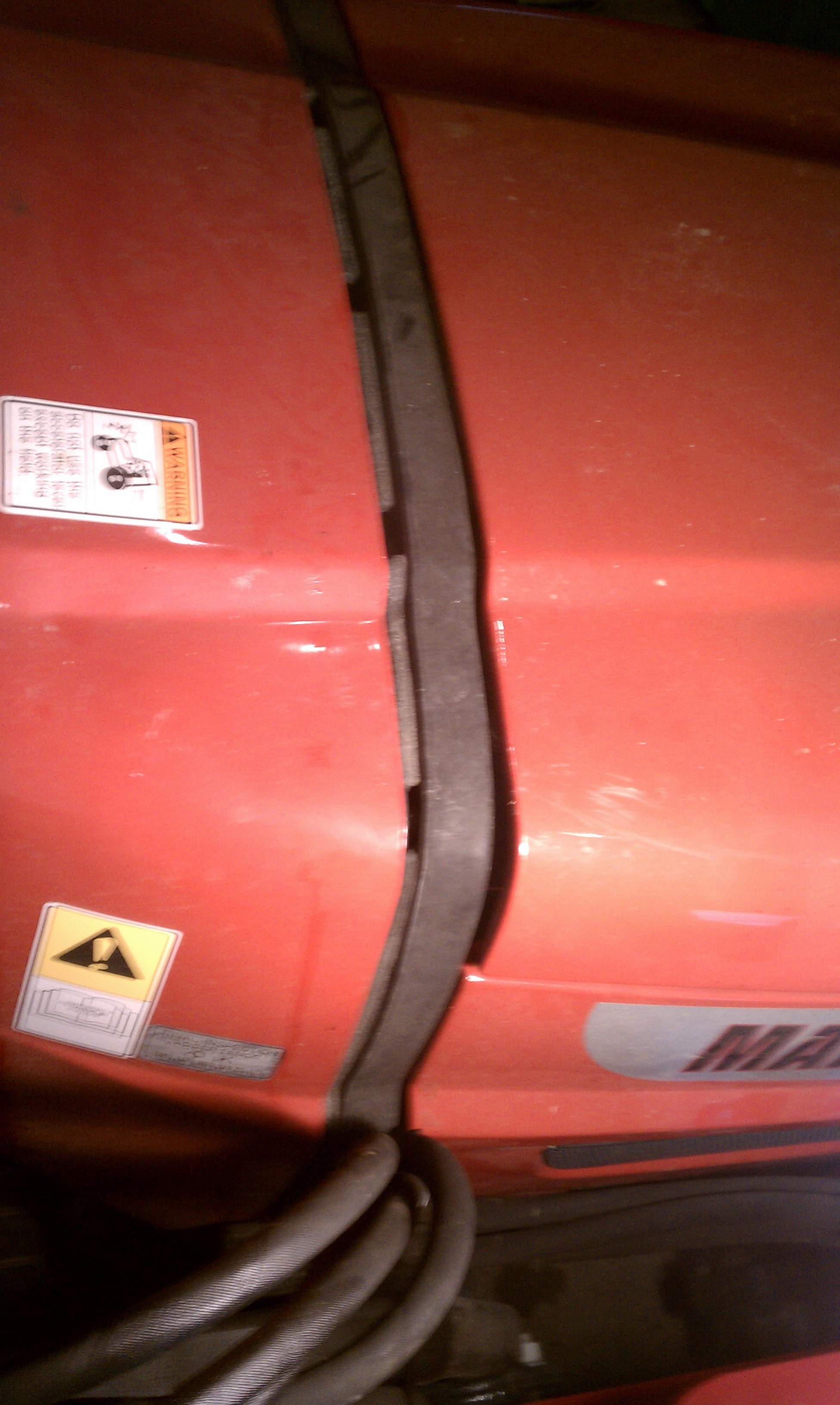

Could the rubber strip just be distorted? The sun is hard on them. Take a picture for us. Thanks, Dave
   / Hood dash separation
Dave,
Thanks for the reply, haven't got anymore hits from anyone. I think this happened while I was using a 3pt hitch backhoe, so who knows.
I have attached three pictures.
Thanks, Mike

   / Hood dash separation #4
Better check all of the bolts and joints holding the chassis together. I didn't like the sound of it when you said you think it happened when using a 3PH backhoe.

This is worrisome. As said above, check bolts and also look for a cracked bellhousing. Three point backhoes are bad news.

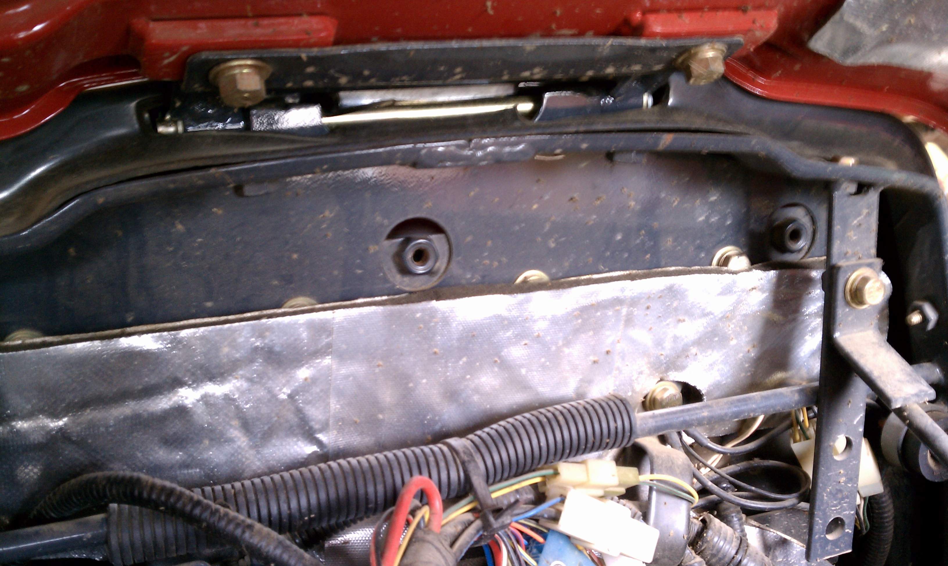

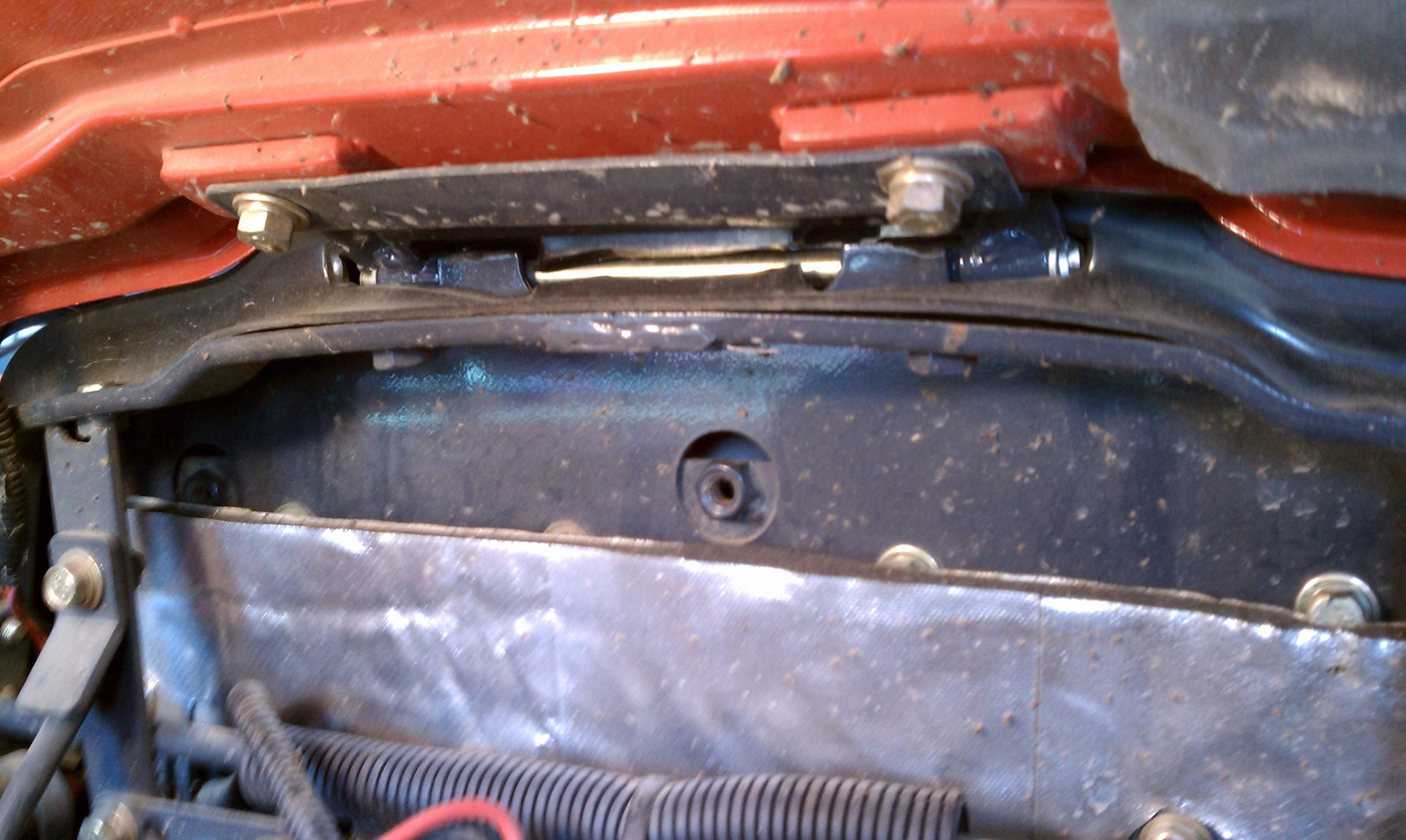

I had already read post about 3pt hitch backhoes breaking a tractor in half and I have already checked all the bolts and joints and nothing except the hood seems to be separating.
It looks to me that there are, or should be a couple of bolts going through the firewall (don't know if thats what its called or not) from the engine compartment side, that screw into some nuts (welded) to the dash. I don't see the bolts but I do see the nuts and holes. Maybe they vibrated loose and fell out. Should there be some there? That to me would pull these two back together.
Thanks, Mike

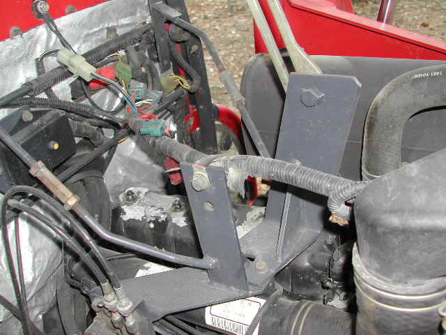

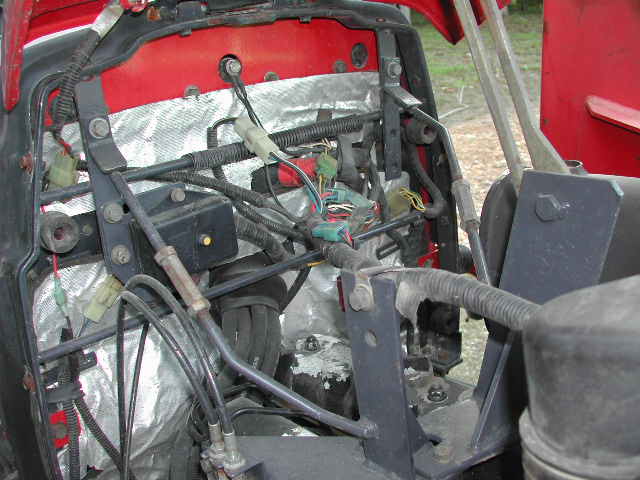

Skipmarcy,
Where are those strut rods located. I have included some pictures of the welded nuts I see from under the hood that don't have any bolts in them. It would seem there should be a bolt in each coming from under the pastic dash bonnet into these nuts.
Do you have a pictures of these struts?
Thanks, Mike

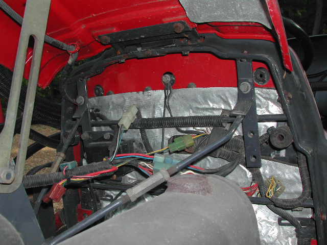

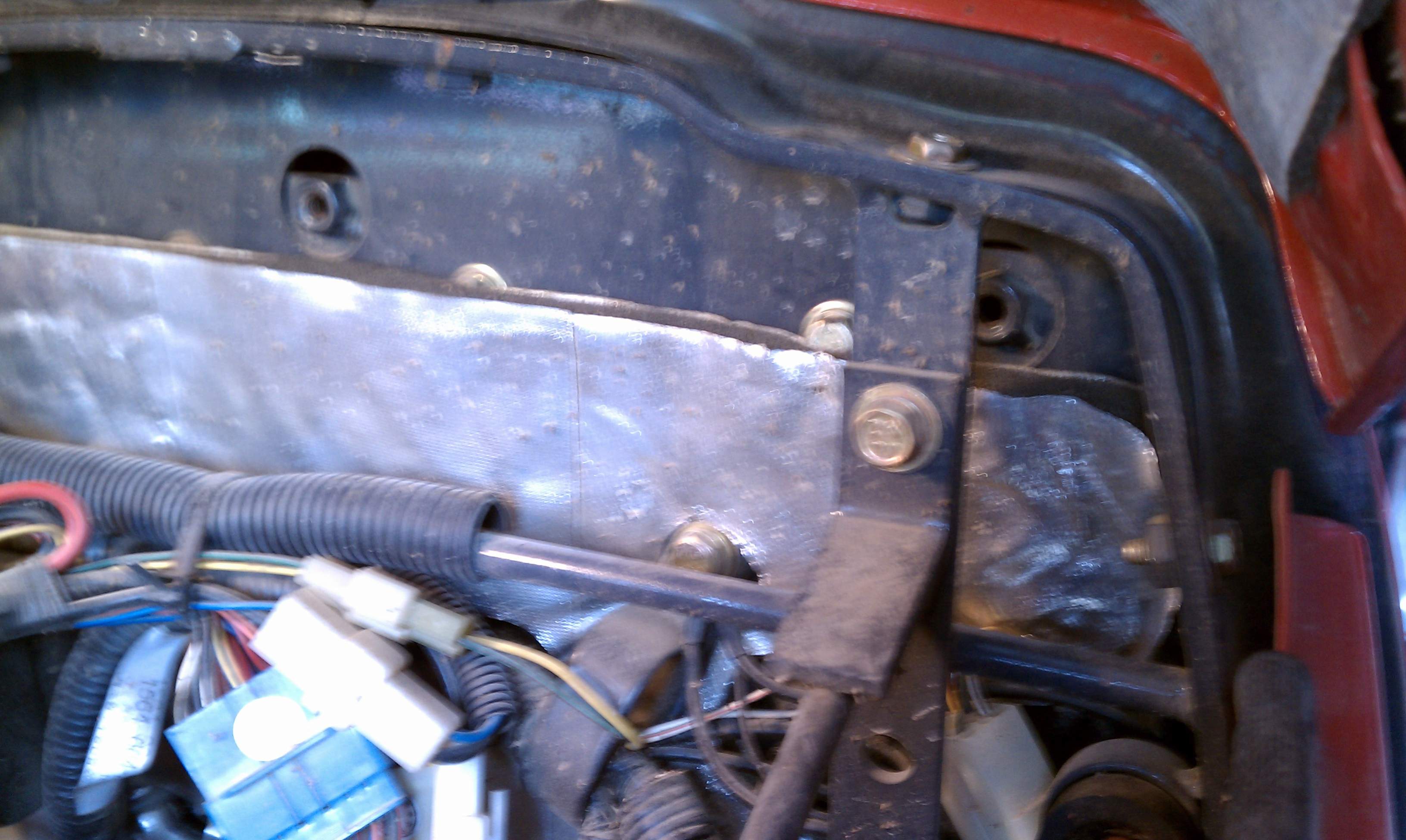

   / Hood dash separation #9
Just slipped outside and took a few pics for you. Those welded nuts are empty on mine too, you can see the framework & struts I referred to and how they attach to the firewall & engine.
