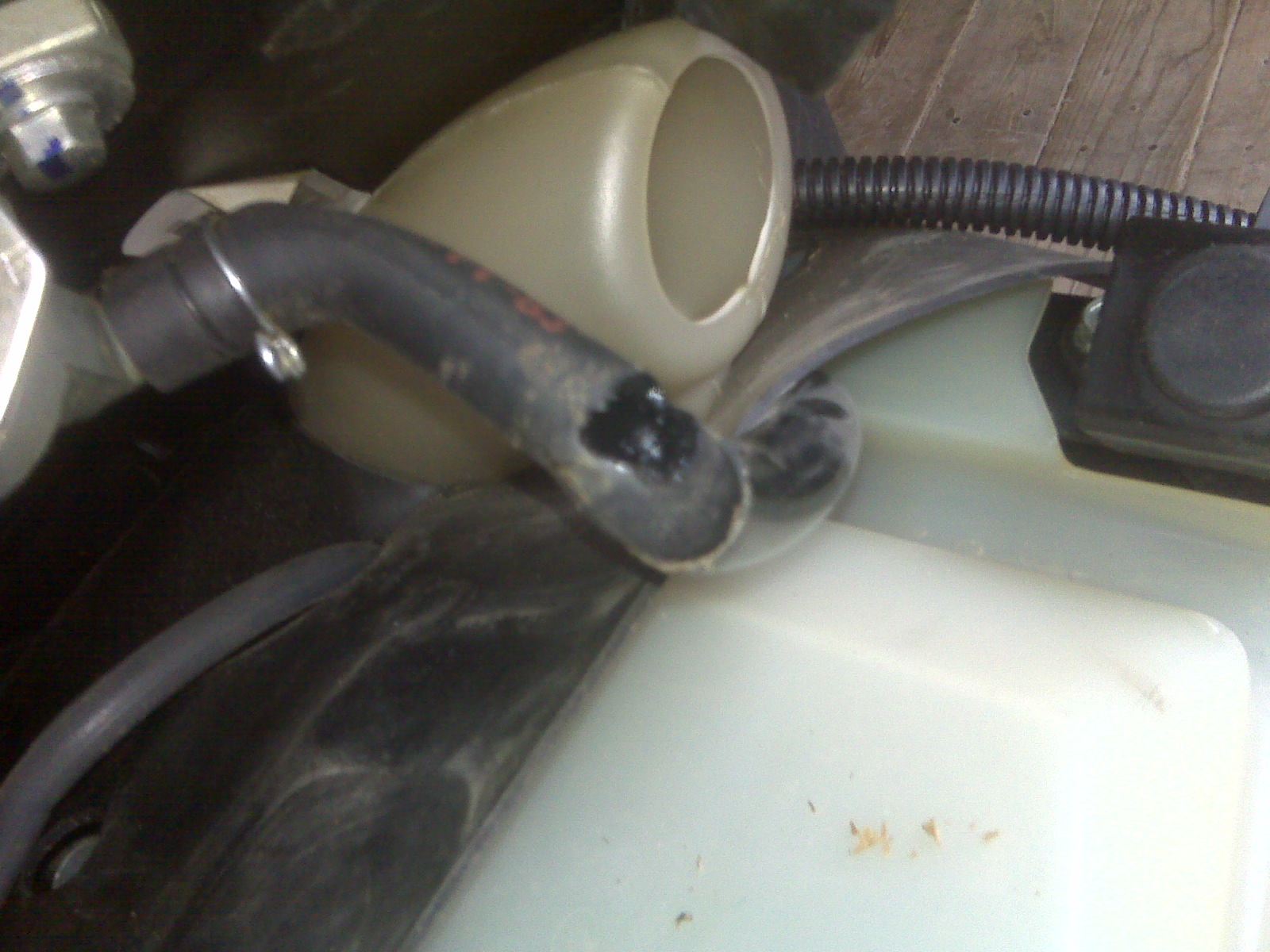

'99 Foreman 450, very low mileage (490) leaks fuel from the carb overflow tube...yes I do know it's likely a sticking float, and I can easily R&R the carb and clean the float...but what baffles me is, when the float is sticking, why doesn't turning the fuel valve to the "off" position stop the fuel flow???
On mine it doesn't...the tank will empty itself through the carb overflow tube WITH THE FUEL VALVE turned to off....???? Makes no sense to me, thanks for any advice.

The crud that is making your float stick is also jamming your shutoff valve, I would clean and drain tank as well. It is also possible that the valve does not line up perfectly with the "off" position, try moving it slightly off the mark and see if it stops.

Thanks for very prompt response....I will do that today. Machine may be low miles but that also might explain crud buildup (fuel is not used very fast) :thumbsup:

Had a similar problem with one of ours;it's the needle and seat that needs cleaning.May want to run some fuel stabilizer.I also added an additional fuel filter(in line),most have a fuel filter in the tank.

I am sure you pinpointed the leak...I pulled the fuel tank, the cheapo rubber (non reinforced) hose right under the tank was hardened and had a small crack, which may explain the leak. I removed the tank, flushed it out well with several fillings of water, blew it as dry as possible with an electric blower, and there was some crud in the rinse water that ran thru the fuel valve. The valve also will not shut off properly at the index mark, I am going to install a secondary shut off valve when I replace the fuel line.
