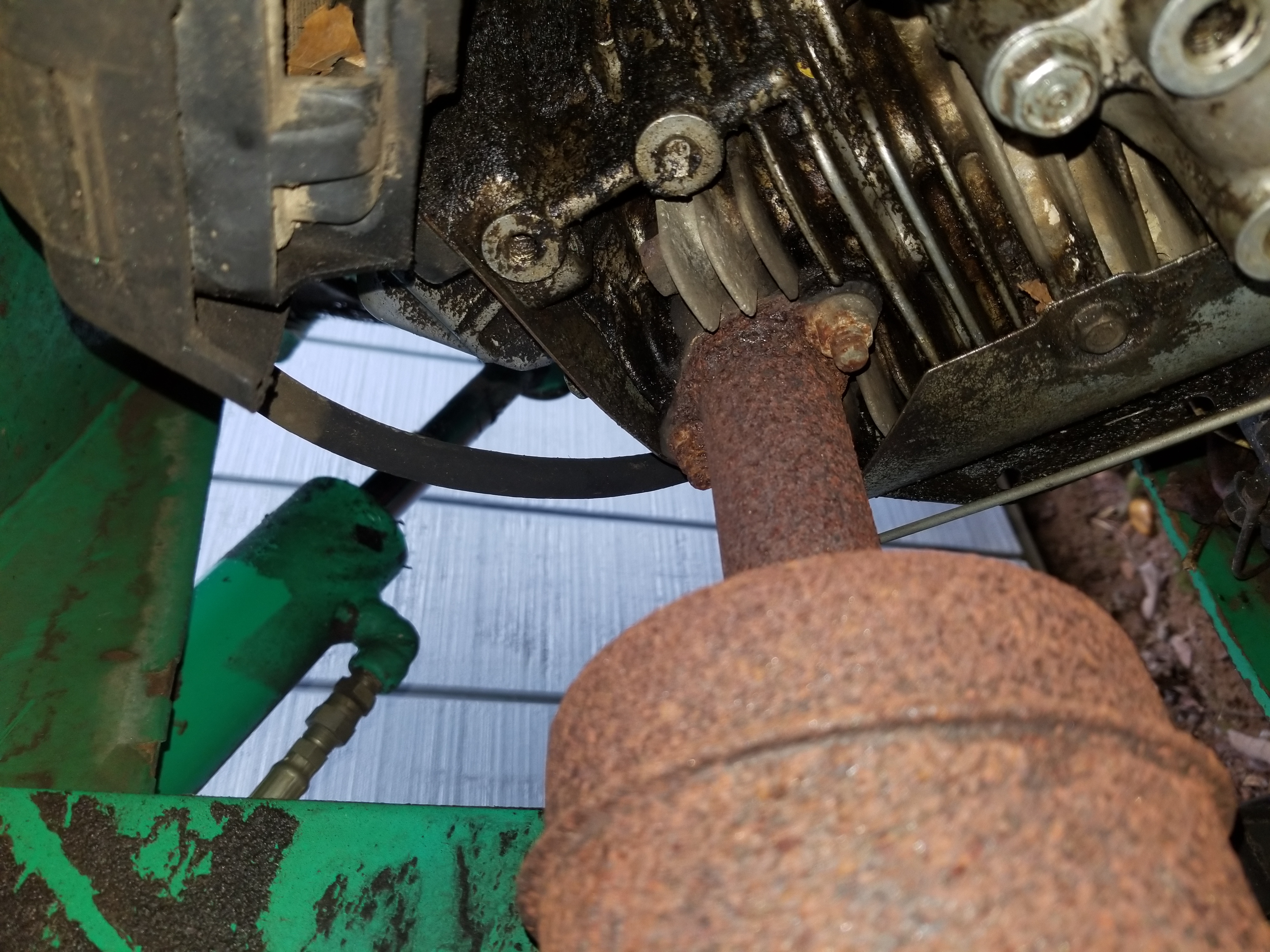

The exhaust on my T5c has rotted out, its loud and annoying. I read somewhere that terramite stopped making that exhaust. Other then cutting and welding, are there any mufflers that will work on the t5c.

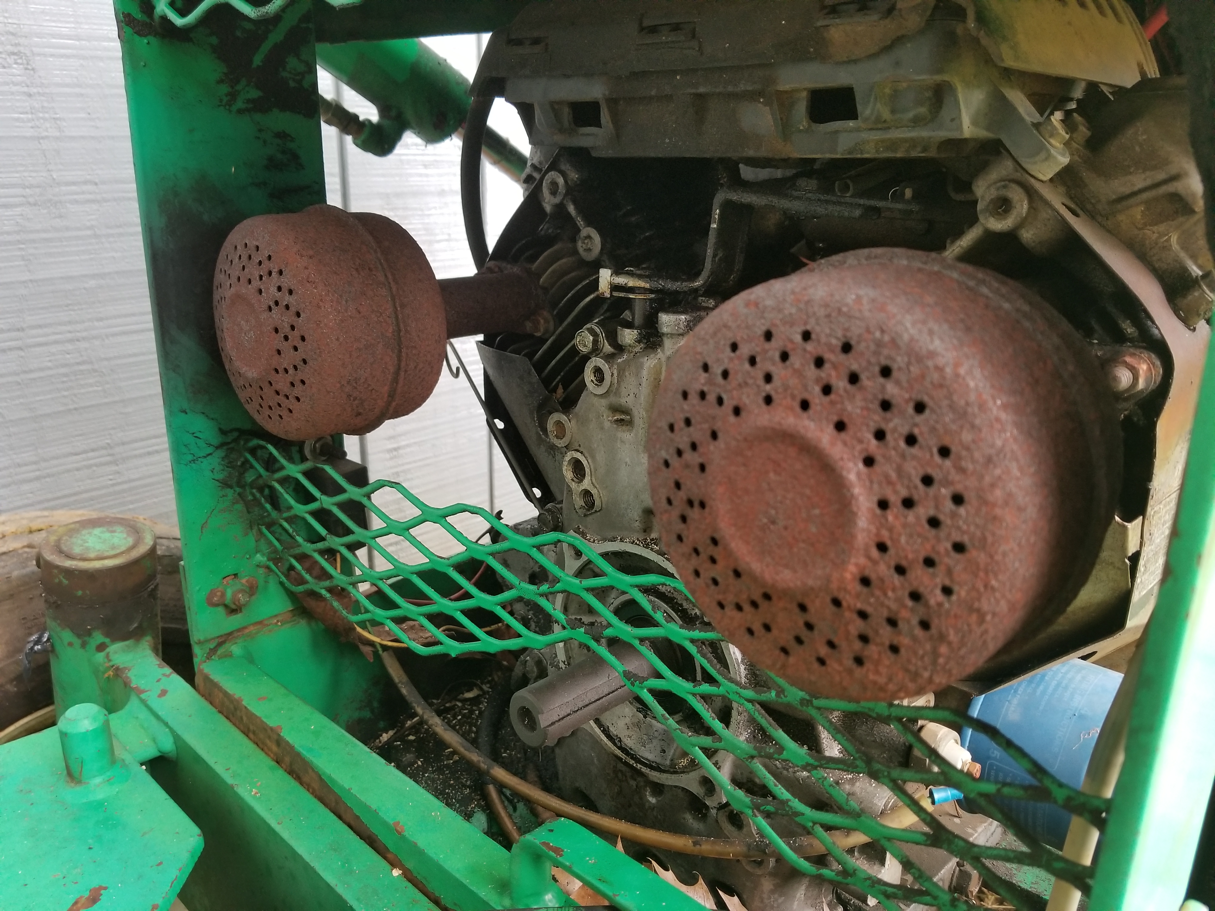

I had the same problem as you. I happened across this thread while looking for something else, and I figured I would offer my solution in case you have not worked it out already (I know this is thread is many months old, but i used earmuffs on my terramite for over a year until I came up with this). I do have a welder and did the modification myself. But you can prep everything yourself and take it to a local welder for just a minimum charge I am sure. I purchased 2 generic salt shaker style mufflers like these: (cant post a link yet) ARNOLD M-111 and a 1" X 6" black iron pipe nipple. I cut the nipple in half, so I had two 3 inch pieces with threads on one end. then took the existing muffler off and cut the two flanges off for reuse. Weld each flange to a Half nipple and thread the muffler on. Because there is no clocking or special alignment these could be welded by anyone anywhere.

You may find this muffler setup is a bit louder than factory but way better then that rotted out thing that is on there. I was worried about a loss of power from the scavenging provided in a single muffler, but I really haven't noticed a difference.
Link to the muffler: Arnold Replacement Muffler, M-111 at Tractor Supply Co.
I did mine 5 or 6 years ago and it is still working fine.
