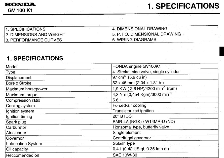

i have a 13 year old honda push mower and it has a HR 173 engine on it
i was woundering if anyone knows this engines (hp) and also the tork of the engine

HaHa you guys kill me! The mower model is an HR173, it has a Honda GV100 engine. If you google it you'll find the specs, here are some below.
