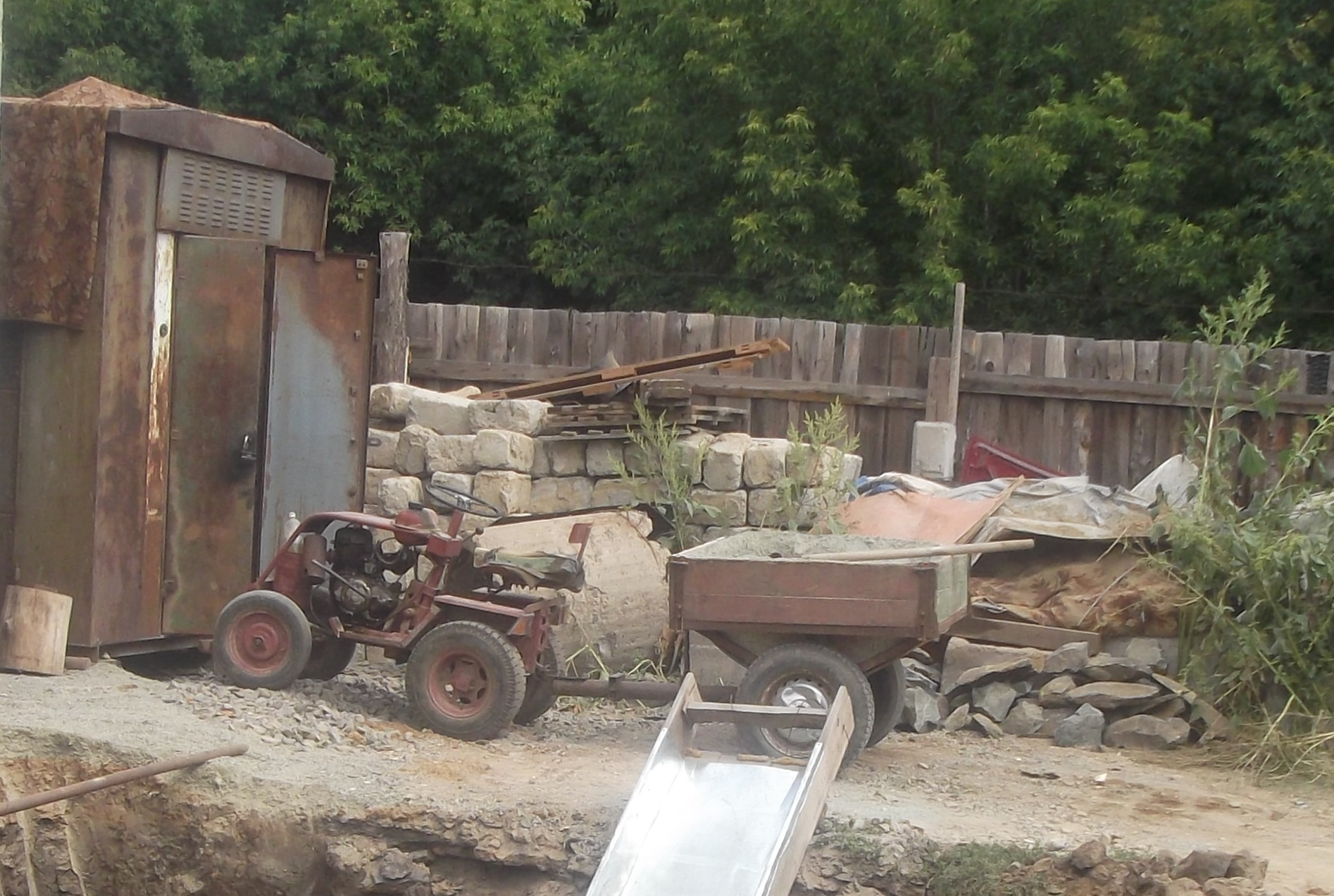

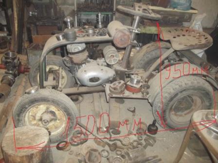

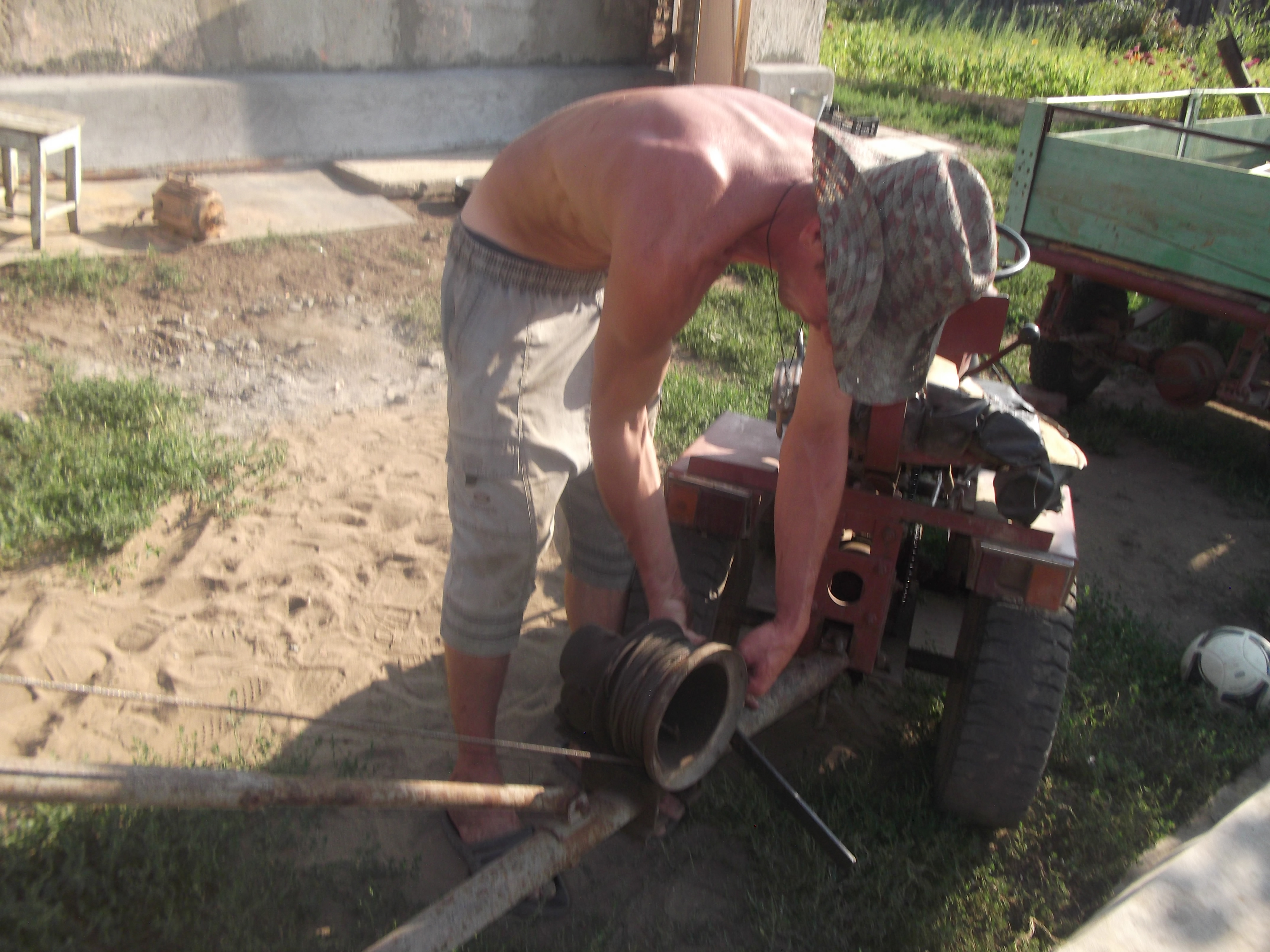

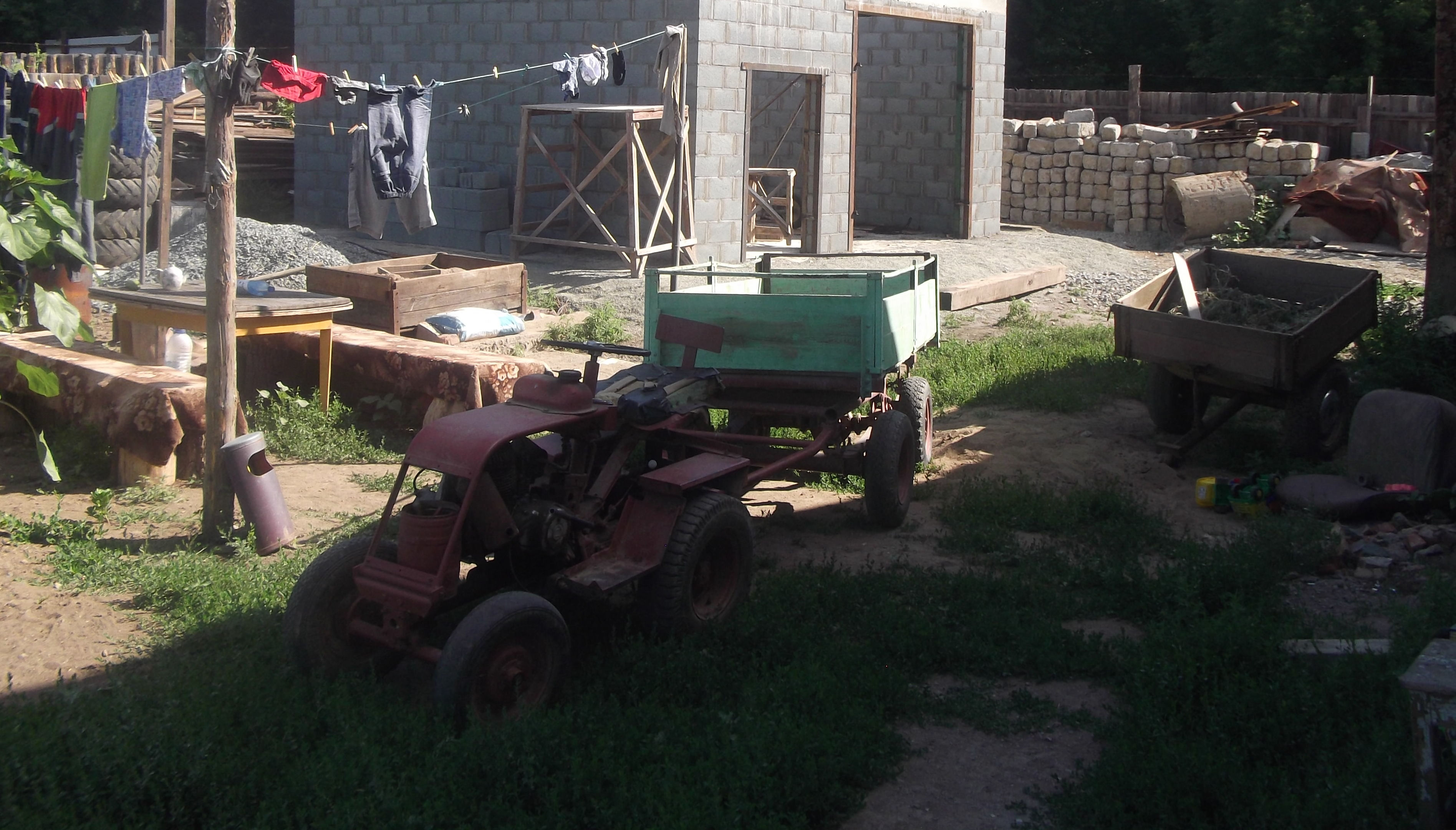

For myself, I do a little different technique: cultivators, ATVs, tractors, cranes, trailers ......... I do not shop. On my site you can see the video.
Quietly I am going to tell you about the tractor.
tractor Weight 110 kg. with the motor.

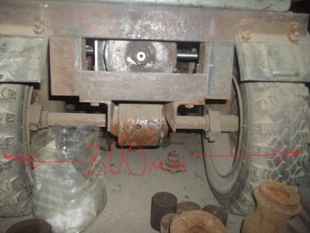

The motor weighs 36 kg. power of 13 hp two-stroke speed of 40 km / h, four forward and four reverse gears, pulls the trailer load of 1200 kg. During the season I pass up to 3000 km. for 20 years but have never broke sending. I refit only changing the engine cylinder and piston.

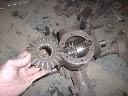

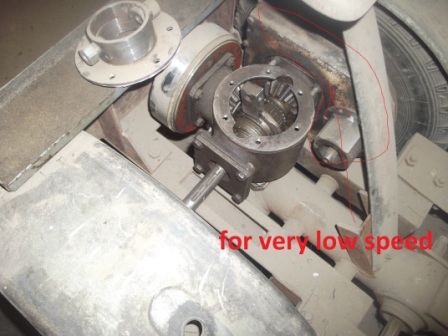

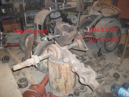

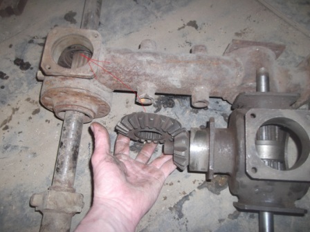

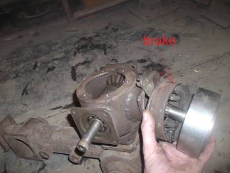

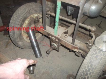

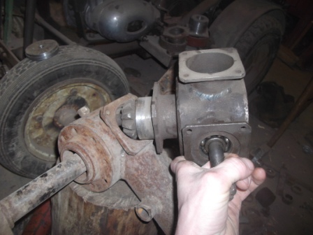

Main gear bevel gears. Apply on the truck with the differential. Semiaxial diameter of 120 mm. satellite and 70 mm in diameter. Peredachnaya 1.8. Reverse gear unit is the same 1.8. Gearbox and clutch in the motor. From the engine to the gear chain.

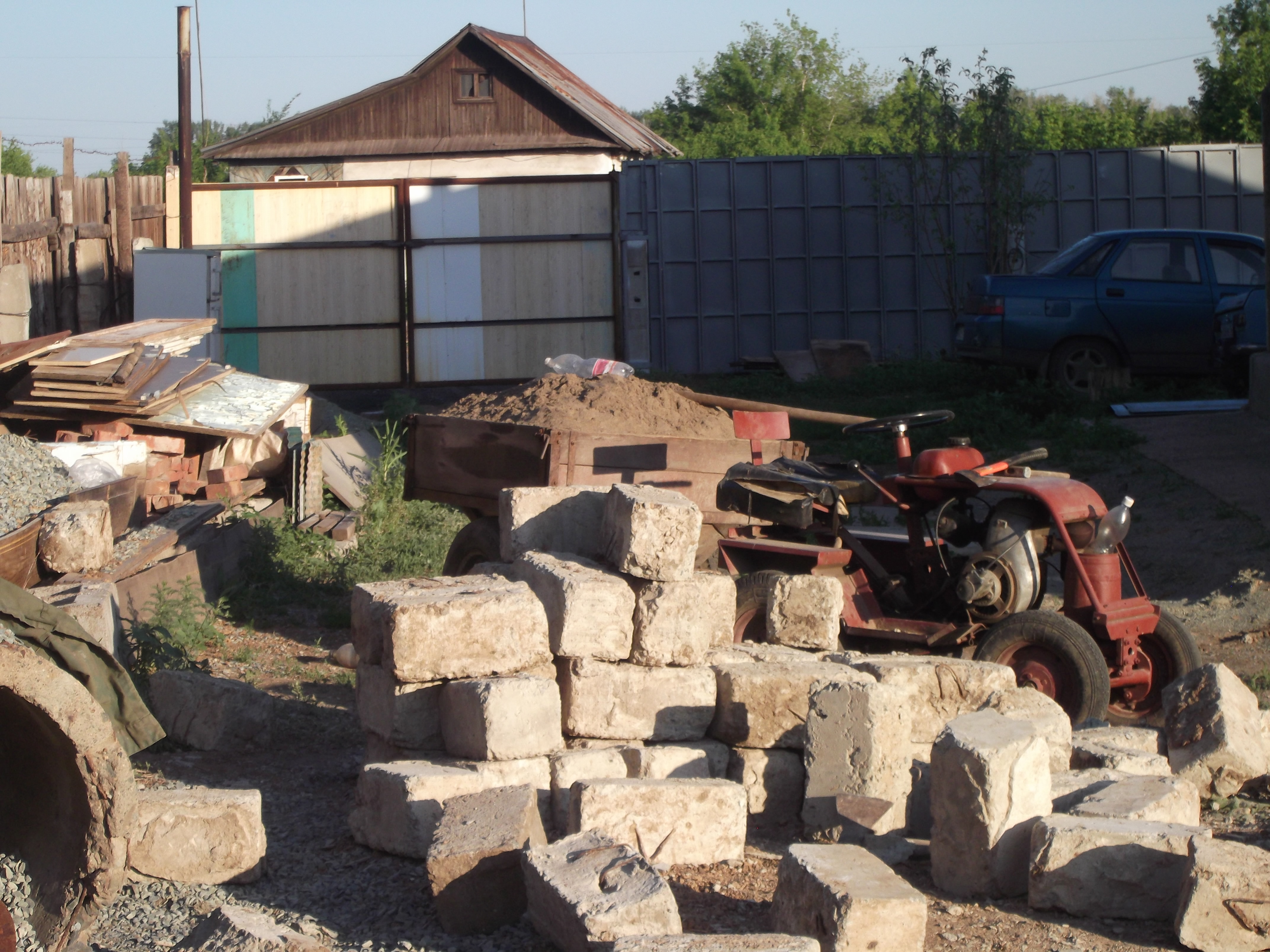

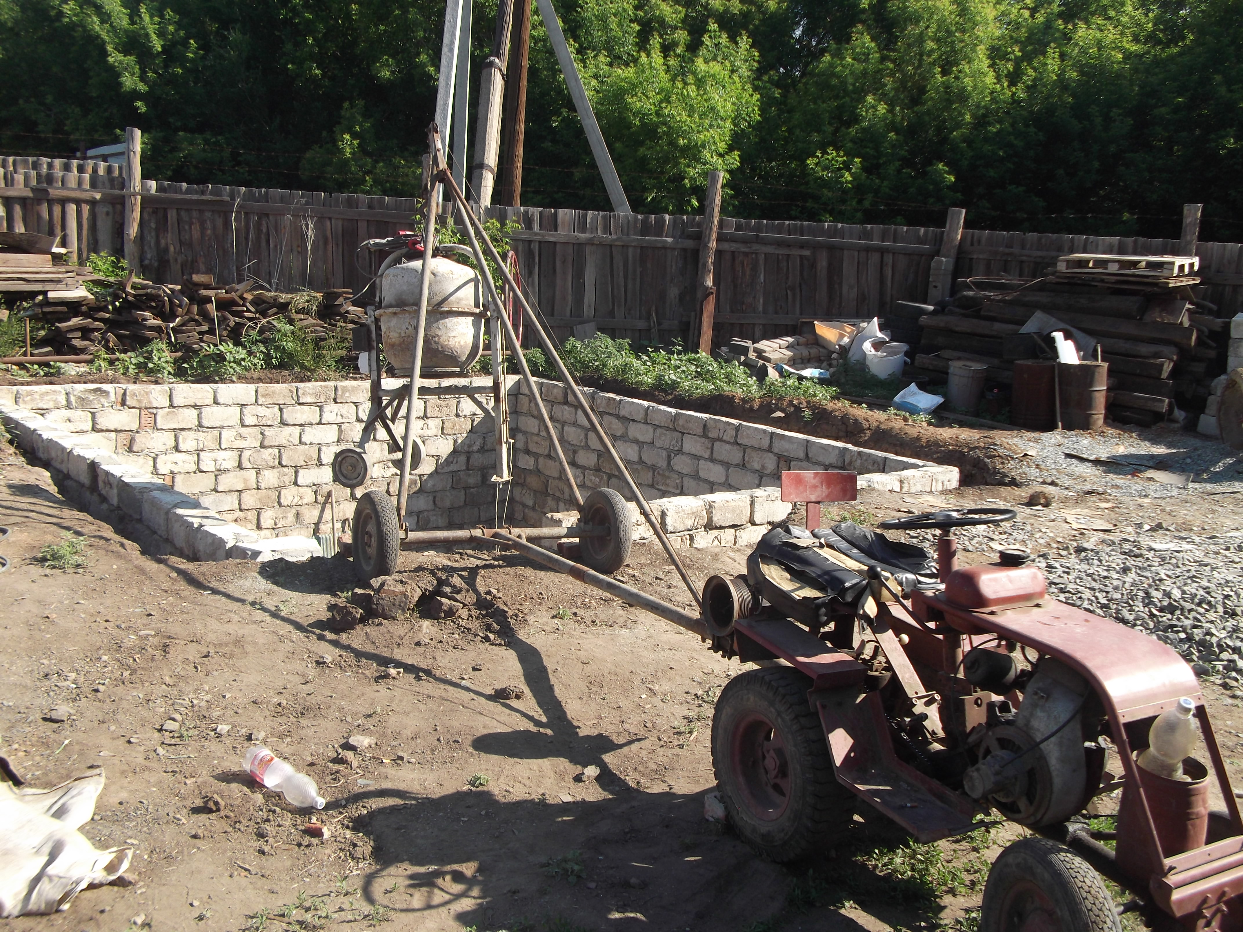

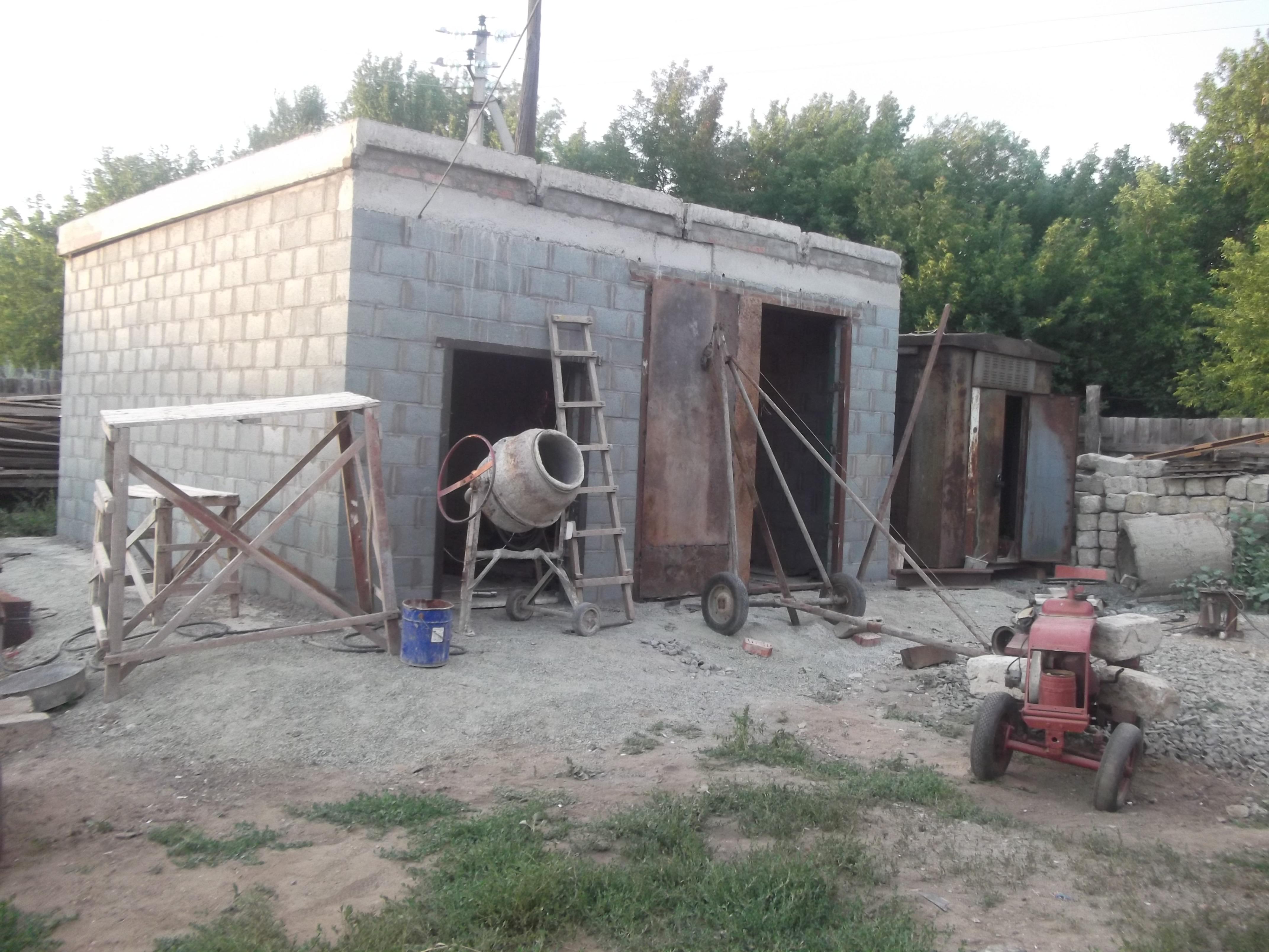

I'll show a photo of his tractor, he helps me a lot. I am building a house, garage and more. The box trailer 1200 kg. and I'm taking. This tractor, I go in the summer. It is small and comfortable with good handling. In the winter or in the rain, I ride on a different tractor.
What is not clear, and interesting question. I do not speak in English. I will try to answer you.
I will try soon to show videos and photos tractor design mechanism.

Powerful tractor you've made. You will get a lot of use from it!

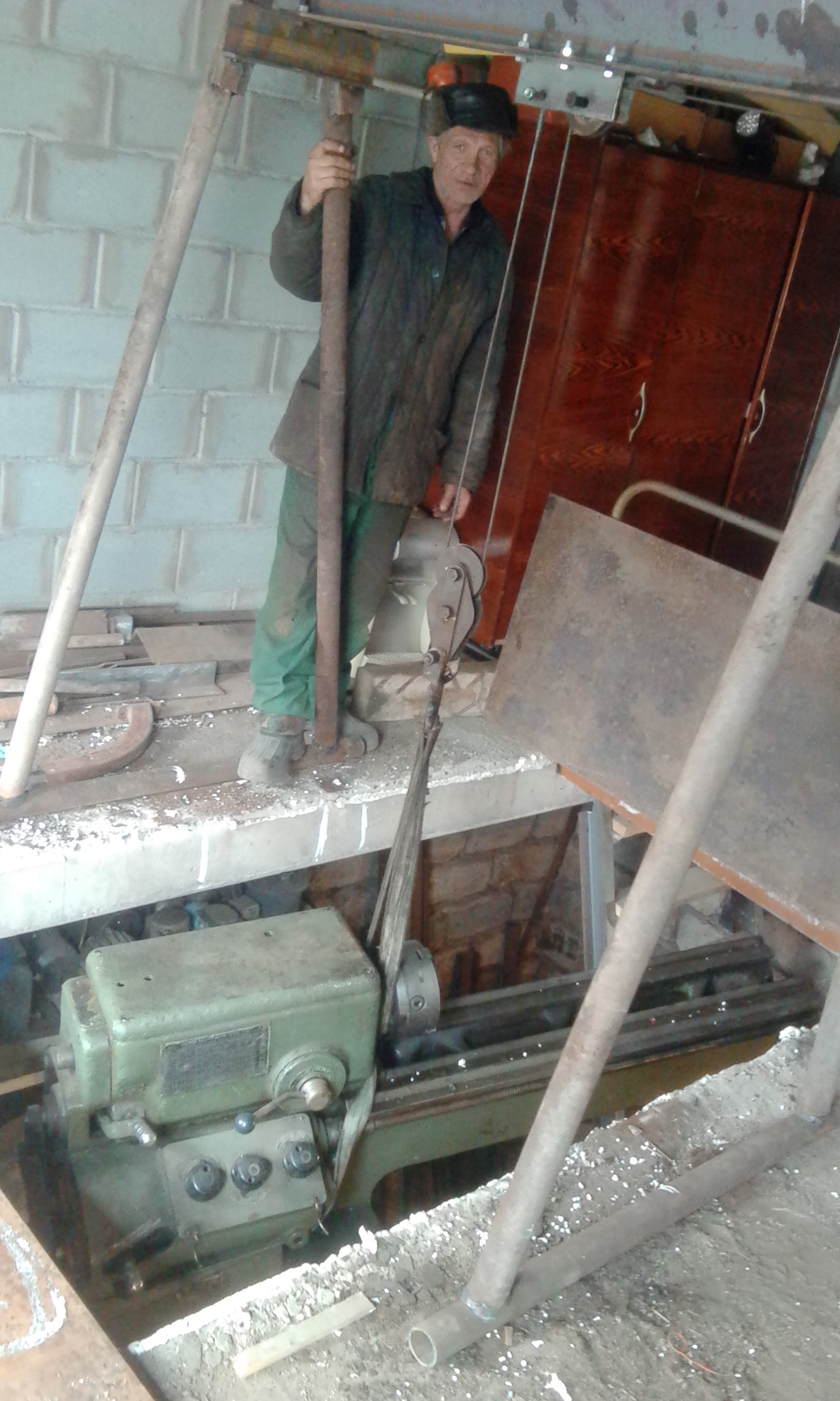

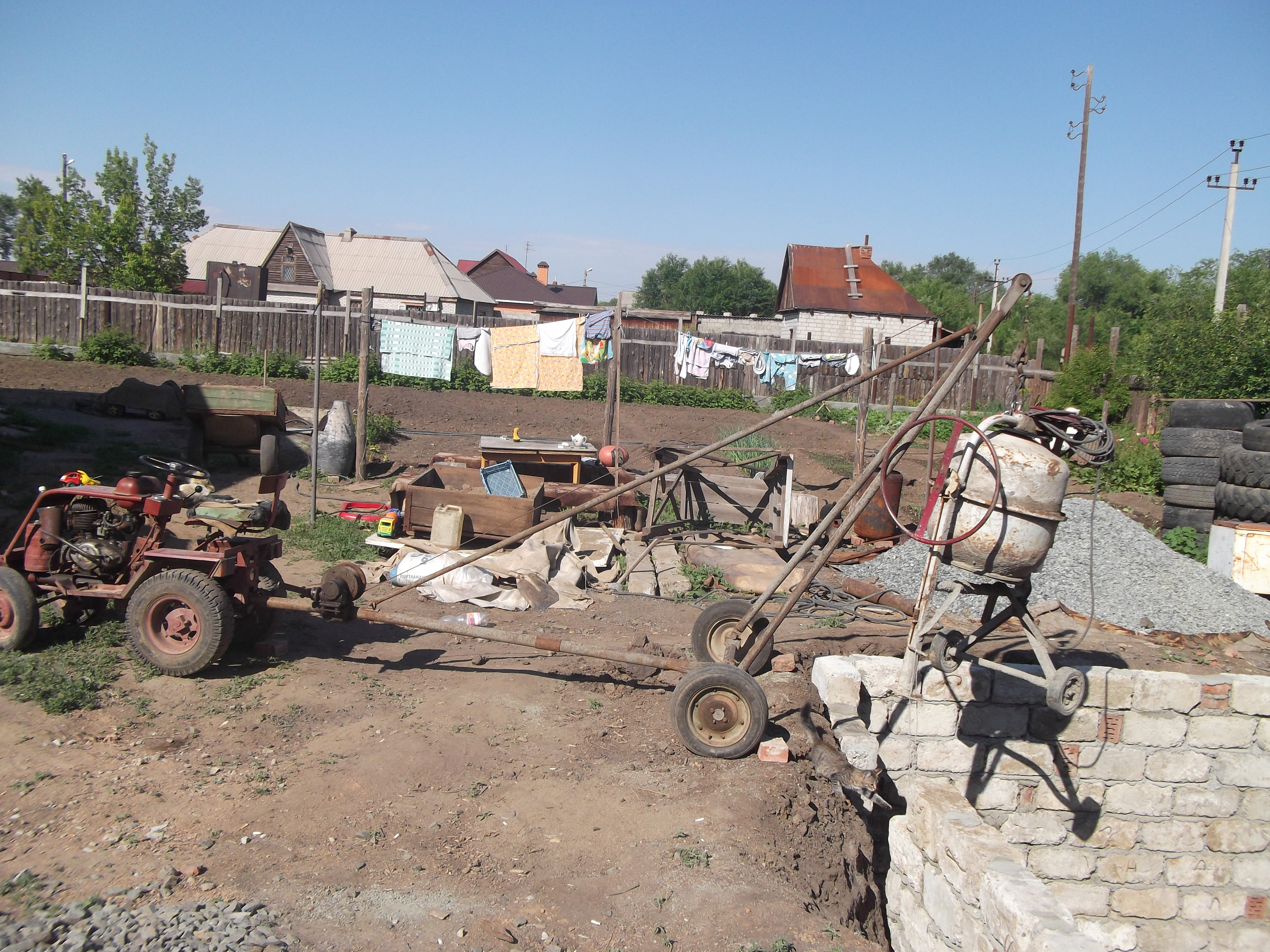

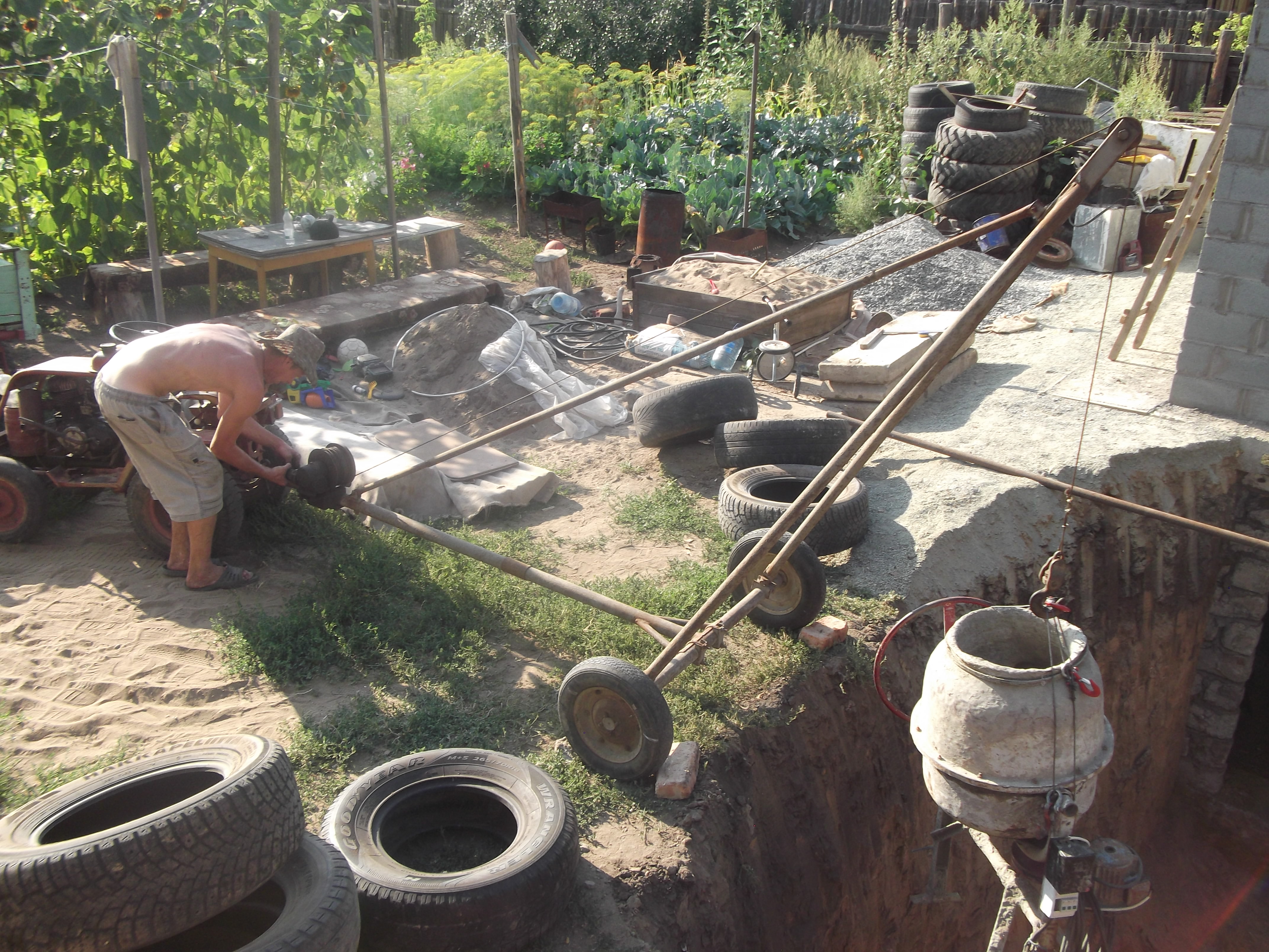

Denis:

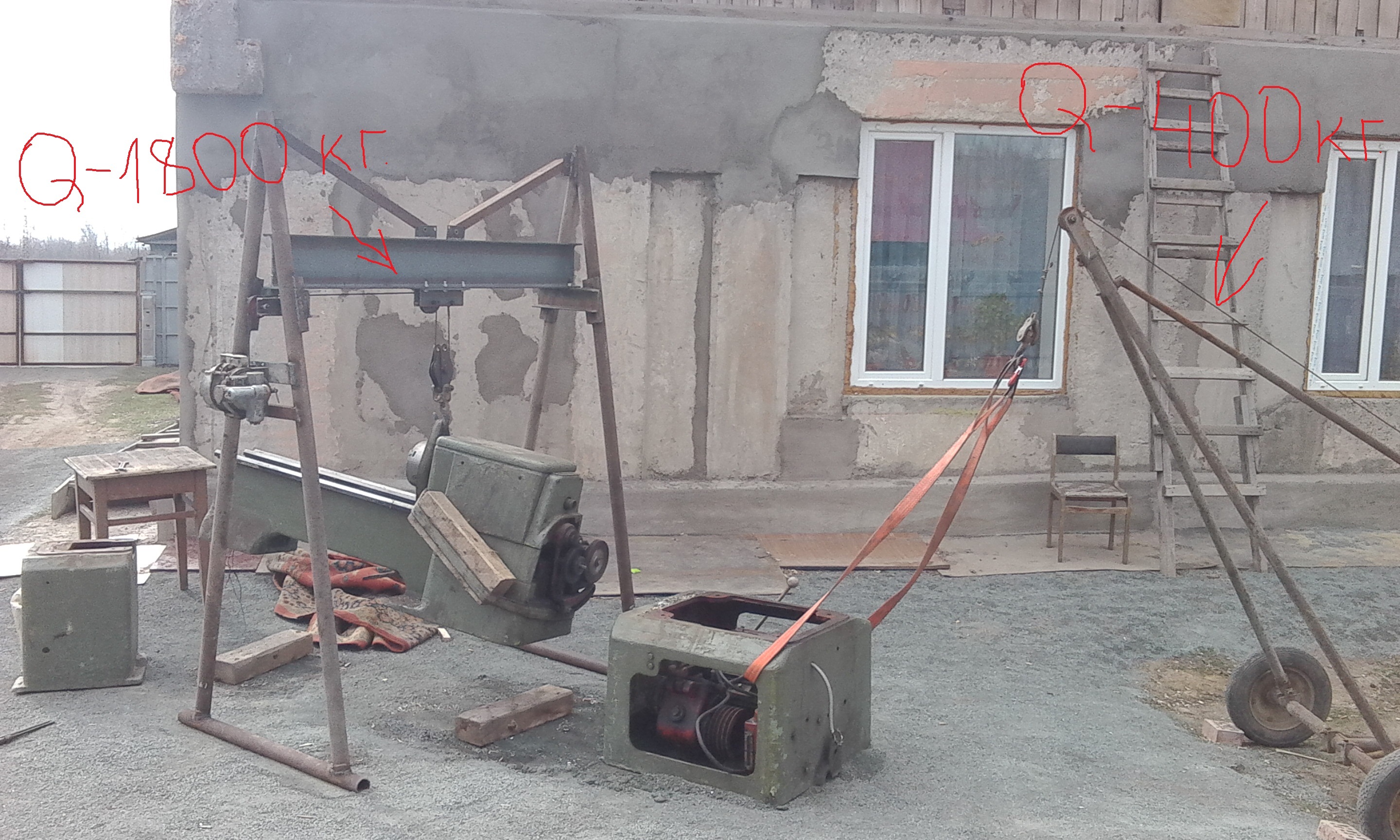

That is an impressive creation. The engine does not seem to be straining very much, even to pull two cars. Does it have oil injection or do you mix the oil with the gas?

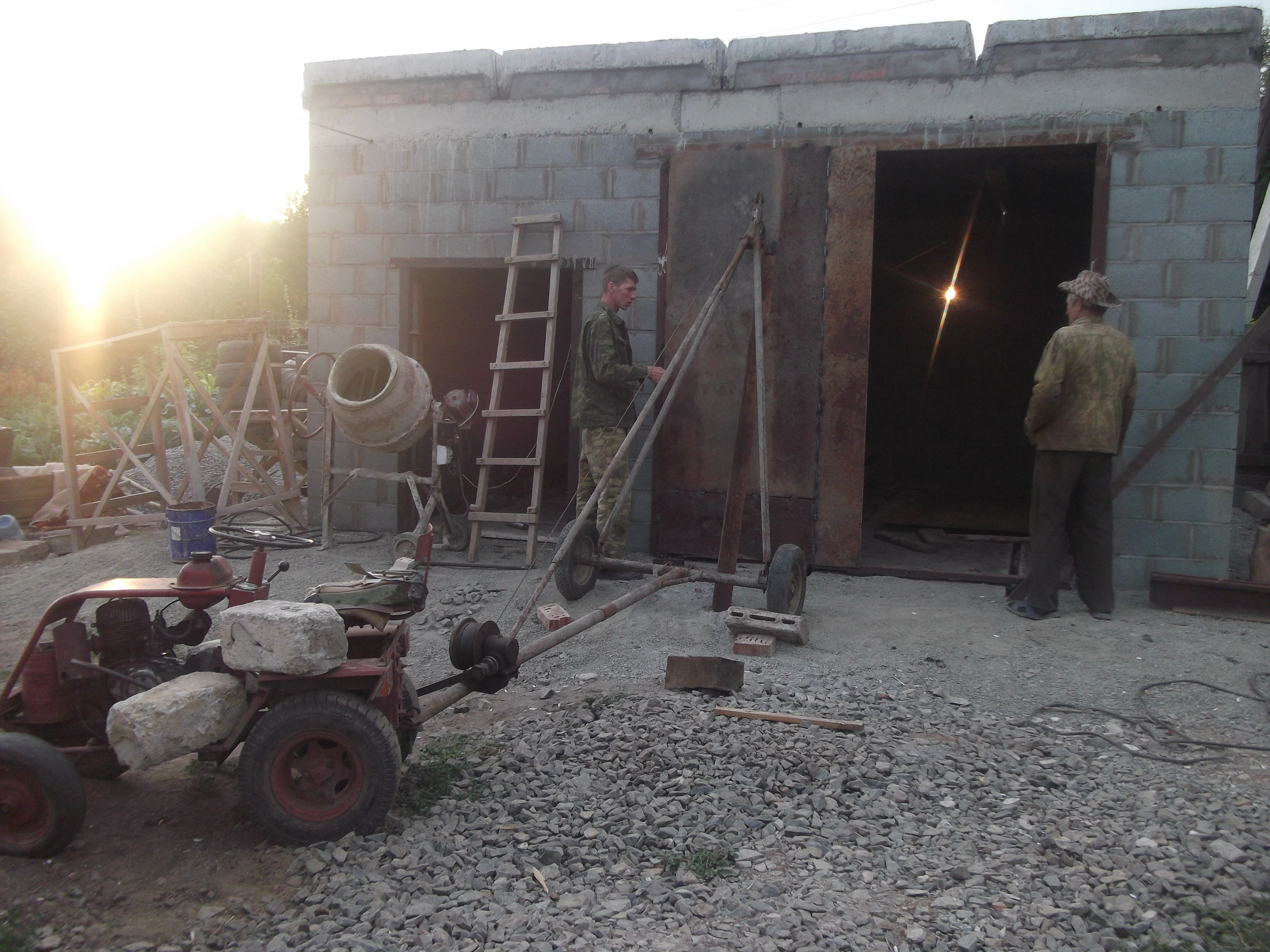

The mobile crane is interesting. I can't tell how the winch is powered. Is it powered from the tractor?
Thanks for sharing your work.
Chuck Ford
   / Homemade tractor Velikanova
Engine 2-stroke. The oil should be mixed with gasoline. Hand Winch. The tractor is not necessary.
For heavier weight, I use another crane.

Nice. Looks like you are getting a lot of use out of it, but even better, having a lot of fun too!!!! Thanks for sharing, it's always interesting to see how people live and do things all over the world.
