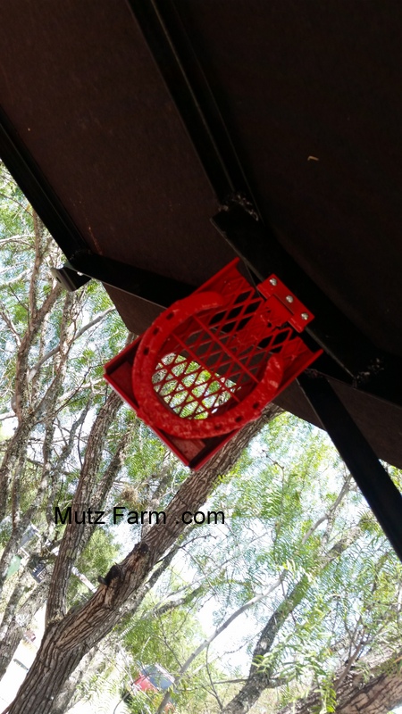

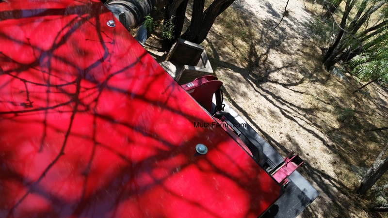

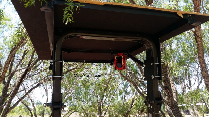

Couldnt see paying for one of those high dollar tractor canopy when we can just build one ourselves. O yea and the wife wanted something to hold her cell phone while she was on the tractor.We also installed brackets for future lights on each corner of the canopy. We figure it cost us less than a $150 to build this canopy. Thats better than a $450 and ours even has brackets in it for when we add lights later. We also put a piece of fiber board / asphalt sheathing that makes it bout 10 degrees cooler under it.
Before we was always baking in the sun.
Got a piece of pretty Mahindra red aluminium.
Added a red horseshoe cell phone holder.
Brackets on all 4 corners for future lights.
Fiber board / asphalt sheathing insulation.
All this be an easy $450 at the dealer I believe.

I instantly see a shattered,cracked, or scratched screen on a phone. Maybe some foam put in the holder?? Or something to protect a phone

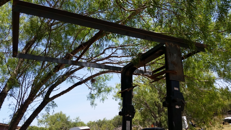

That looks nice. I like the back overhang. I also like the attachment. What is the frame made from?
Our phones are actually Samsung Galaxy S5 active with a pelican case and tempered glass on the screen. We work hard and play hard. I will say the phone actually rides really nice in there and we dont worry bout it in there at all. Now before when we carried our phones in our back pockets they would slip out and almost get ran over or when we had cases and it didnt latch right or get hung on something and come off was also an issue.
Thanx. The longer part of the frame, the left and right sides that run parallel are 2 X 2 X 1/8 angle. The front and back cross pieces are 1.5 X 1.5 X 1/8 angle. The middle cross and angle braces are .75 X .75 X 1/8. The mounting steel to the ROPS is 6" X 3/16 thick pieces of plate that I believe was cut at 12" on the outside pieces.
Hope this helps.

I used a very thin piece of aluminium that was already red and over priced, but did it for the cosmetic part. I put a piece of sheathing insulation under the top which a lot of canopy you buy have. I got it from the local box store. It was about $12 for a 4x8 sheet. Well worth it. Probably 15 degrees cooler under it in the summer. Of course from the pictures you can see the one I built was stout.
