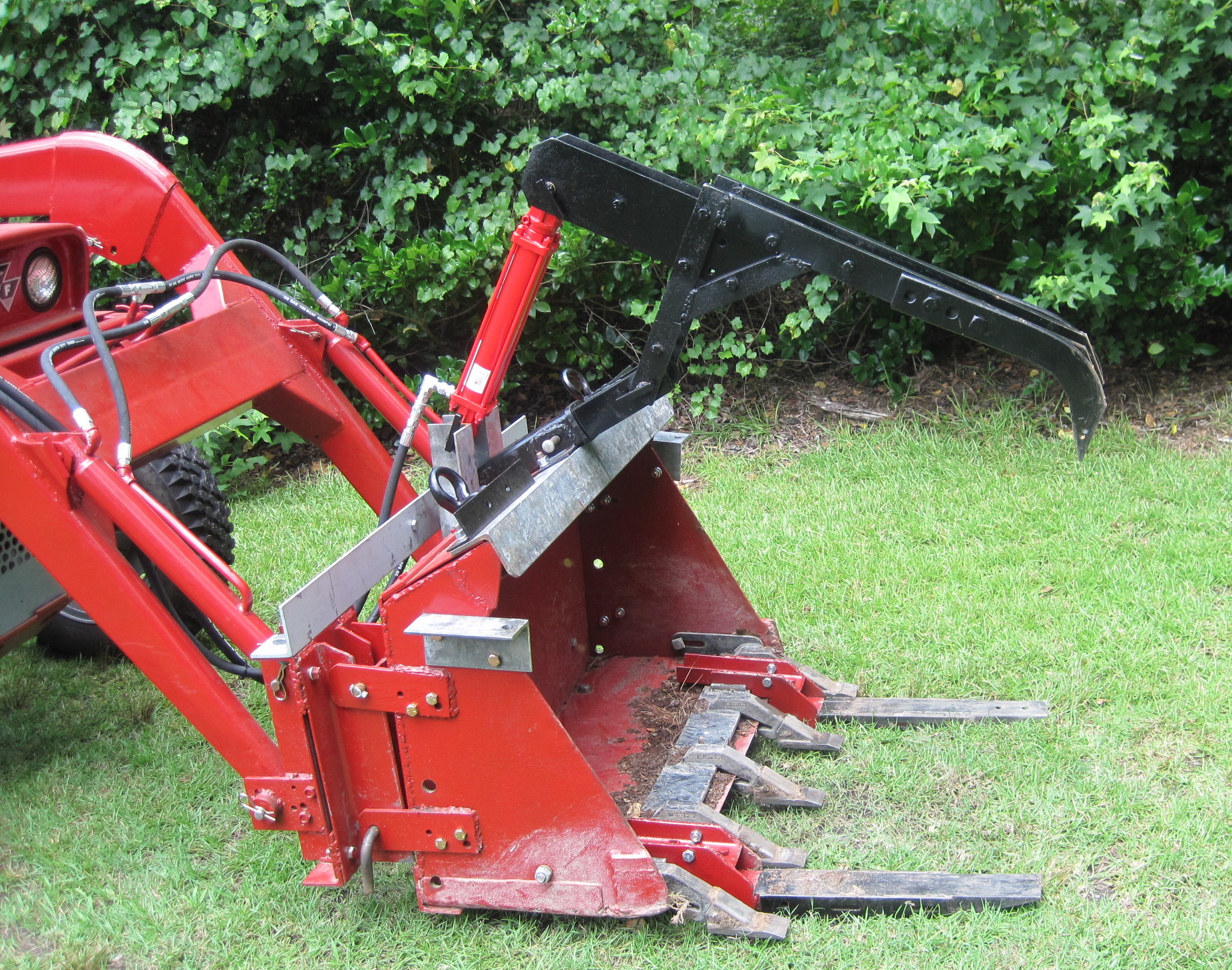

Have an old MF 65 with an FEL. Built a set of forks for it a couple years ago. Been trying to figure out how I can a attach a thumb to the forks to move logs, without adding additional cylinders. Was on youtube the other day and came across a video of a fellow who built exactly what I have been thinking about.
If you copy and paste the following, it will take you to the video on youtube, called #24 Homemade Log Grapple:
#24 Homemade Log Grapple - YouTube
Has anyone ever built such a unit? I'm interested in angles, dimensions, locations of pins, etc. A set of plans would be really helpful.
As always, thanks for the help.

I just saw that and it is ingenious! I think you're going to have to do a little trial and error. Maybe use some wood to mock things up. Does your bucket have one or two cylinders, his works because he has one, I think two could be utilized but with two thumbs. Keep us posted.

My FEL is a davis 99 loader with one bucket cylinder. Thats why this will work so well.

Messaged the gentleman and he is drawing up plans for me. Will keep you posted on progress and pics

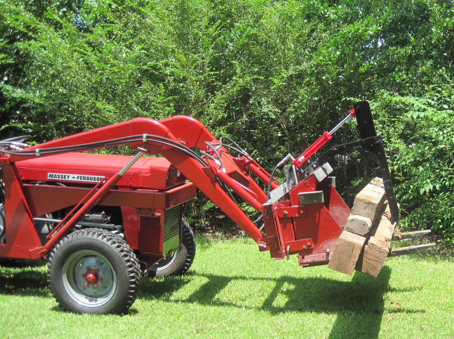

Here is my homemade simple grapple using a 2" receiver system. It is a permanent resident of the bucket, but it can easily be taken out with couple of pins. It has been later modified with a longer cylinder later to accommodate a higher opening.
