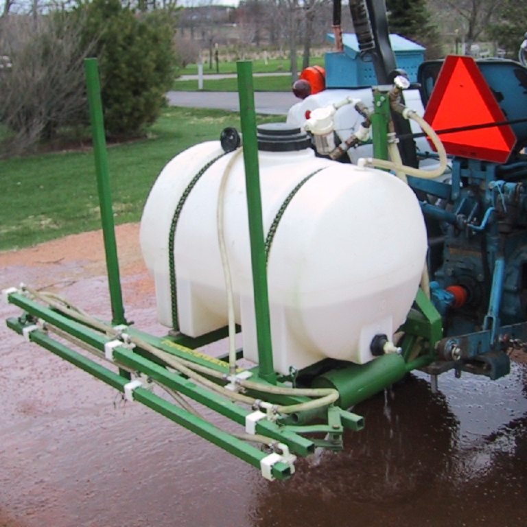

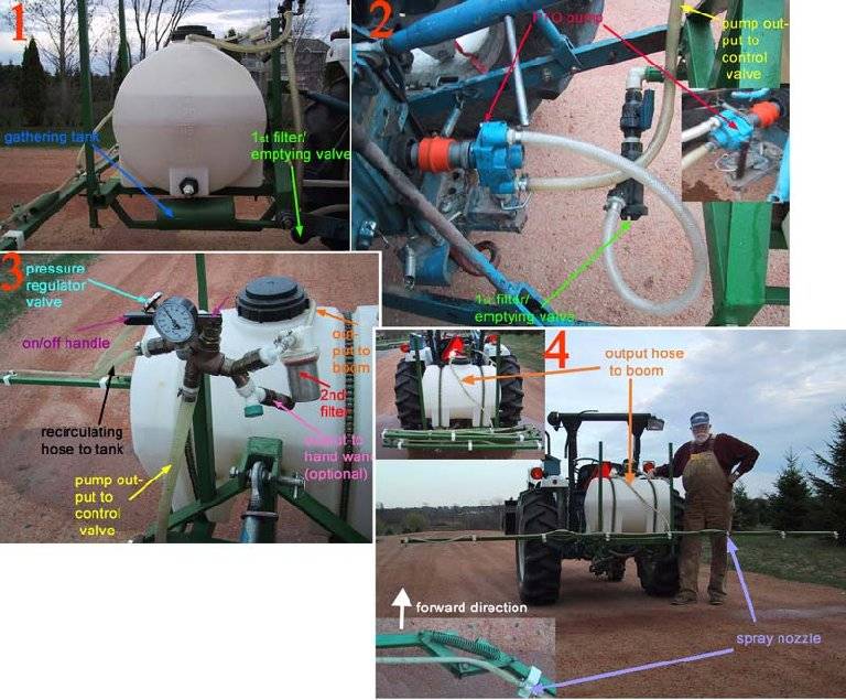

My homemade sprayer. 35 gallon capacity, sprays 14' swath or less, 11.5 gallons per acre or a hand wand can be used.
1)The green tank under the 35 gal polyethylene is a "gathering tank" made from a fire extingrusor so I don't leave 2-3 gallons in the larger tank. The black hex with silver center at the side bottom of thr 35 gal tank is a plug to the original opening. I cut a hole in the very bottom so it go into the "gathering tank" to totally drain the larger tank
2) This shows the hose from the bottom of the tank going through the first filter and drain, then to the PTO pump and out the pump to the pressure and on/off valve. The insert shows the PTO pump with a metal bar that hits the drawbar tongue so it doesn't rotate.
3) This shows the pressure adjustment valve, the on/off lever, pressure gage and 2 d filter. The hook-up for the hand wand is right next the 2 d filter. When the valve is off the water/herbicide is recirculated which keeps things mixed up, when the valve is opened the herbicide is diverted to the nozzles out the back.
4) This shows the boom folded and extended and the hinge design along with yours truely. To spray off to the side or just the center I pinch the appropiate hose with a vise-grip. The 35 gal tank is tilted to the right so the "gathernig tank" gets all the herbicide.
The gathering tank rusts and I need the 2 filters. The nozzles clog easily. If I did it over the gathering tank would be plastic or stainless steel. As it is I park oil in the tank between uses.
The boom can be adjusted up those vertical tubes on the back.
I use 2 to 3 quarts of Round-Up (the 42 % stuff) in the 35 gallons and spray 3 acres early AM ( no wind !) and plant seedlings several hours later

Another photo. You can see the 3/8" wood slat under the left foot of the tank so it tilts toward the "gathering tank"

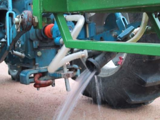

4 th photo How you empty (flush) tank via the first filter holder.

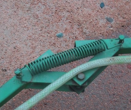

boom hinge

Nice work! That looks like it will give you some great service. You've included some great extras in this rig.

I'm having a tough time focusing my (tired) eyes this morning, but I think that I can make out your sprayers nozzle set-up. I would make but one suggestion. Tee-Jet sells a "10 psi check valve nozzle body". It will stop flow through the valve body when spray pressure drops below the 10 psi level. That will prevent your sprayers piping from continuing to drain after you shut off the flow. It gives you one more level of control over chemicals getting someplace they don't need to be. These check valve nozzle bodies are available through any Tee-Jet distributor.
Looks like you've done your homework! Nice looking sprayer Santa! /forums/images/graemlins/smirk.gif /forums/images/graemlins/wink.gif /forums/images/graemlins/crazy.gif /forums/images/graemlins/grin.gif
