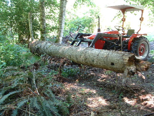

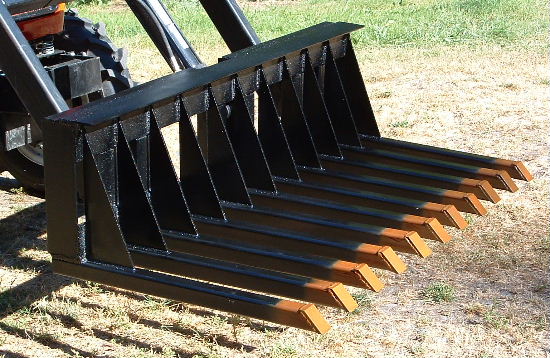

I think you may experience a lot of twisting in your design. IE: I am assuming you have a 4 cylinder FEL so with the arms attached at the bottom near the outside edges and the dump/rollback rams attached near the top above the arms, when you run the bucket into the ground and apply a load out at the cutting edge, the top edge up between the dump rams is going to want to bend along it's length. From your attached pic, I am assuming you are using a 3X3X1/4 piece of angle across the top also?. That may not be strong enough to resist this bending moment and the middle of the tines and cutting edge up forward will sag(tines will twist clockwise in your attached picture). I also didn't read anything in your initial post about gussetts re-enforcing the rods. I think if they are unsupported this will also allow the cutting edge to sag under load as they will just bend. I also believe the bottom angle may bow backward as the middle of the cutting blade runs into immovable objects and pushes directly back on the rods/tines.
I assembled a 60" trash bucket a few weeks ago(see attached pic) and ran into some bending/twisting. I used 4X4X1/4 angle top and bottom with six 4X4X1/4 uprights for the loader attach framework and 4X1/4 side plates. The gussetts that support the tines are 1/4 plate 6" at the base and 15" tall. Tines are 2X2X1/4 box 30" long(20" useable length). I have a 3 cylinder loader so what I saw were the outer tines drooping under load as the top rail bowed along it's length under load. The way I placed the top angle, corner forward, I had to notch it 2" to clear the center mounted dump cylinder. This notch added to the problem but I believe it would still have bent under load to some extent. In hind site, I should have reversed this piece of angle so it was corner aft and then I would not have had to reduce it's strength in this plane by notching it. I added a additional piece of 4X1/4 plate along the top with a 2" overlap(6" total top plate width with 4" in the middle where the cylinder notch is located) to resist this bending. This has removed almost all the flex along the top rail. but even with this reenforcement, it still flexes to some extent under load.
If I were attempting a project such as yours, I would skip the rod entirely as it is not adding much strength particularly when bent, but it is adding a lot of weight. I would have plate waterjet or laser cut into the desired shape for all the tines(similar to your pictured sidewalls but not as deep). To the bottom edge of these plate tines I would weld strap material for side to side re-enforcement to create an inverted "T" profile. This would be fairly easy to create with a torch and hammer. Tack weld the strap to the tine at one end and apply heat along the strap and bend it to the same profile as the tine, welding as you go along. I would then weld these tines to a very boxed/triangulated structure with large top/bottom plates that would resist the bending loads I mentioned above. I think if you re-calculate with tines 1/2 the area of your sidewalls or less and subtract the weight of the 3/4" rod, your weight would not be that much greater(3/4 rod weighs 1.5LB/FT). You will be heavier but the structure will be significantly more ridgid
These things are expensive for a reason, the good ones have a lot of man hours involved in design and fabrication. Good Luck.

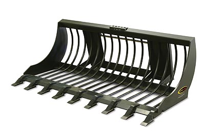

RonMar, Thanks for your input. I think you are absolutely correct that some twisting and flexing is to be expected. Hopefully it will flex back. I don't really plan on using this bucket for any hard digging though. Instead I'll use my regular bucket for the aggressive digging and piling and the rod bucket for sifting and handling brush.
I have attached a picture from a skidsteer bucket manufacturers site that I, umm, borrowed some ideas from. I basically just scaled it way down for my use. I thought about building something along the line of what you are describing, similar to the Virnig Mfg. rock bucket, but opted for the rods. I guess I wanted to keep as much as the work "in house" as possible. /forums/images/graemlins/grin.gif Not to mention almost all of the material I already have laying around.
I am also hoping to pick up some more torsion control when I add my brackets since I have to add another hunk of either angle or channel in the back to attach them to to give me the proper angle. I guess I'll find out soon enough. /forums/images/graemlins/grin.gif

A chunk of rectangular box tube along the top like the one in the picture you attached would be a good idea, that would help a lot with the the bending/twisting. I had contemplated the same thing initially for my fork bucket as that is the way my loader material bucket is constructed but I was trying to keep the top as open as possible to accomidate the brush/logs/stumps I planned to move which it has been performing fantastic on. It has also been pretty good at picking up rocks(has about 3 1/2" between tines) as I have been collecting debris for burn piles on my land. It is hard to judge scale in that picture but the side plates look to be quite thick. Look forward to seeing your version.
