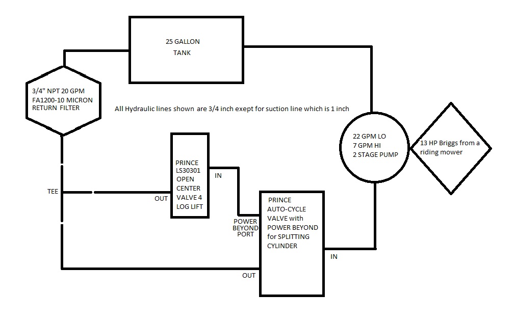

I'm going to attempt to attach a diagram to this post, if it is successful please comment on it pertaining to: it won't work, will work, this should be changed, your forgetting about this, etc.
I left the cylinders out for now.

That should work . Everything looks correct.
   / Homemade Log Splitter Hydraulic Diagram #3
you might consider a filter base that includes a filter bypass over a preset pressure. that way you dont blow up the filter on those 0 deg F mornings when you want to go out and split some wood and that 30wt oil is the consistiancy of molasis.
