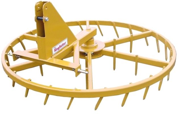

I have an old moldboard plow that works well w/ my machine. I would love to own a disc harrow, but cannot afford at this time. I need something to beakup and smooth the dirt after I plow.
I was thinking of building something out of a bunch of scrap metal I have. I am thinking a 4' x 4' sqaure, that attaches to the 3 pt arms with a whole bunch of spkies (I cut solid steel rods to make) scattered w/in the sqaure attached to angel irons. Something like the attached pic King Kutter makes, but sqaure.

That's not going to do what you want. The pictured harrow spins and is for leveling out ground, but not breaking up plowed dirt. Attend some local farm auctions and you can likely pick up a used disc for a fraction of a new one, and you'll have a piece of equipment that does what you need. Even a regular spike tooth harrow (basically what you're describing you want to build) will not break up plowed ground in an efficient manner.

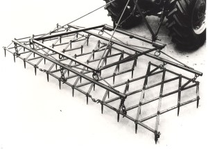

You could make a section of Diamond Harrow and buy the teeth. Rig it up so the three point lifts it which isn't hard to do and like you planned.:D
In some areas of the agricultural world these were very common and used to smooth fields and also followed behind seed drills. :D

To me, that’s still a spike tooth harrow and is either used after disking or dragged behind the disk. I’ve never tried mine on plowed dirt, but I can’t imagine it would do much more than bounce. I suppose its effectiveness would depend on the type of soil.
   / Homemade Harrow?? #6
They work quite well on cultivated land that has been ploughed. But the land must be under cultivation. They do not work on fresh turned sod .:D
They actually pull quite hard and do not bounce.:D
