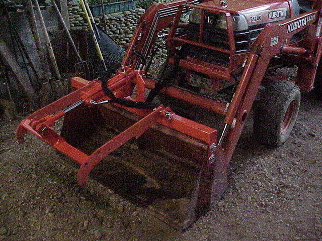

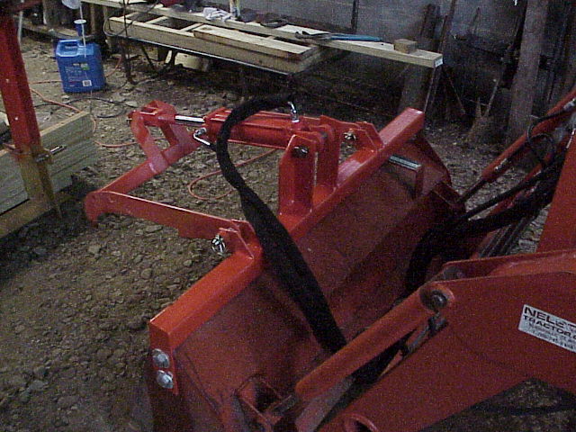

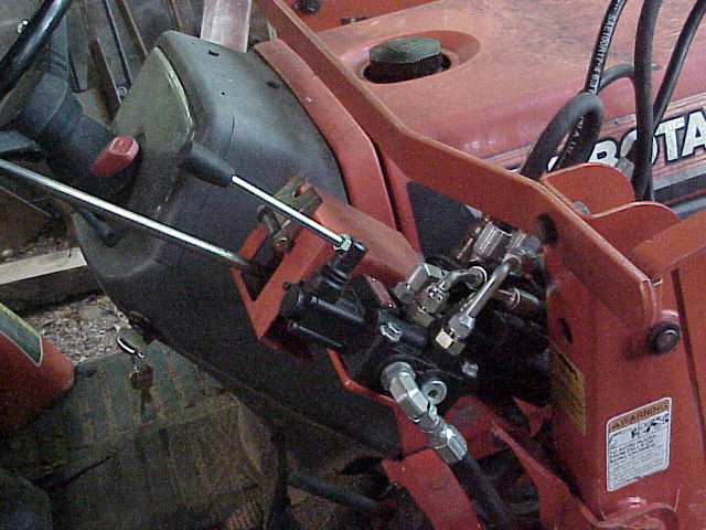

I posted this link to more pictures in the 'Projects' forums...I have finally finished the project and have done some testing...This is going to be a huge labor saver for me...
There are 3 pages of pictures from a wooden mock-up to completion...
grapple project

What a nice job documenting your project with the photos. (They say photo is worth a thousand words)
However I didn't catch any documentation on the cylinder that you used and how close to the buckets cutting edge do the tines get. I am toying with the idea of making one for my next project.

I didn't catch any documentation on the cylinder that you used and how close to the buckets cutting edge do the tines get...
I used the wooden mock-up and two pieces of PVC (one fits inside the other) to emulate a cylinder) and determined I needed an 8" stroke for the configuration I was setting up...I got the cylinder from Northern Tools for $99
The point of the grapple tines fit *just* inside the cutting edge...but there is really no need for it to close that far...I remove the grapple when I'm doing loader work..
