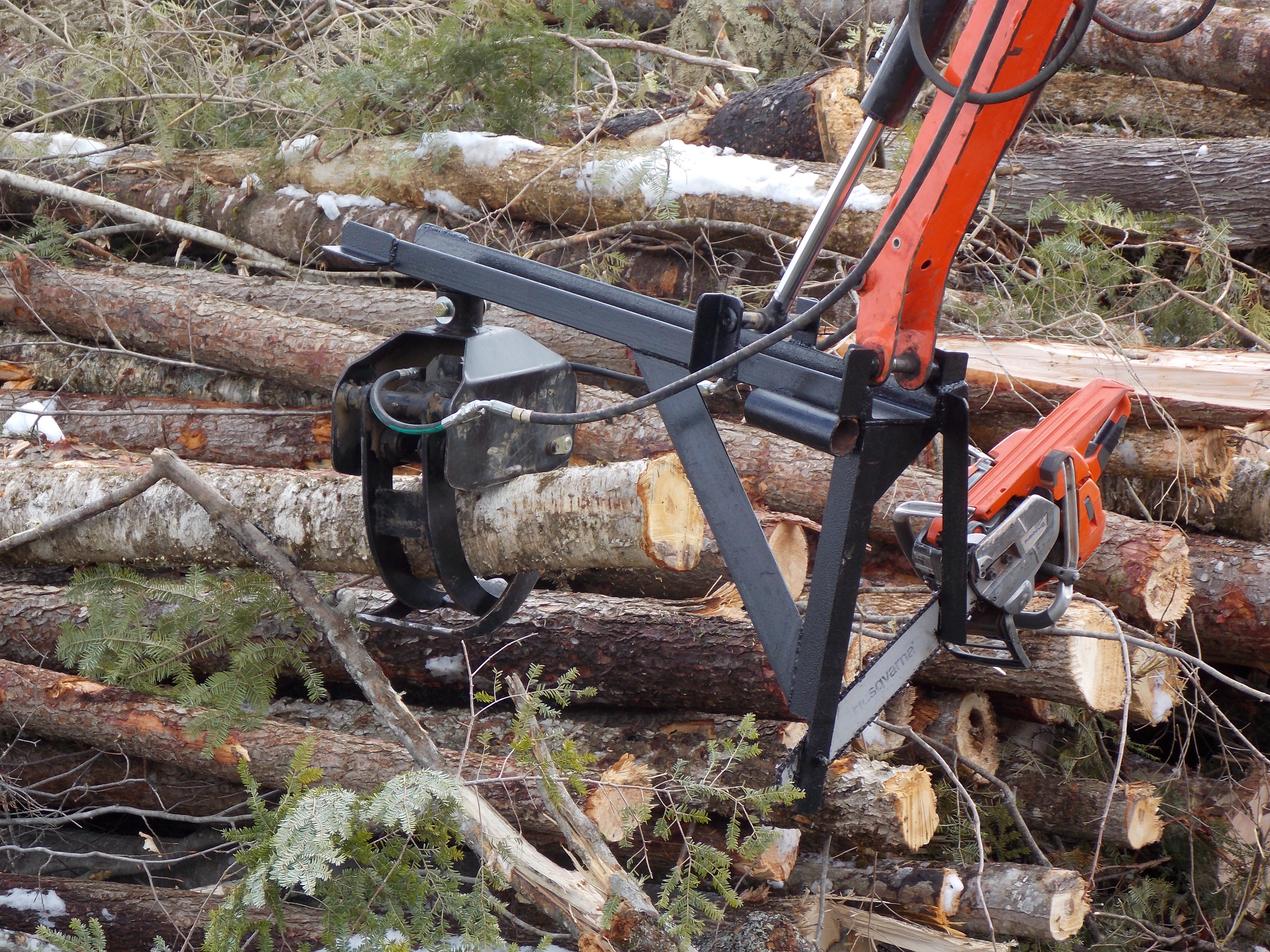

I have been working this past week on a homemade feller-buncher head for my Wallenstein Log Trailer.
I am not 100% there as I had some set-backs. Silly me I fully welded up some mounting brackets without cycling the feller-buncher head through to see if the geometry would work. I thought sure it would, but found out while it withdrew the feller-buncher head all the way back, it would not push it to the horizontal position to allow me to load felled trees onto my log trailer. That is the main purpose.
My first attempt at using a principal to the Perfect Tree Shear also failed in part because in its front-shovel configuration, all the controls are now backwards to me, a guy used to having my controls for a back-hoe configuration. This made it hard to drive the saw through the tree straight, and instead it "raked" up alongside the tree. While I did cut a tree down, it was clear, it was not going to work well.
My short term plan is to go with a chainsaw mounted on my boom, but as my record for smashing chainsaws with bulldozers, skidders and excavators is not great; 2 chainsaw with all three machines. That gets expensive after awhile. Imagine a chainsaw bolted to a boom of a log trailer swinging through a woodlot...that is the definition of crazy. But it would prove how well this feller buncher head will work in the short term.
In the long term, I plan to go with a hot-saw configuration. I am not a big fan of shears, and it just seems easier with a hot-saw. I am thinking using an electric motor instead of hydraulic, but that is yet to be determined. I still have to think that through though fabrication wise.
The overall plan for this feller-buncher head is to cut and place onto my log trailer, saplings. I want to build a firewood chunker so that I can go to fully mechanized firewood. I use a pot bellied stove to head my home so I only need small wood. Why start with big wood only to break it down really small when I can just start with small trees to start with...saplings? I am thinking 4 inches maximum diameter.
Here is a picture of it thus far. I will try to get a better picture of it soon; swung out so its features can be distinguished from that of my log trailer. Naturally I have to get longer hydraulic lines so that my buncher will gather up the trees I cut.

On four inch trees I would think a shear would be much easier to design and build & require much less finesse to operate but I could be 110% wrong.
   / Homemade Feller-Buncher #3
The trouble I see with saws is the rocks but shears are good to 8", and yes swing that boom out from trailer.

Well I keep plodding along with this project for lack of anything else to do. It sill needs a little refinement as the trees kick when they are severed off the stump so I must coral that, but other than that, it is far more productive than I thought. :)
Here are two updated photos.

You actually have that backwards. Here in Maine anyway, a mature forest may only have 250-300 trees to the acre, while open areas may having stocking rates of thousands of saplings to the acre. Good forestry means thinning out the forest, what is known as Pre-commercial thinning, or put another way, cutting wood that has no commercial value...because it is too small. This does not mean cutting every sapling, it means selecting the best ones to leave so they grow faster and healthier...the equivalent of weeding a garden. This feller-buncher head could potentially create a market for such small wood.
The problem with small wood is, it takes a lot of them to add up. That means handling everything via machine to make it viable; in other words, it needs 100% mechanization.
This feller-buncher is part of a two machine process. The feller-buncher to fell, and then load onto my logging trailer, and then a firewood chunker to cut the wood into 4 inch chunks. Because all my stoves and boilers can burn wood as well as coal, my house is poised to handle this type of wood well; called Rebak in foreign language. Do a YouTube Search for that and a host of homemade implements come up. Why cut big trees and work them up into tiny pieces to burn in my pot bellied stove when I can just start with small trees from the beginning? Keeping the margins of my fields will keep me in firewood for many years, not to mention land clearing and pre-commercial thinning.
This will be the next machine that I will build. Onto its own, my feller-buncher head is not that valuables, but coupled with this machine, I can process my firewood without even touching it.
