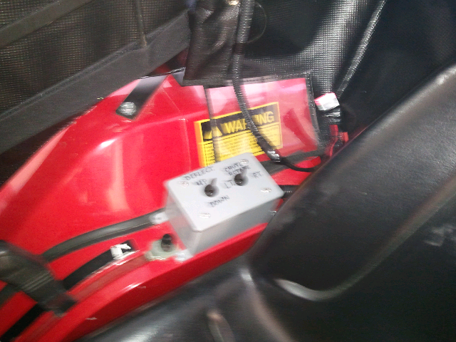

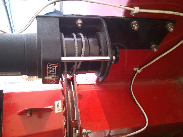

So after two seasons I think I may have just about perfected the ultimate "Low budget, quickly built, reliable, good functioning, snowblower chute rotator and deflector actuator"

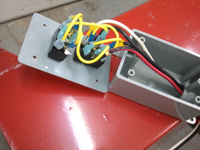

First you buy two cheap 12v ATV winches. It doesn't really matter what brand, if it has a roller fairlead or not, how nice the controller is or isn't. Just two cheap ATV winches. I bought my last one on sale at TSC for $60. You need to buy two toggle switches that are Momentary, ON-OFF-ON, tripple pole double throw. Everyone thinks these need to be expensive high amperage switches or you need to use isolation relays because a winch is rated to pull a lot of amperage but for what your doing with the winches your only going to be drawing like 10Amps most of the time. My toggle switches are just plastic and rated for 20Amps and have held up fine. I paid less than $10 for both of them. You need 20'-30' of two conductor #12 wire (actually could probably even go with #14). You need five 3/8"x1" bolts and five nylon lock nuts. You'll need a roll of high quality duct tape and a roll of electrical tape. Two 3/16" or 1/4" cable clamps. A small PVC wiring box, a fuse holder (preferably water resistant), and a 20amp fuse.
*NOTE THESE PARTS WORKED ON MY PROVENOST LYNX SNOWBLOWER BUT MAY NEED MORE OR DIFFERENT PARTS FOR SOME OTHER MODELS.

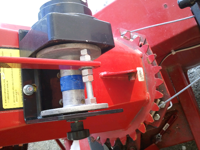

cut off your manual setting arm on your chute deflector at the correct location (see pictures) and drill a 3/8" hole or a little larger. Disassemble one winch and drill a 3/8" hole through the the spool piece (see photo).

Definitely need pictures. I'm trying to figure out why you needed two winches.
   / Homemade chute rotator perfected #4
One to rotate left, one to rotate right?

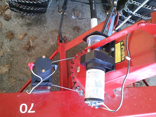

Ok sorry about that. I was posting this while walking around trying to do stuff and it wasn't working.
Here's some pics of the set up I have been running.

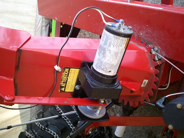

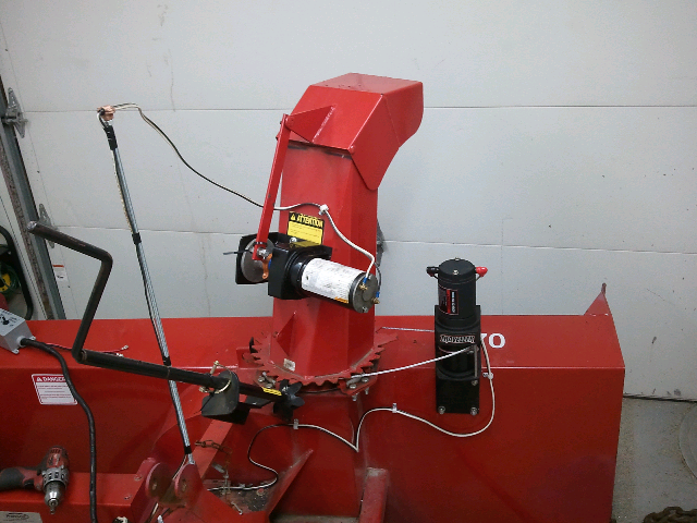

Ok lets try pics again.
Some images facing the wrong way but you get the point.
It works slick. I wrapped the spool on the rotator winch to make it a bigger diameter to change my gear ratio. Now the speed on the chute rotator is PERFECT! Not too slow but not so fast that you can't control it.
The deflector was too fast and overshooting at first so I went from having a short "arm" bolted to the spool THEN connected to the flat stock connecting link to being connected directly to the spool with a piece of 3/8" t-rod.
I forgot some other parts. A piece of flat stock to bolt the rotation winch to. I think it was like 4"X12" or something. I work in the HVAC field so I had some of the parts already but id say I probably have like $170 into the whole setup. And like I said it works good so far. Oh one more note. Make sure you mount the chute rotation winch with the motor facing UP not down. It looks better facing down but water can get into the motor that way.

OK, now I understand what you're doing.
Are you switching the motor current with those switches or is there a relay box somewhere??
