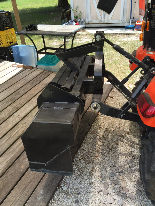

I transformed a front loader bucket that I had on my arc into a box blade. I cut the loader connection bars , added a drawbar, sides on the bucket and a hitch for my 3 point hitch.it irks great behind my tractor.

I transformed a front loader bucket that I had on my atv into a box blade. I cut the loader connection bars , added a drawbar, sides on the bucket and a hitch for my 3 point hitch. It works great behind my tractor.

How wide is your blade running
   / Homemade box blade and hitch
It was a 48 inch bucket-made a 48 inch path
