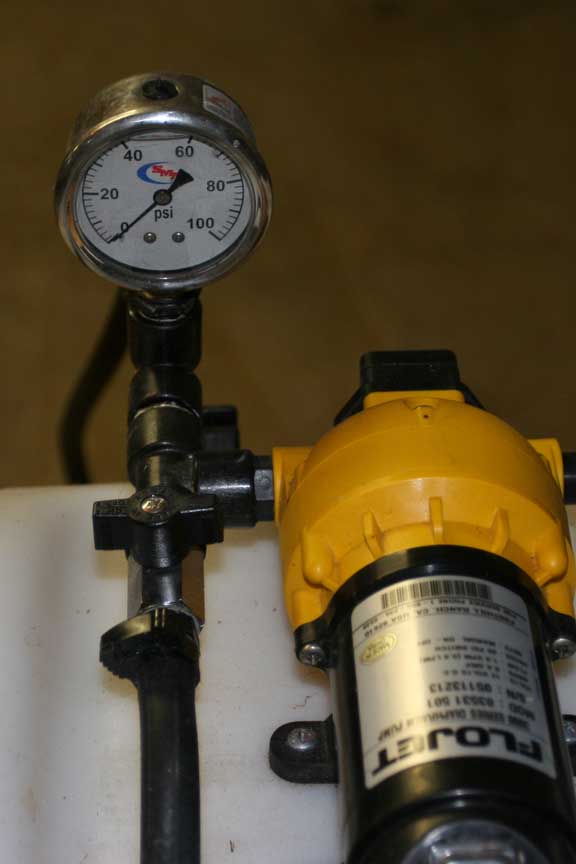

If you plan on spraying 24d you should be careful with drift, which is best prevented by spraying at low pressure, < 30 psi. I spray at 20 psi. You can install a pressure gauge and a bypass (just a ball or needle valve) valve at the pump outlet. Run the hose from the bypass valve back into the tank. This drains the excess pressure back to the tank and allows a crude (cheap) pressure control. The pump runs continuous, but the spray will have steady pressure and pattern.
Consider using 1" square steel tubing as a boom and 3/8 hose connected to spray fittings. The nozzle bodies have filters and a no-drip feature so the tip does not drip the contents of the boom when you turn off the power. Cap hold the tip with 1/4 turn so you can change tips in seconds.
Spraying Systems Inc. is the leader in ag spray tips and has an excellent paper catalog. In less than an hour of reading you will find out how to do your system right, better than a cheap store bought rig. The TeeJet web site is akward. A paper catalog is much easier to use. They would be better off having a duplicate of the paper catalog in pdf format you could download and scroll thru.
