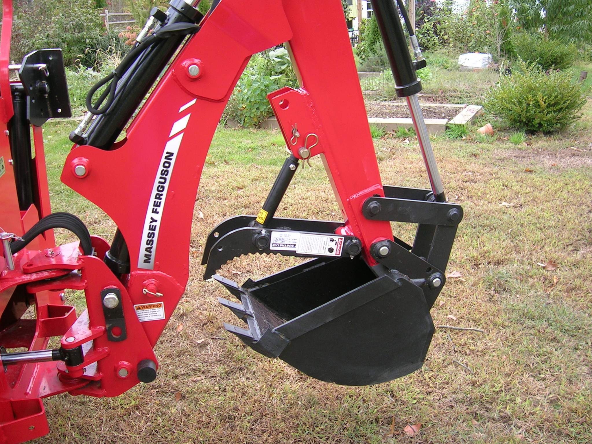

As to not being able to mount a thumb on a GC, I'm not sure why one would say that. I have a Sundown thumb on my GC. It was installed by the dealer prior to delivery. It's quite a beefy unit, used on machines up to about 50hp. It's a little big on the GC, but it sure is nice for picking up rock and logs.
In any case, good lock with whatever you choose. You can't make a wrong choice!
Hey, about your thumb there...is that red painted plate that the thumb is attached to there from the factory or is that what the dealer added and painted on it.
   / Home Stretch! XB25 vs GC2410 packages. What to do?! #8
The red plate is part of the thumb. The dealer welded it to the dipper and then painted it to match.
