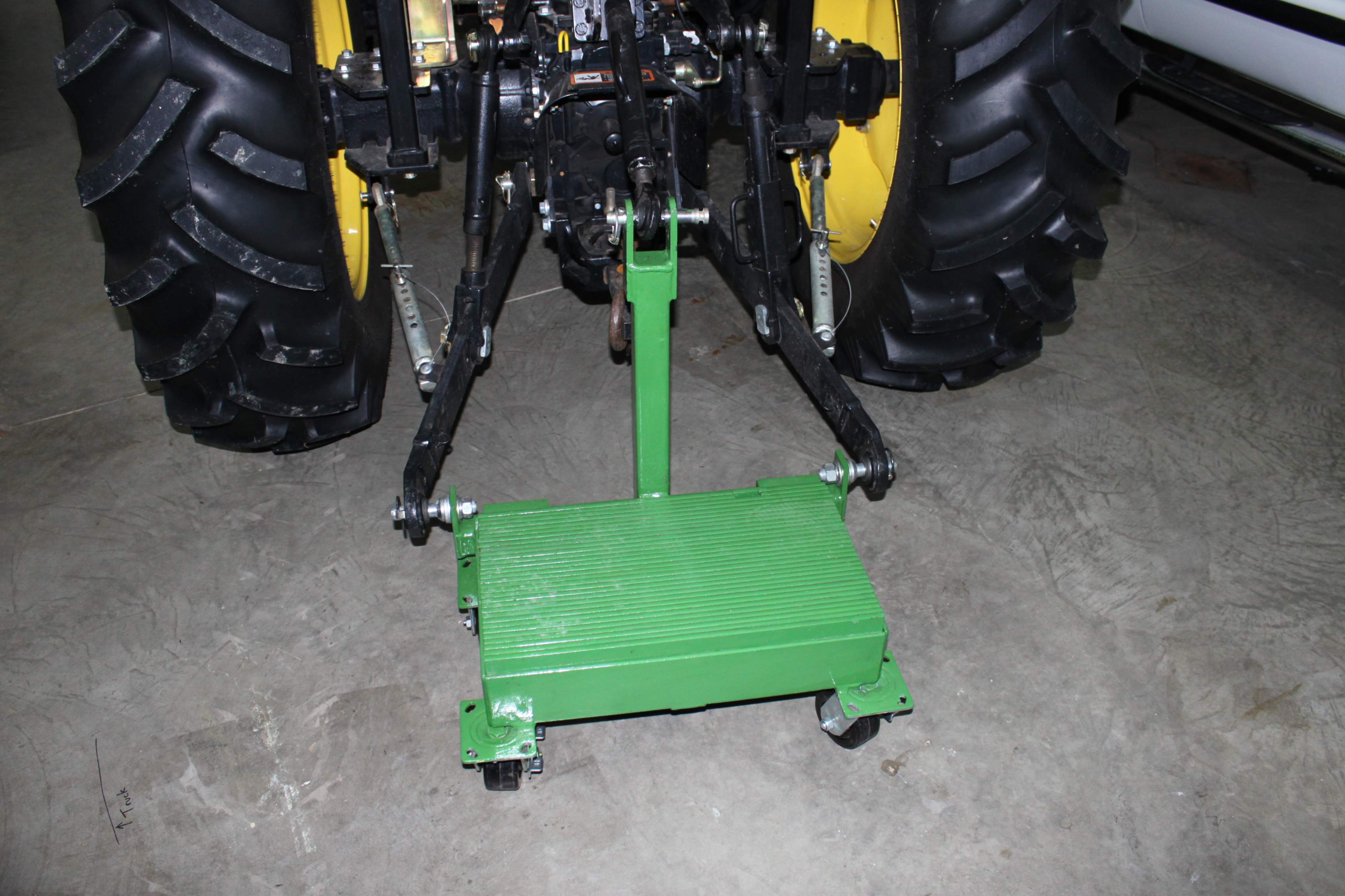

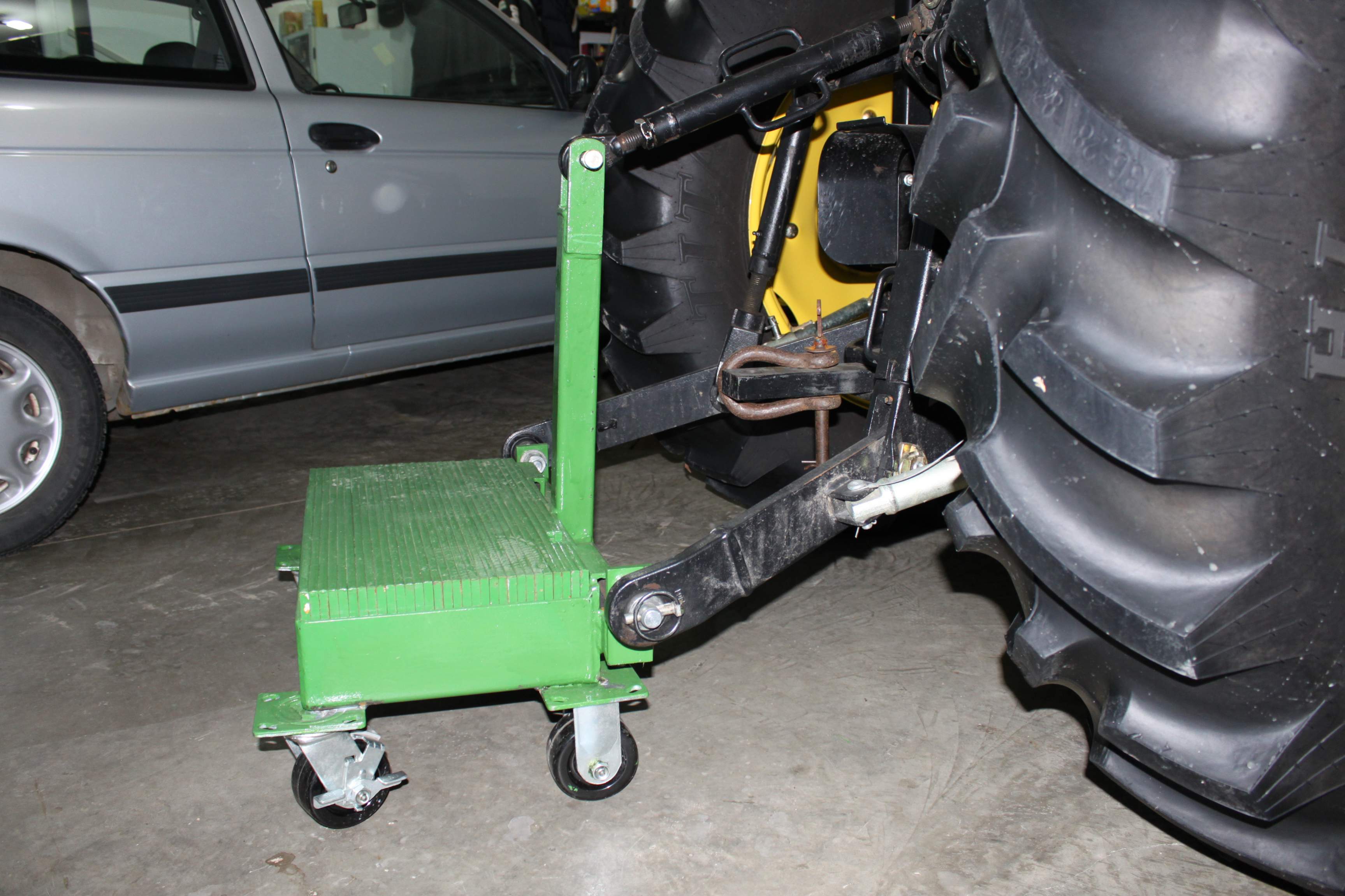

Hi, new to the forum:
Built 500 lb compact weight box to fit CAT1 Three Point Hitch. Used scrap materials and added caster wheels for easy on and off. Also have fluid in the rear tires and 400 lbs of wheel weights. Still need to add a bracket to carry a shovel. Works great on my JD 4720 for snow removal traction. Lots of snow to move this year in Saskatchewan.

Welcome! For adding a shovel holder, you can weld metal tube from the bottom of the ballast box and have it about 3 feet long maybe a 2 inch tube or the sides,
