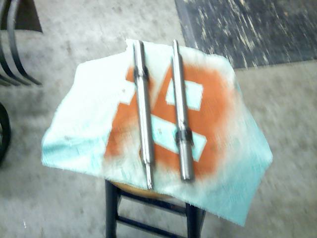

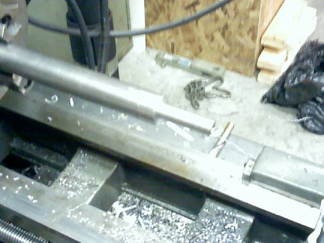

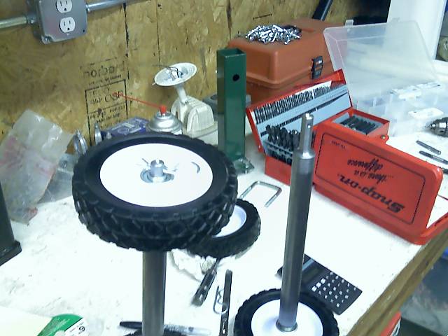

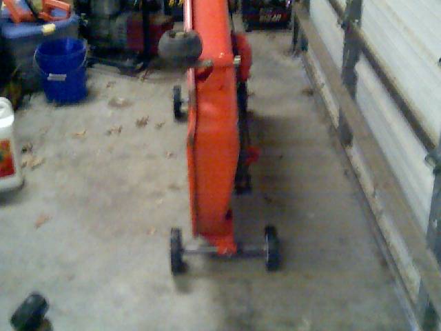

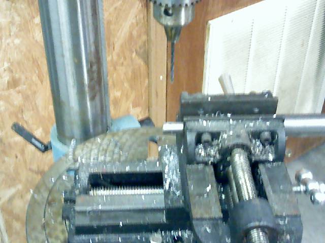

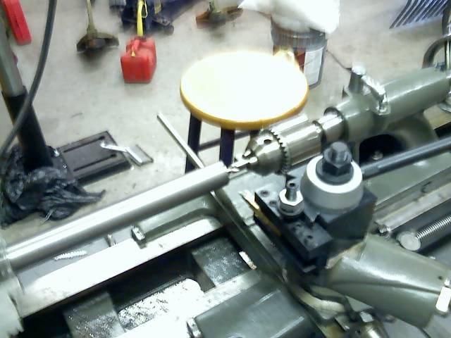

This past weekend I got around to making a set of stands for my RCK54 mower deck. I only wish I would have made them sooner makes storing and moving so much easer. I started out with 2 pieces 1" round bar 12.5" long. Tap one end to 3/8"16 for shoulder bolts. The other end I turned down to 1/2" X1"3/4" long and drilled a .125" hole in it for a hair pin. Then cut 2 1' hyd. pipe to 1" wide length for the stops and used a 1/8" roll pins to secure it on the shaft. I used 5" steel lawn mower wheels. Once upright the set up seems very stable and rolls very easy even in gravel.

Very nice. Now it takes up so much less floor space and you can roll it up against a wall and put a safety strap on it if you have any little ones around. Would hate to hear about it falling over and injuring on of them.
