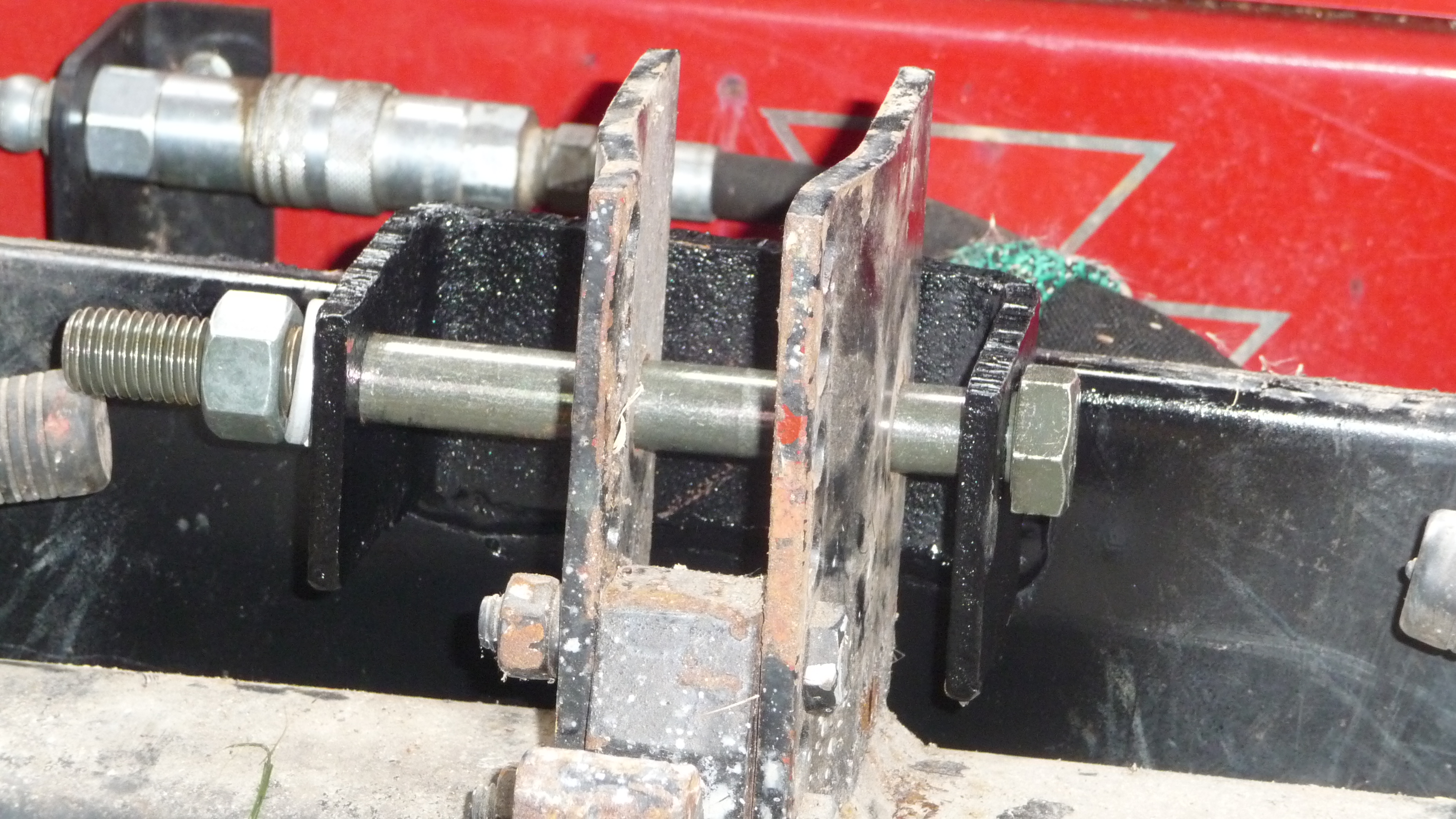

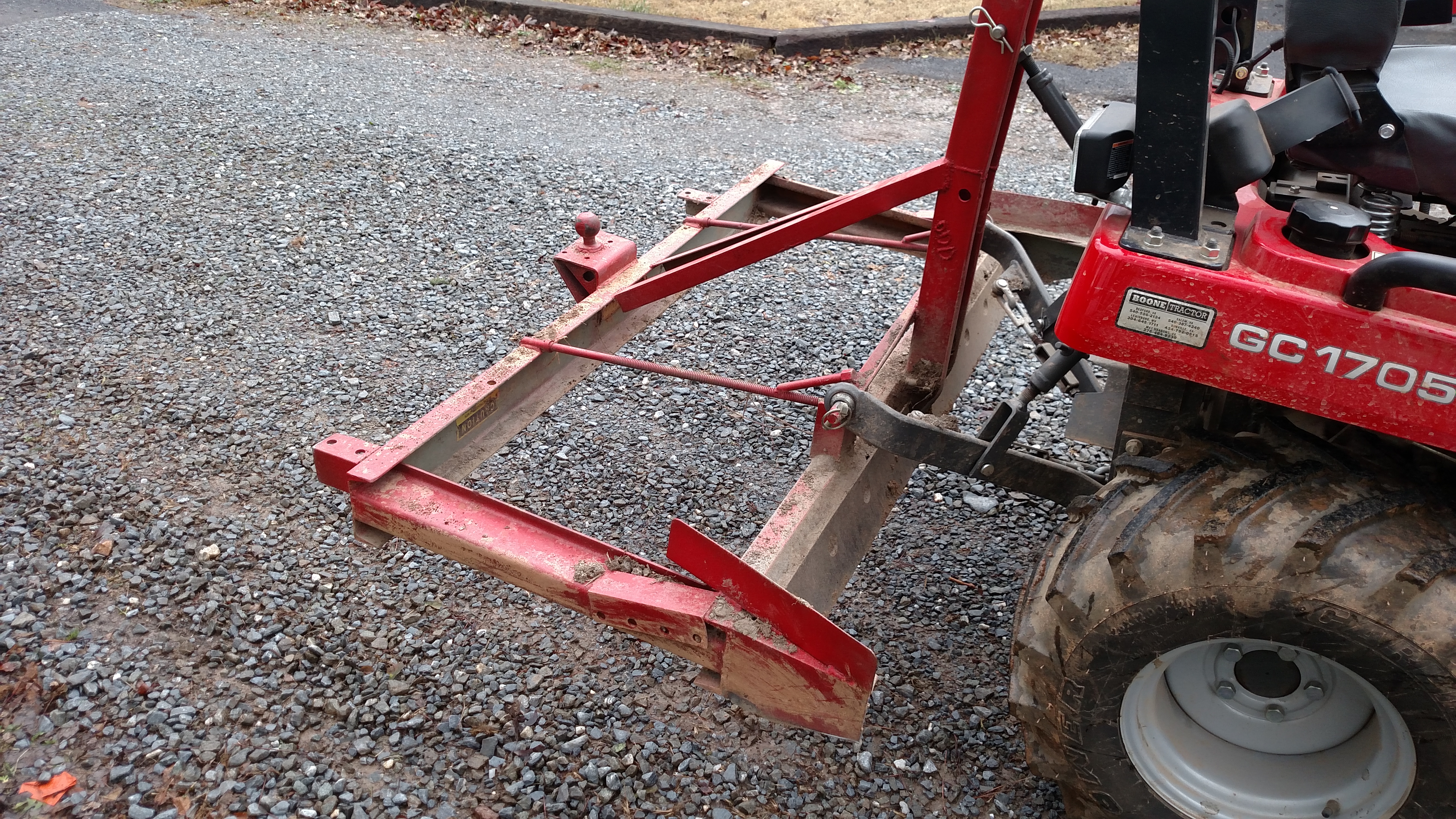

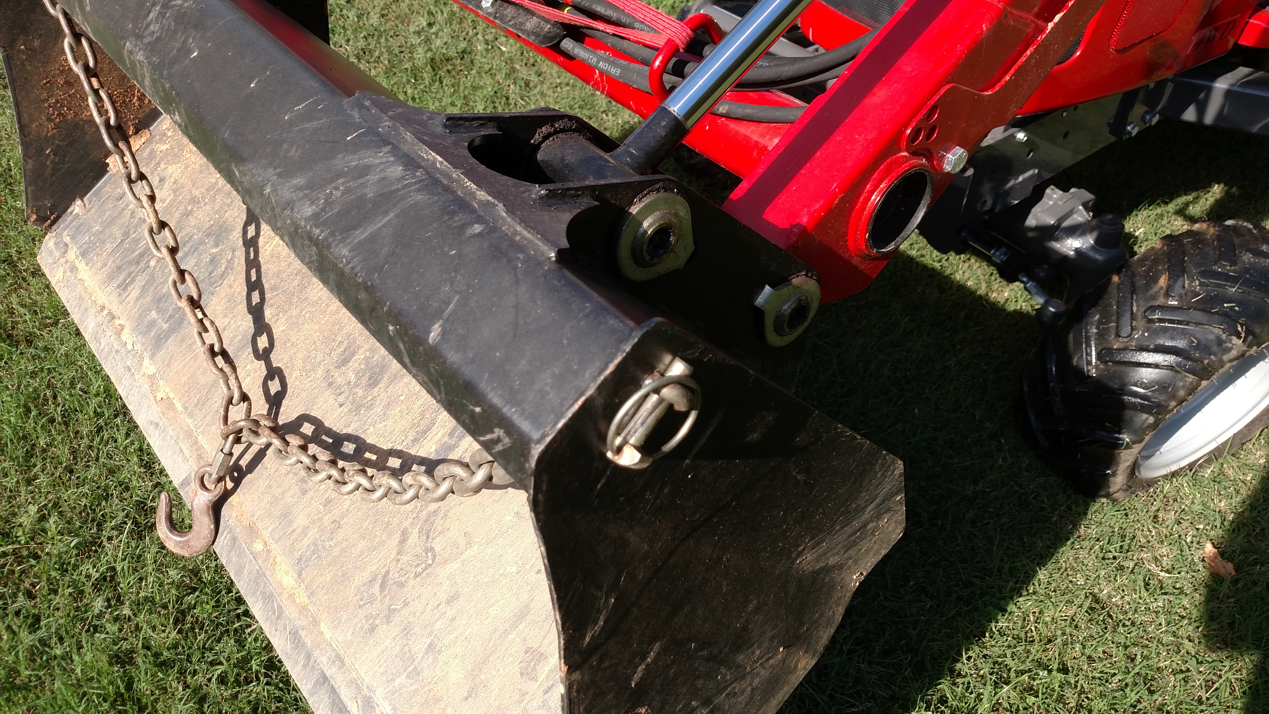

IMG_20161003_101116197 - Copy.jpgHere are a few things my son and I made for my GC 1705 out of scrape metal laying around and acquiring from scrap yards cheap!!!!. We made the counter weight it has about 300lbs.on it. the chain in the bucket is held in by 2 pins for easy on/off, and my own design of land plane works like a factory made. And the cherry picker is a handy thing too it has a receiver hitch so I can use it to lift or move a trailer by removing hook and putting on ball.IMG_20170103_122726188.jpgIMG_20170103_122858753(1).jpg

1 question, why pins instead of a chain hook welded or bolted to the bucket? IMHO those pins bend too easy.

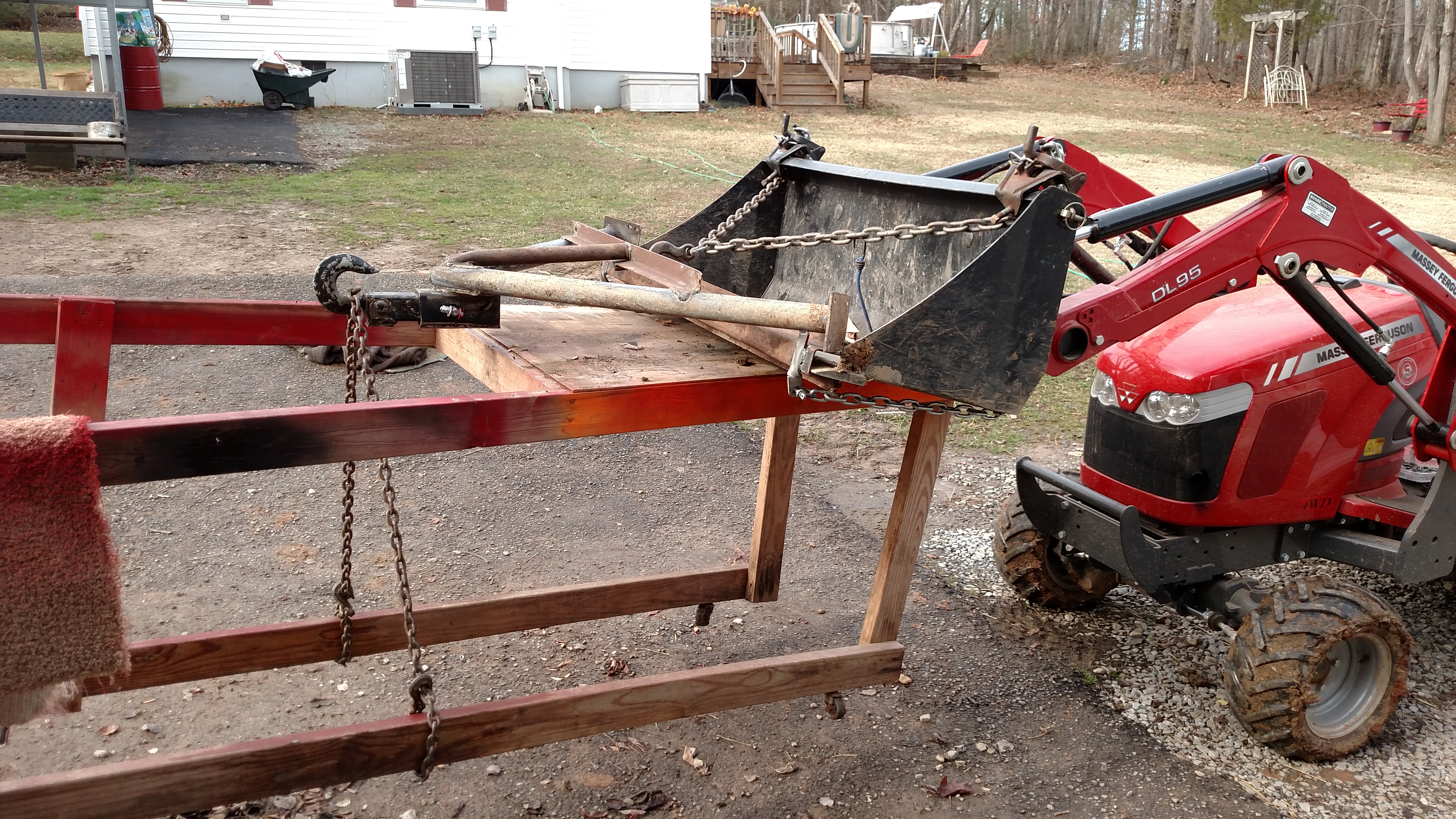

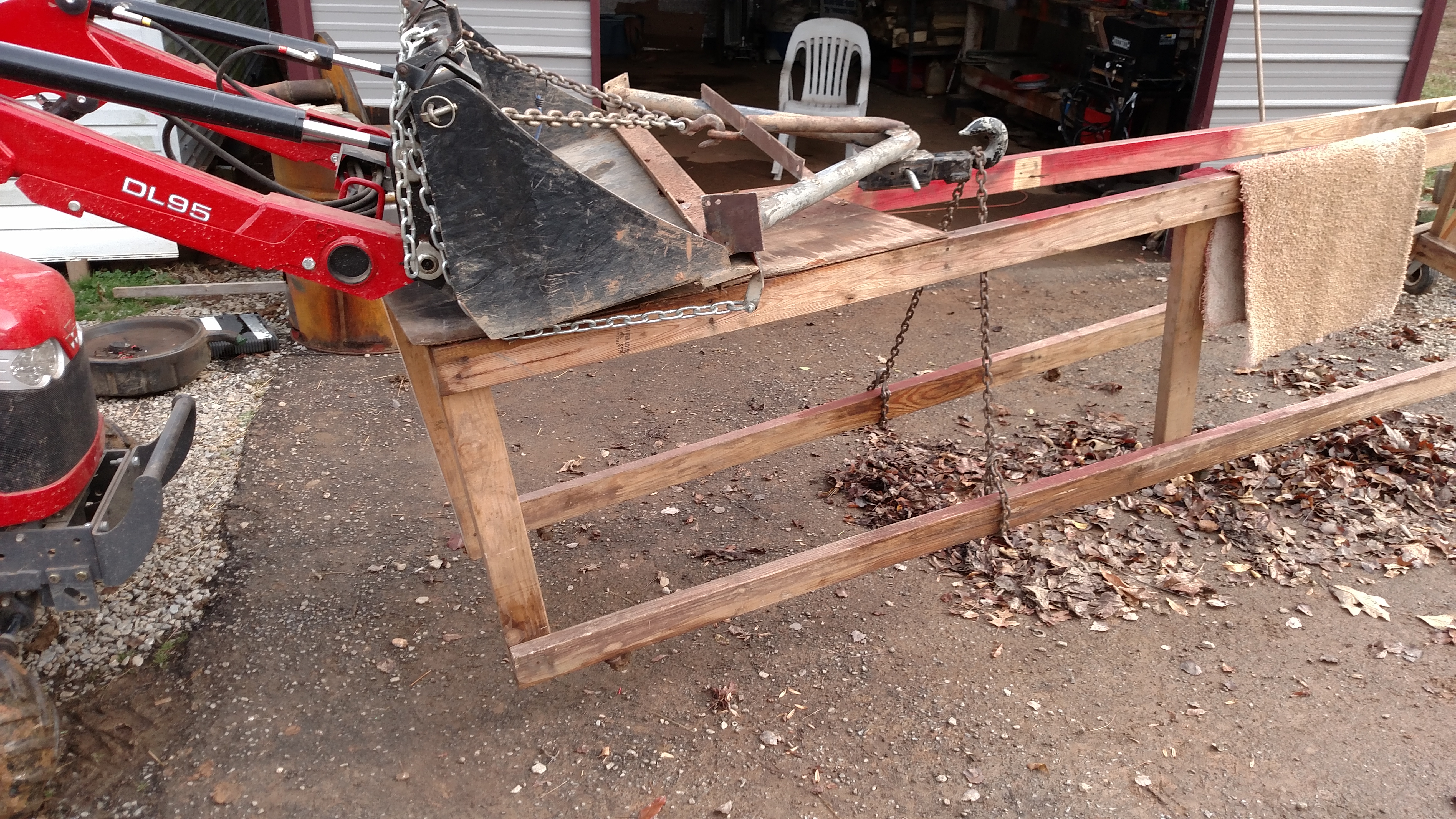

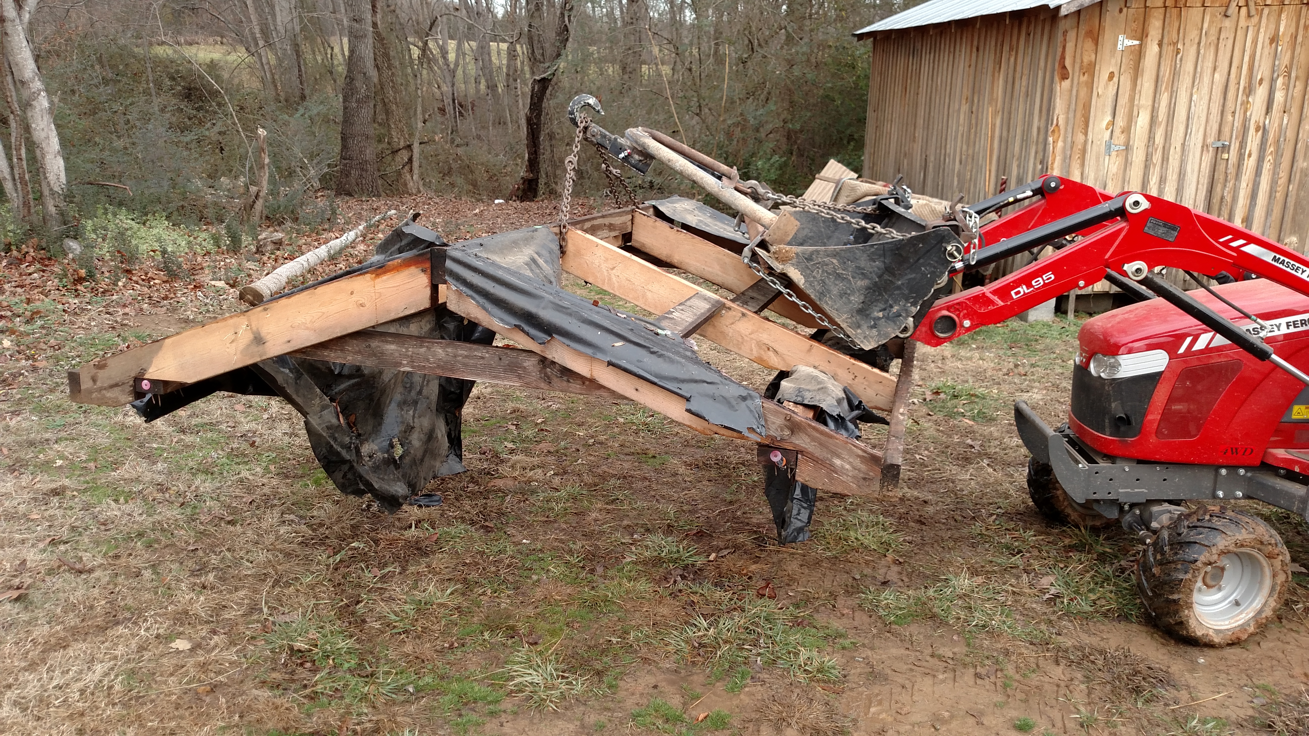

How high is the chain hook above the tip of the bucket (which serves as a fulcrum or pivot) in the 'cherry picker' ? Can't tell from the front view but it looks like it might only be 3 or 4 inches (?) If so, that is one huge lever of 3 or 4 feet compared to the 3 or 4 inches. Very much weight on the front receiver hitch area and something is going to stretch, give, or break. Side view would be instructive.

The hook is about 24" from bucket edge I picked up my counter weight which is about 350lbs with no problem I had my land plane on which weighs about 300lbs. i have some side view pictures.IMG_20170104_122458419.jpgIMG_20170104_125655567.jpgIMG_20170104_130138579.jpg

I don't want to void my warranty by welding anything that's why all my additions are bolt on or pin on.

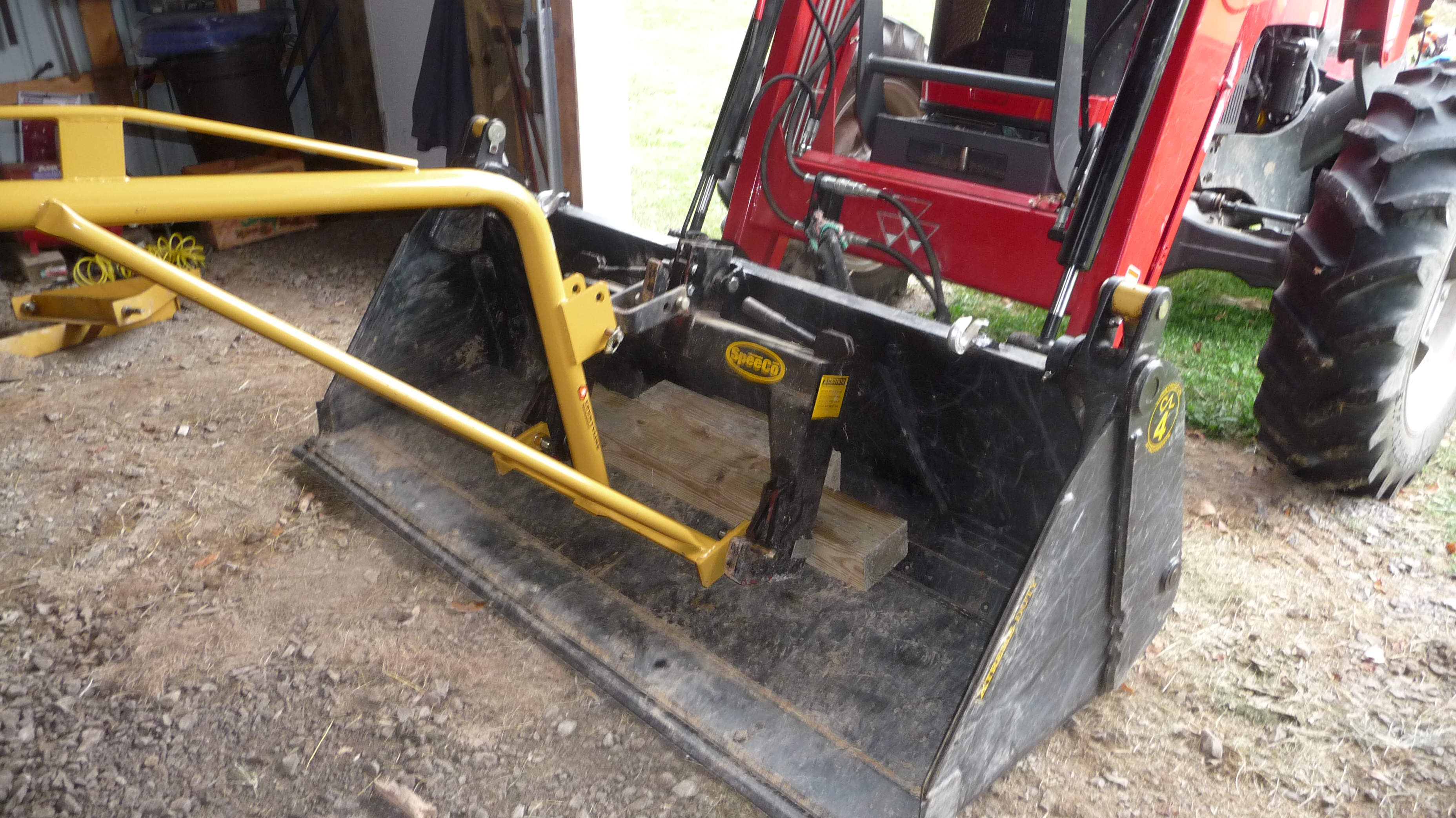

Ah! That sheds a much different light on the mechanical circumstance. There is not that much of an overwhelming leverage of the receiver hitch point over the chain hook point. Should hold for most things and certainly for moving trailers around. I have rigged a quick-hitch frame to fit into the FEL on a larger tractor and welded a bracket on the bucket to accept the "top link" part of the quick hitch. I'm very cautious what I try to lift with it but a pig pole then fits the quick hitch and allows me pick up fairly heavy objects out on the end (or better/safer the close-in lift point on the pig pole.)
