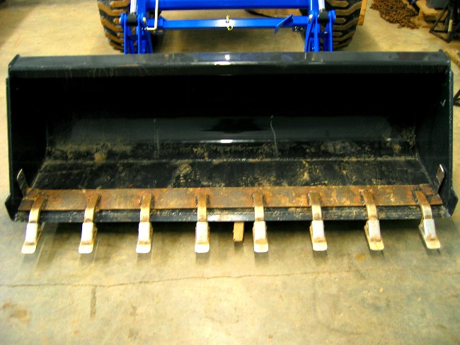

Deerhunter F350 ; This is the tooth bar I built for the TC 45 D. It also had a 6' HD bucket. The main upper support is 3/8 x 5 inch flat steel with the fab co cast steel fixtures and replacable teeth. It is wedged on the cutting edge and held in place by two side bucket bolts. Works extremely well and it has dug boulders out of the ground the loader could hardly lift. I believe the total cost was about $158 for materials. They were clearing out this style tooth ( or it was the end of an order ) so I ended up with 20 of them.

Thanks for the pic, I built a TB something similar, except I used 1"x1" Solid Square Cold Roll, and made my own Shanks. And Bought Teeth at $2.75 per tooth.
I really must take time the next trip to the property to take some pics.
