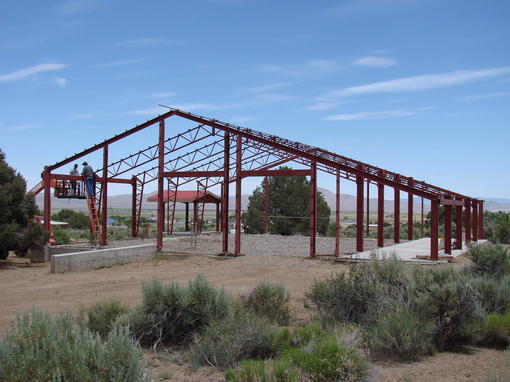

nickel,
On my new place the entire frame is steel and the design calls for diagonal rod bracing and steel straps of 3" X 1/8". This is for an open design with no sheathing on the roof or sides.
I'm eliminating most of the strapping and rods because it will all be sheathed and the straps are right where some windows go. I know it sounds stupid to remove bracing to accommodate a window, but there is enough strength to over compensate for this. It also has rigid frame bracing.
Installing the bracing initially to get the rough steel inspection did cause some consideration because it had to remain floppy to retain the proper post alignment. The idea was to tighten it up later, after the sheathing is on.
