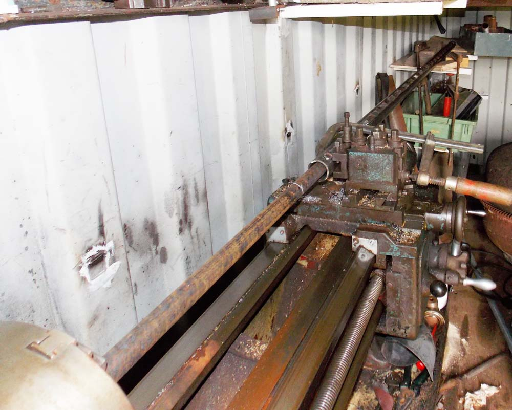

big job on a small lathe. Oh look, my gasbottle lawn roller is in the pic. that mounts on the FEL too.

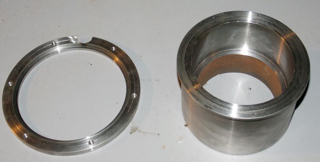

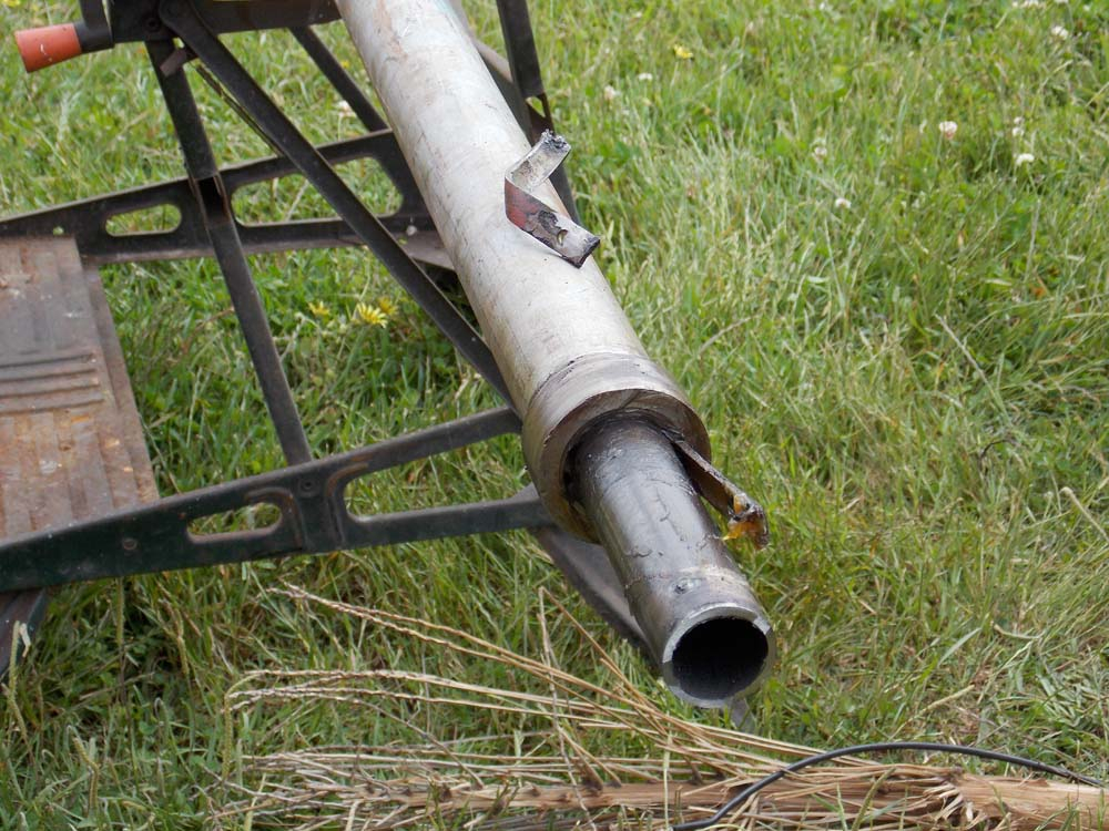

shiny bits made from scrap; the collar on the right rotates on the end of the main tube, the thin thing on the left is the retaining ring.
They fit here;

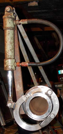

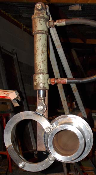

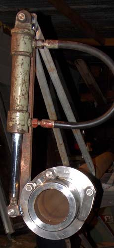

And are rotated 180 degrees by this cylinder and linkage;
another angle;

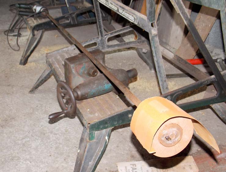

The main pipe was rusty inside so I made this to clean it up;

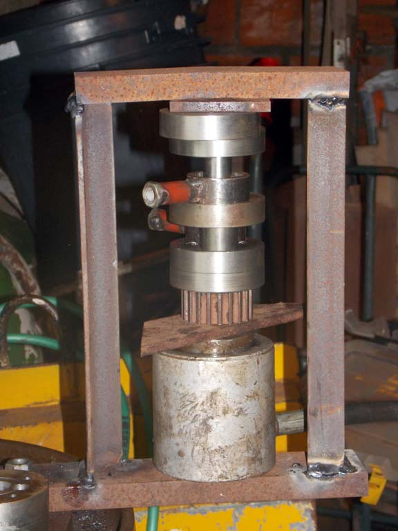

Pressing it together in a quickly built frame with a little portapower thing I got at a flea market long before.

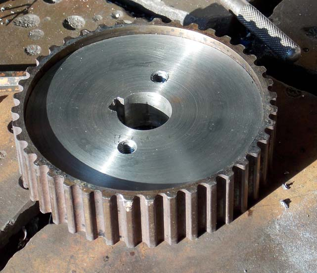

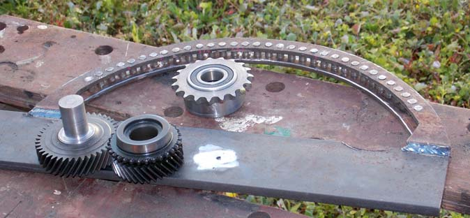

I actually bought the sprocket new... The gears are from a junk car gearbox, and I made the cogwheel from plate and rod.
This whole mechanism is bonkers, and I can't even remember the rationale behind it.

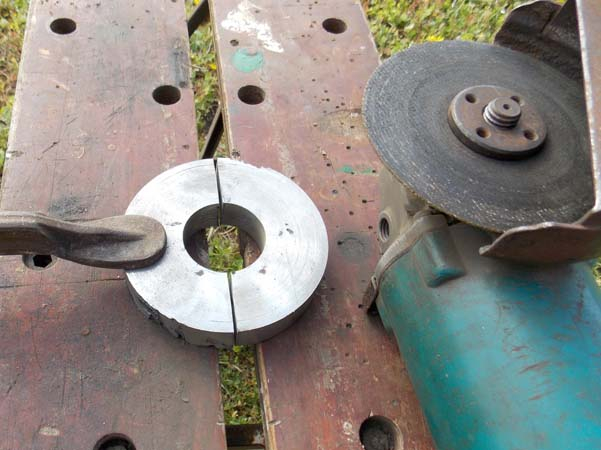

Make a ring, cut it in half.
Make the cuts true...
Bolt it together and make it round again.
Simples.

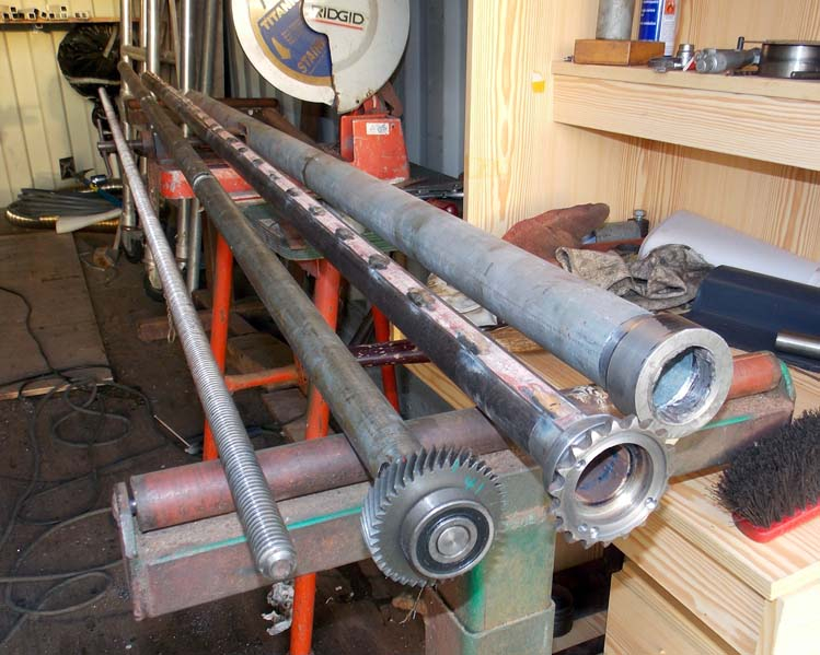

This is the power head that holds the cutting blade and main hydraulic motor.
These parts all fit inside each other; the long screw extends the reach and retracts into the pipe with the gear on it. The 3rd tube is rotated by the cogwheel and rotates the biggest tube, which rotates the power head through the undersized bevel gears.

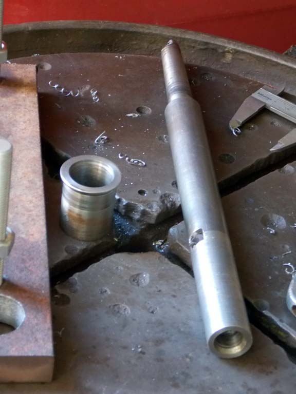

The trapezoidal nut in the 1" pipe for the long screw is cut to fit the bearing in the end of the 2" pipe.
the 1" pipe spines fast enough to whip inside the 1-1/4" pipe, so I added these split bushings.
This little hydraulic motor will spin the 1" pipe via the 2 gears, to extend or retract the cutter 2.2 meters.

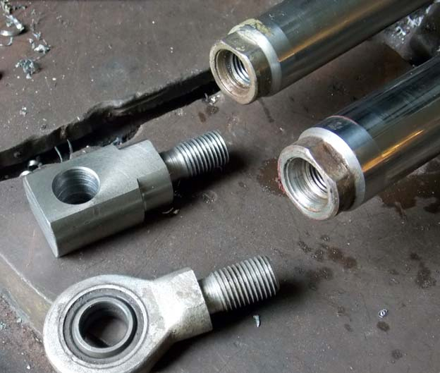

One of my little cylinders was missing the end, so I made one.

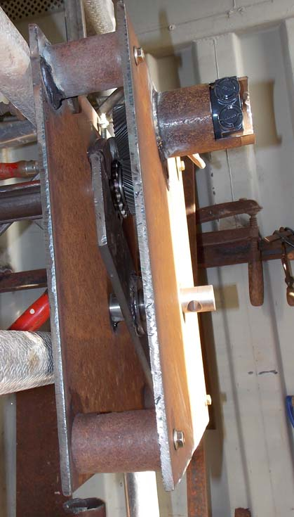

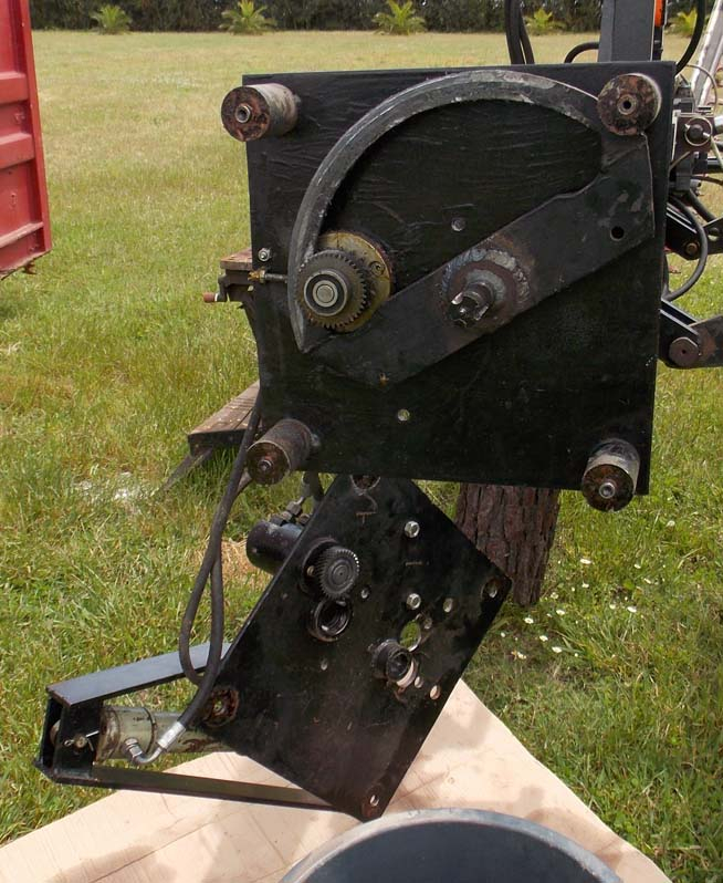

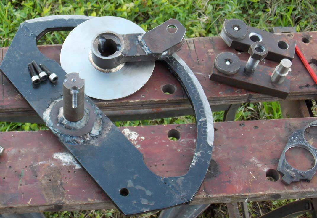

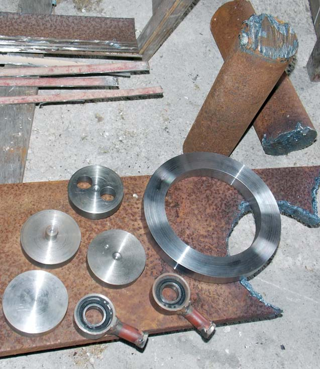

Some heavier parts; the pivot for the whole machine to swing from right to left. The rings are from the scrapyard, cutouts from holes in something bigger than me.
Creating the cogwheel box at the other end of the main tube.
Cogwheel is rotated 120 degreesish by this setup.

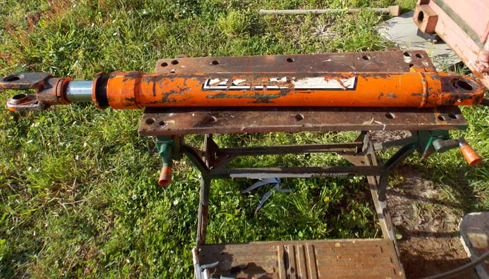

This larger cylinder will swing the tube over, bit it was too long. So I shortened it; that went easier than I'd imagined, and was good fun too.

This part is fun; cutting a new thread on the shortened hydraulic rod.
Satisfying.

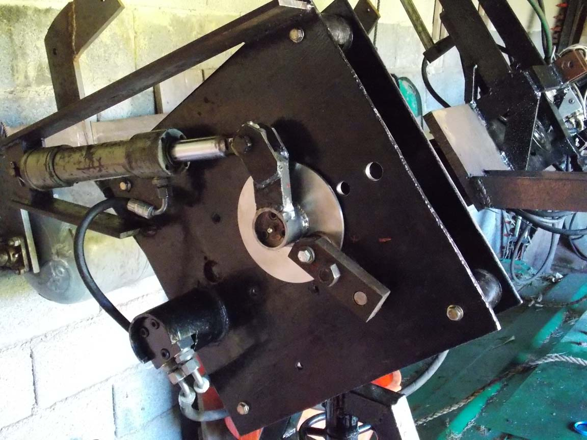

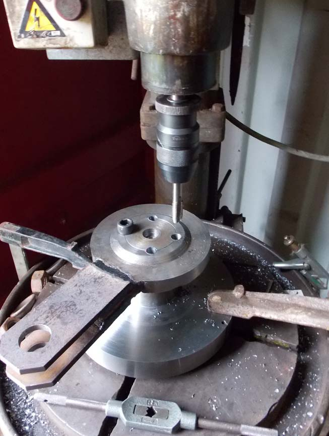

The big cylinder acts through a linkage to rotate this center hub 180 degrees. I bored and tapped it, then fit 14mm allen screws to lock the shafts together.
The trick is to drill slightly undersize, then cut down the allen screw heads on the lathe for a tight fit.
Note the recessed zerk fitting.

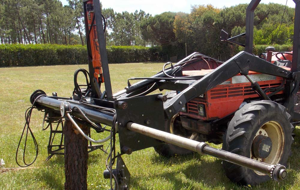

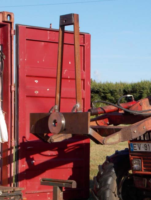

Basic frame mounted on the FEL. It's the easiest way to hold it up while I work on it.
Plate is 20mm.

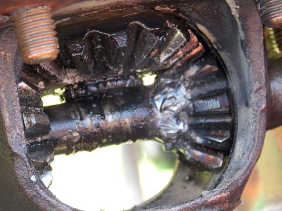

I told you back on the first post of the thread, the bevel gears are too small; the lock pin sheared the second I tried to rotate the blade.
So I welded it to the shaft; not pretty but it held for years that way.

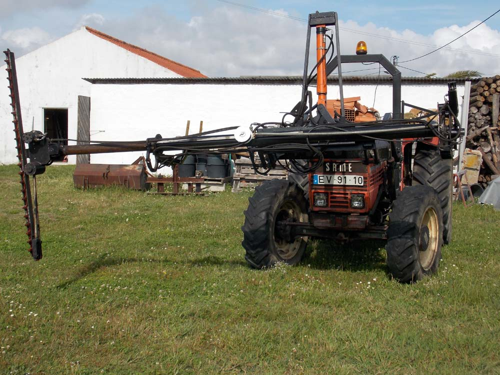

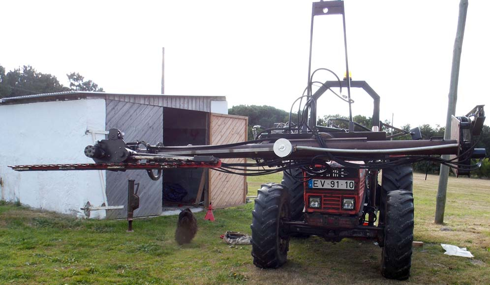

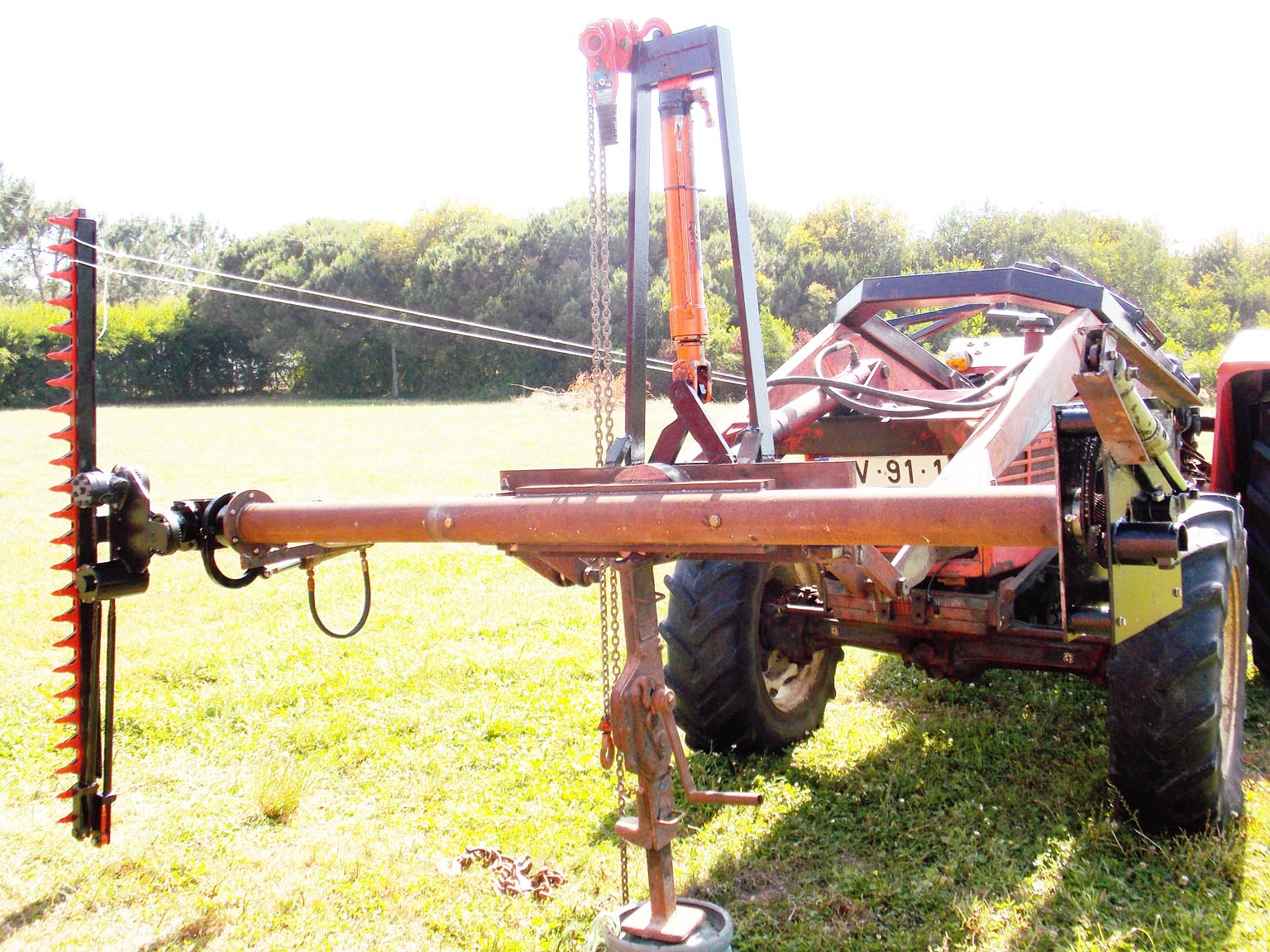

some pictures of it assembled;
Except the big cylinder is taken out in this one, I don't remember why.

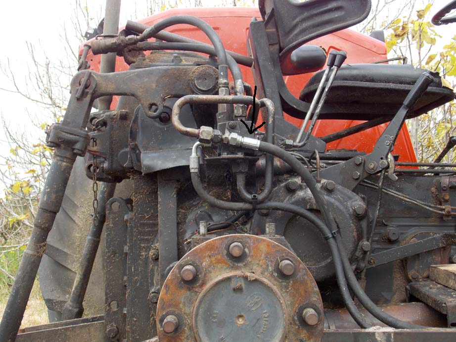

The hydraulic supply. The wheel has to come off to get at it.
The wheel is heavy.

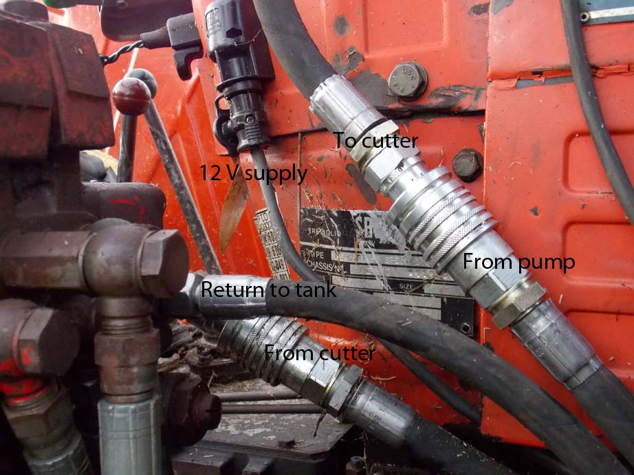

I interrupt the supply to the FEL, send it up the the hedgecutter, and back. When the hedge cutter is off, the quick couplers fit together so it works like before.

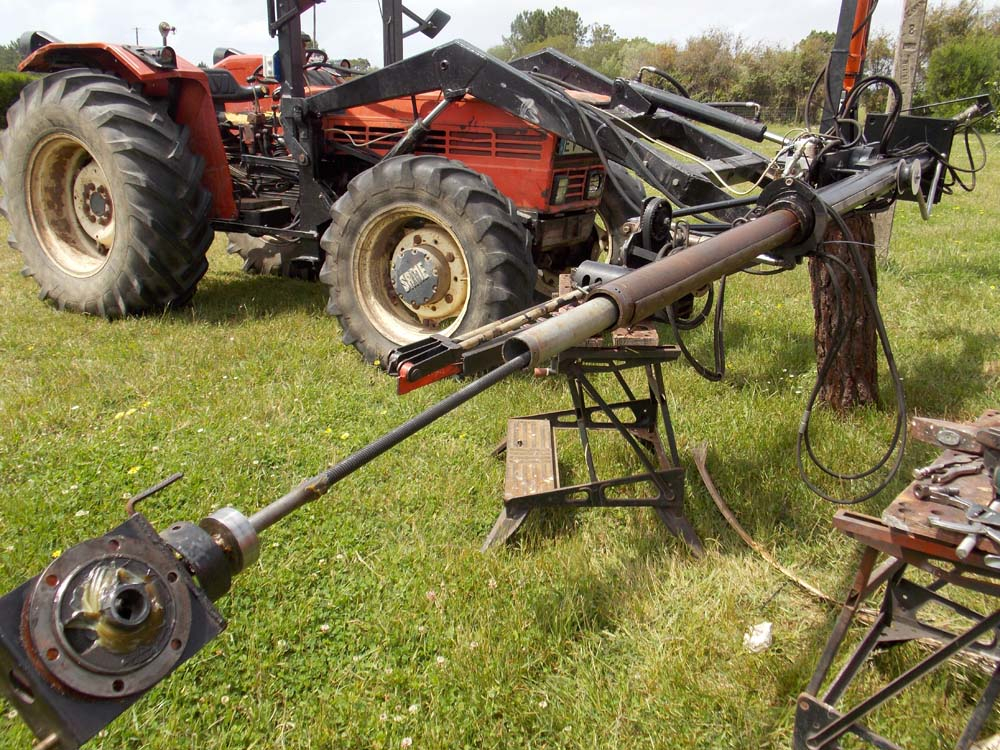

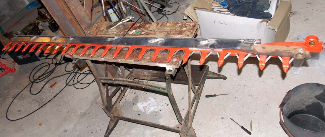

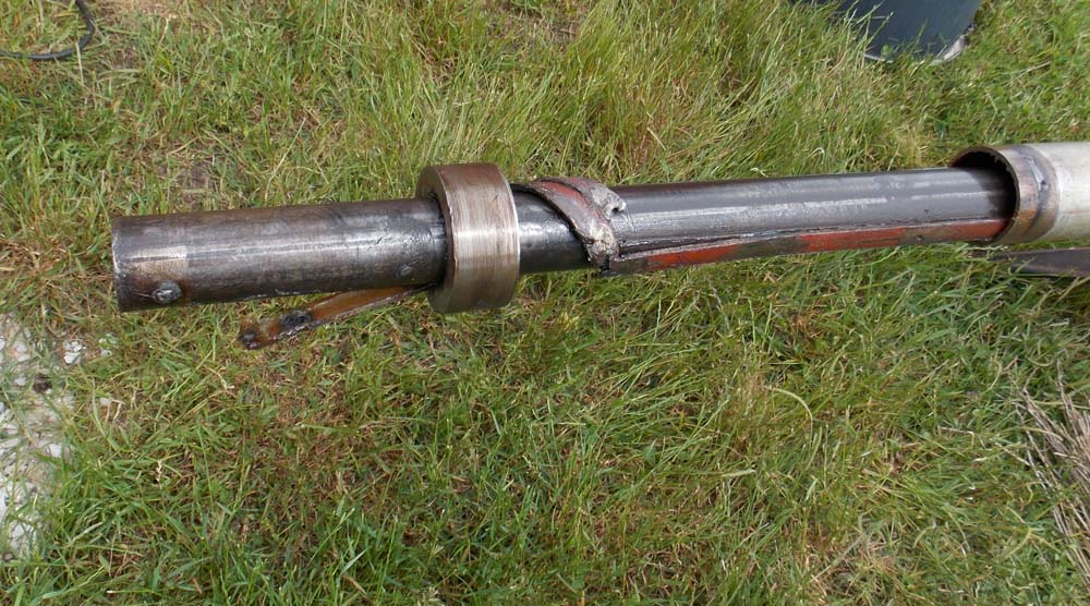

Next breakdown; my home made spline tube is looking a bit twisted.
Taking it apart;

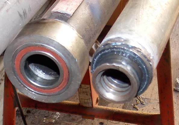

After re-welding the splines onto the tube a bit harder and with more welds, it had bubbles inside that had to be cut. So I made this gross but very long boring tool.
The cutter is a drill shank, clamped in place by the screw that sticks out the end.
The tool bar is in the lathe chuck and the tube in the lathe tool holder; after cranking it slowly forward to the chuck, bacl up and extend the tool for the next section. gross and ugly, but it worked.
parts I made, disassembled.
reassembly;
And ready to work again;
