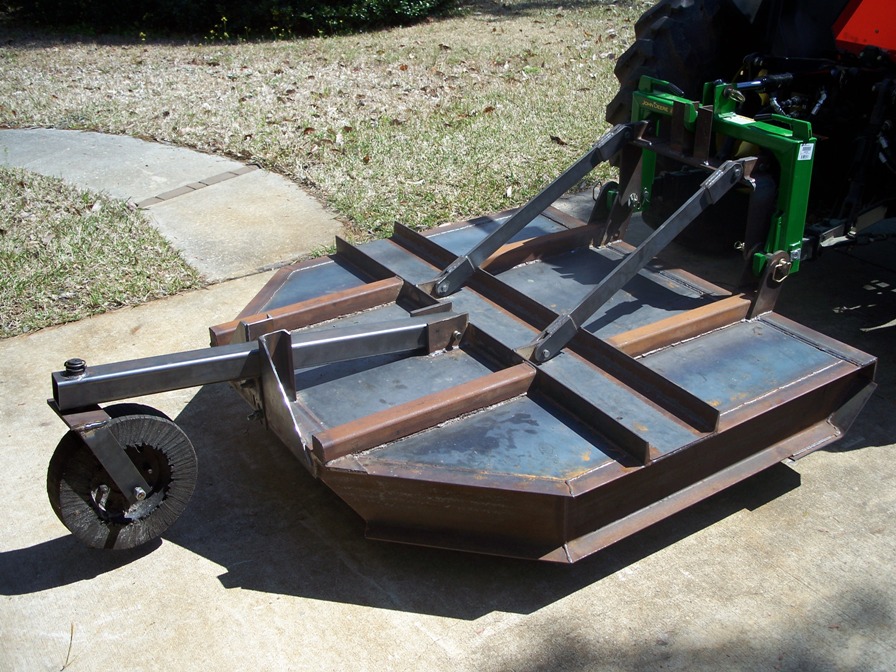

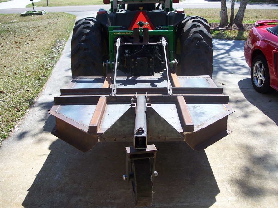

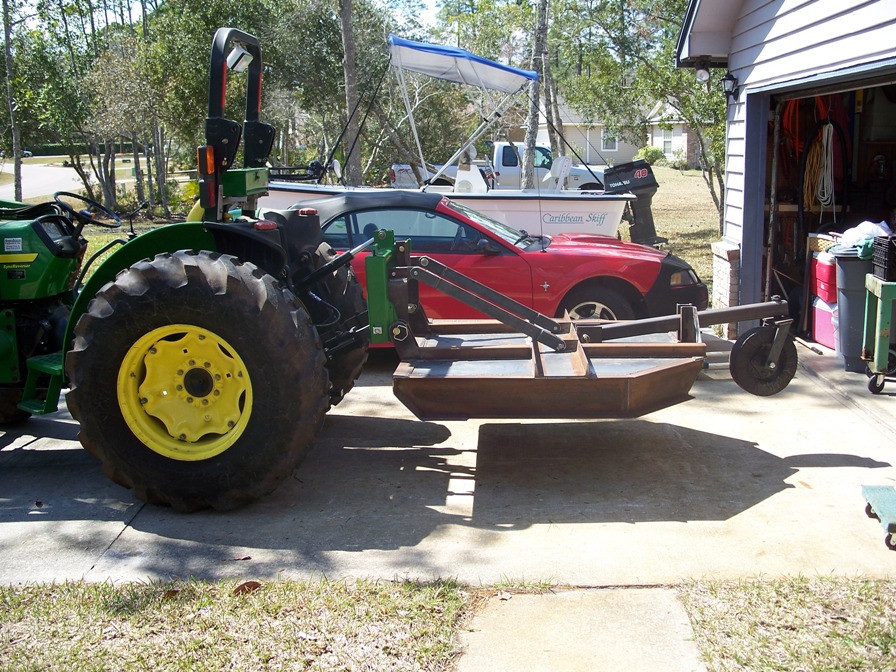

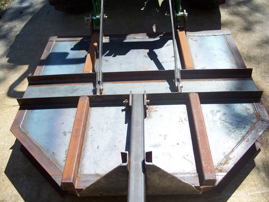

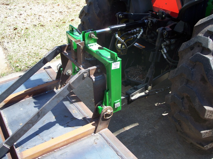

Hello All,
Thought I'd share some pics of the RC I'm building.
A few more welds, mount the gearbox and blades, paint, and I'm done:D
It's Imatch ready:thumbsup:

Nice work. That thing is built like a tank. To buy one that heavy you would spend $1500 or more if you could even find something like that.
What do you have in it and what are you going to use for a gear box and blades?

Wow that is great looking!:thumbsup: I love the built-in floating hitch you incorporated-it should work very well.

Outstanding work!
Is it 5 or 6 feet wide?
Can't wait to see the final product and first test run.

Great looking cutter, it's built like a battleship, so I think you should name it U.S.S. Missouri.

Nice job!:thumbsup:
I can see you paid attention to little details!
Please keep us up to date with more pictures.

Looks great extra heavyduty one question what gear box and where will it mount and did you draw plans if so will you post them please

I am thinking of building one because A. the only bush hogs you can get here are flimsy Italian stuff for lawn tractors, B. I have spent my money in a workshop full of tools, which needs to pay for itself and C. I tend to break cheap stuff.
I think i'm going to use your idea of the heavy C channel along the outer perimeter, it puts the beef where it matters, and torching/welding the top plate can happen in my own time, brake pressing a unibody mower deck has to be payd for.
