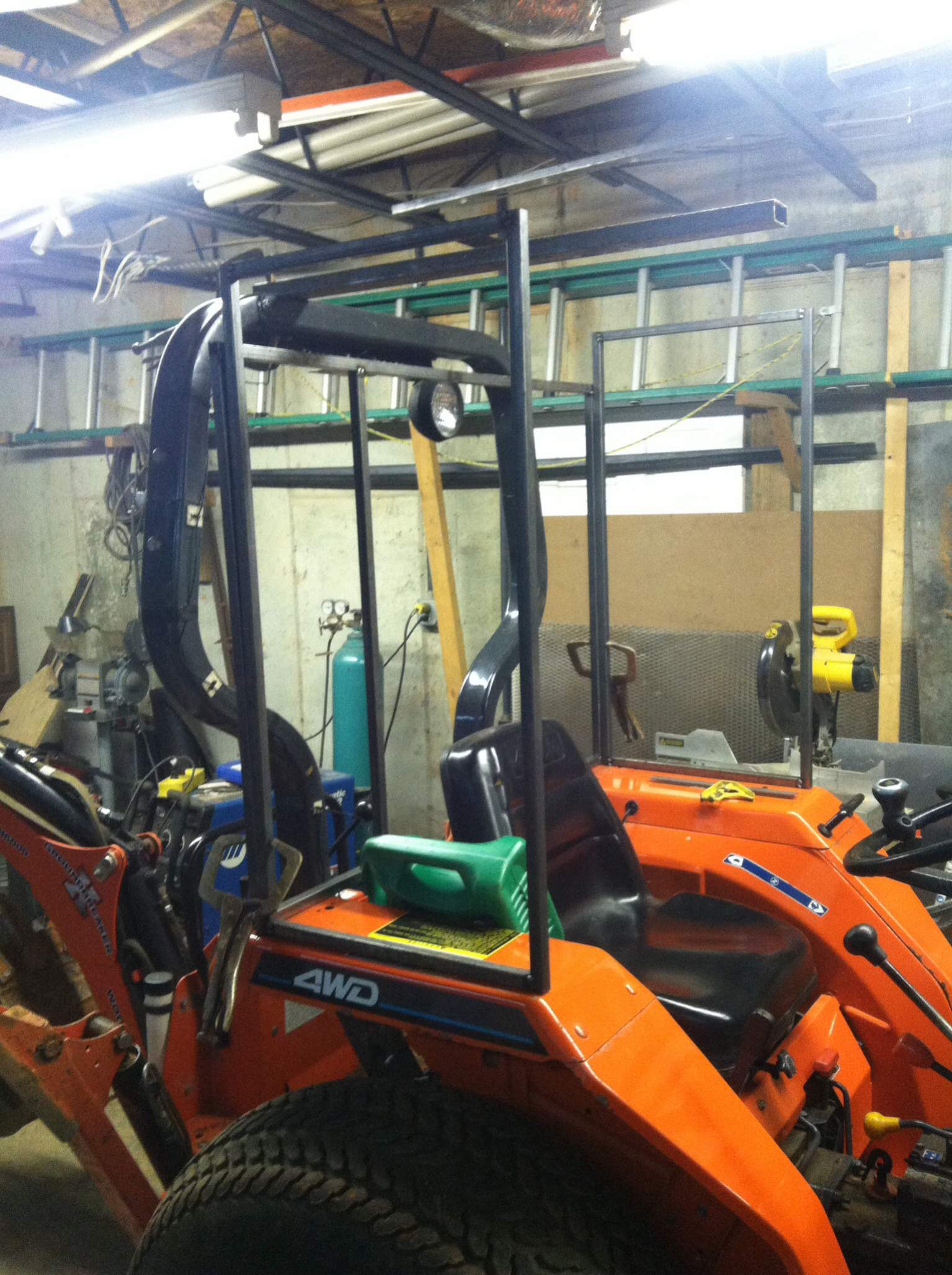

Well, here goes. After researching and studying various designs here and elsewhere I decided to get started on my cab.
I want it to incorporate a canopy as I don't have one now
The ROPS will not be removed
I have to design in a way to operate the backhoe if need be
Doors must be hinged at the front and detachable
Materials;
3/4" x 16 ga square tubing
16 ga hot rolled sheet
1 1/2" x 1/8" flat bar

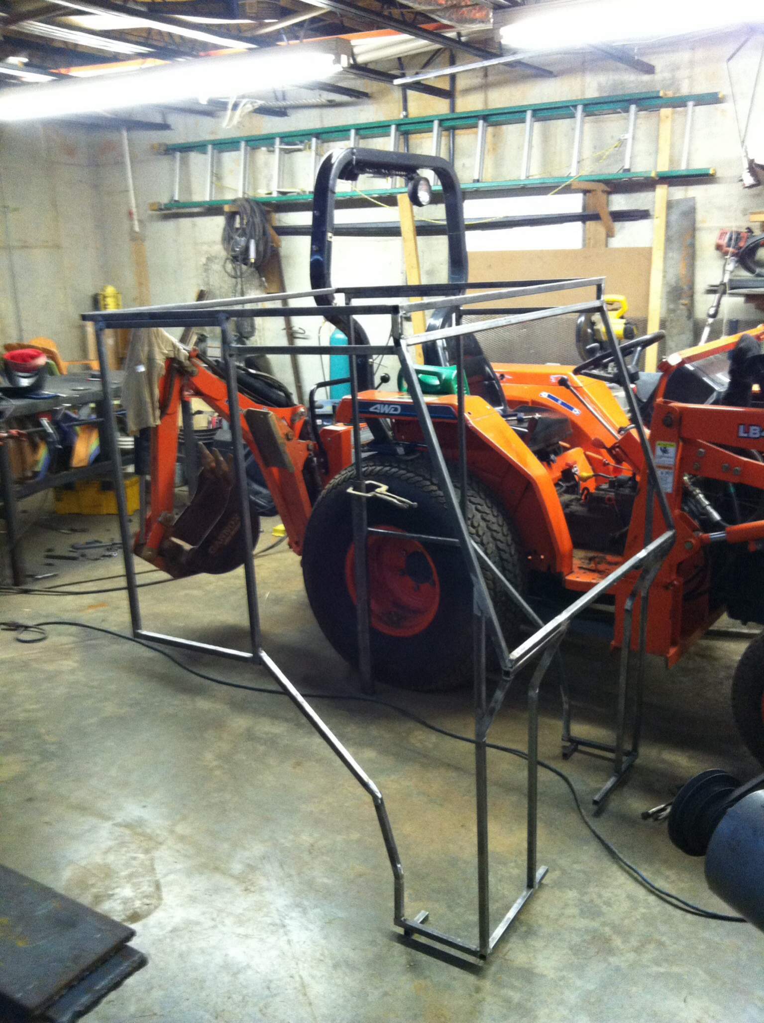

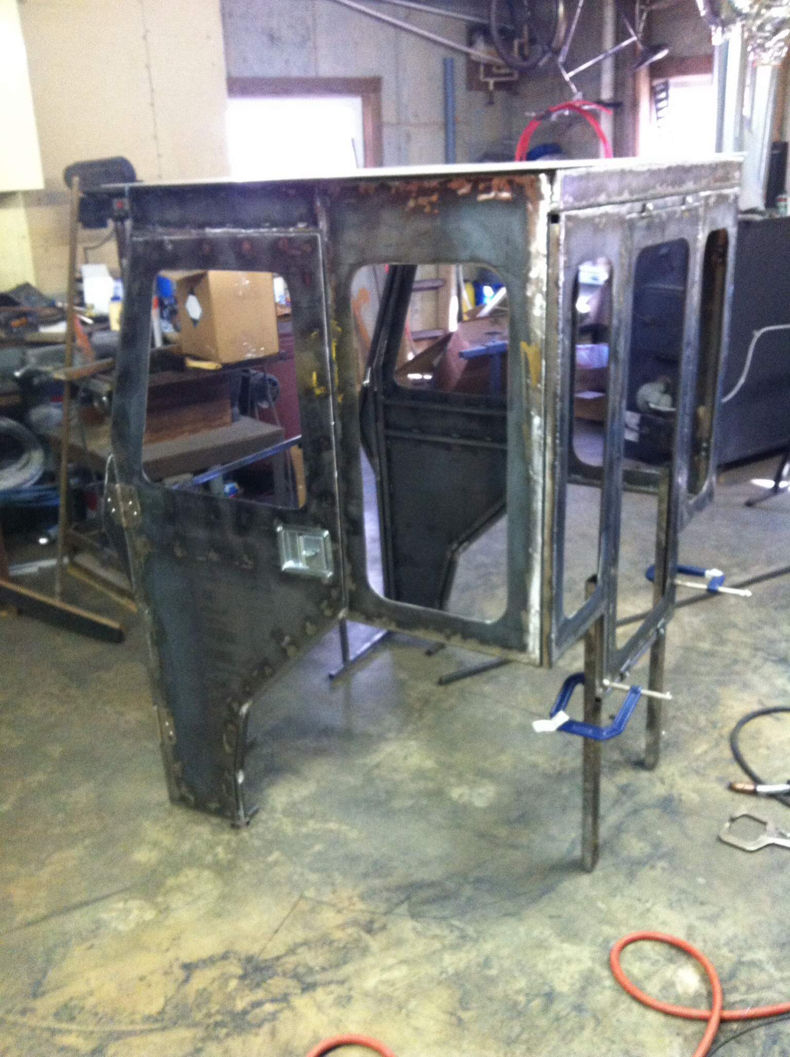

Day 1 (3 hours)

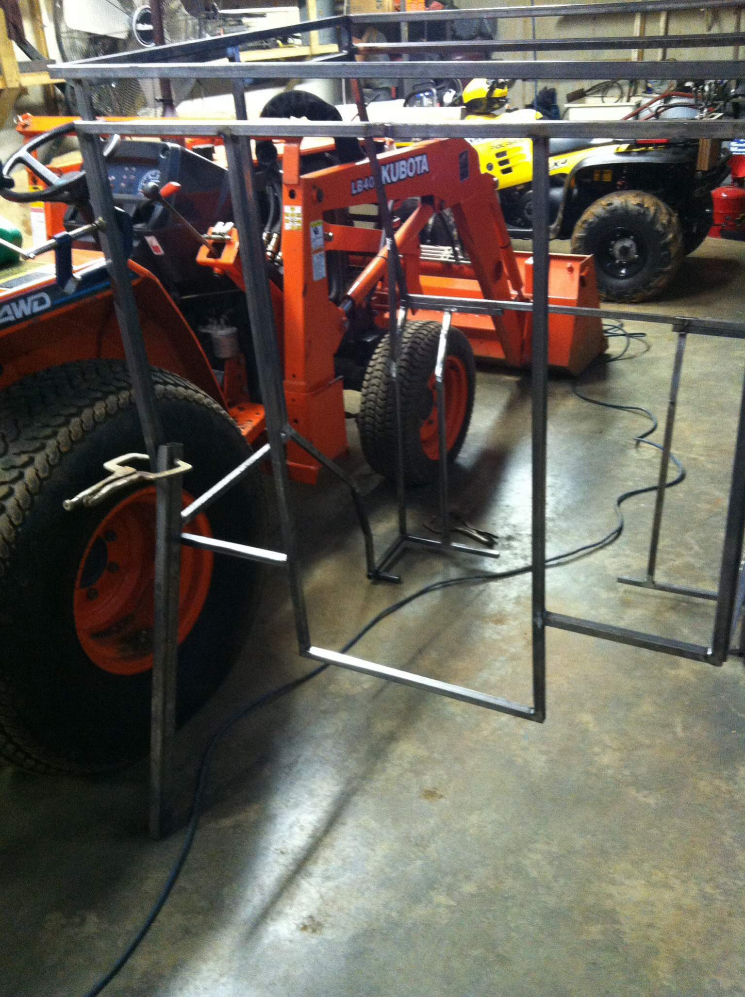

Built the rear window frame incorporating the removable center section for backhoe operation. This frame is 43" wide x 32" high with a 21" center opening.
Then made the 2 side windows 18" wide x 32" tall.

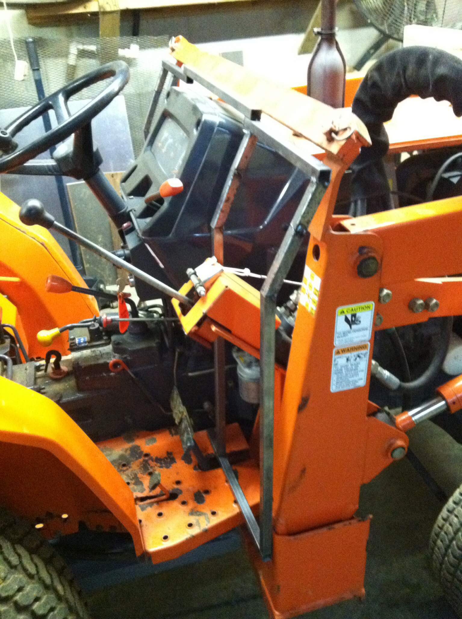

Lastly, made the firewall 24" high then imparted angles to bring the cowl forward to cover the top of the dash. As you'll see a reinforcing spar was added, this will not only add strength but allow a high location for the top hinge.
Day 2 (3 hours)

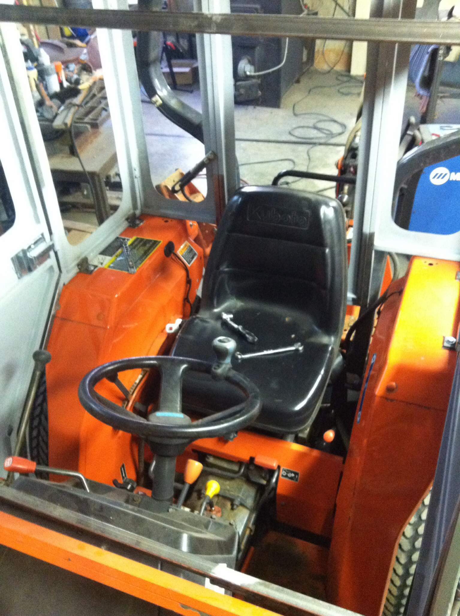

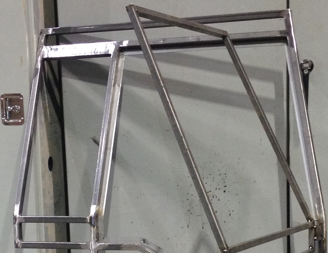

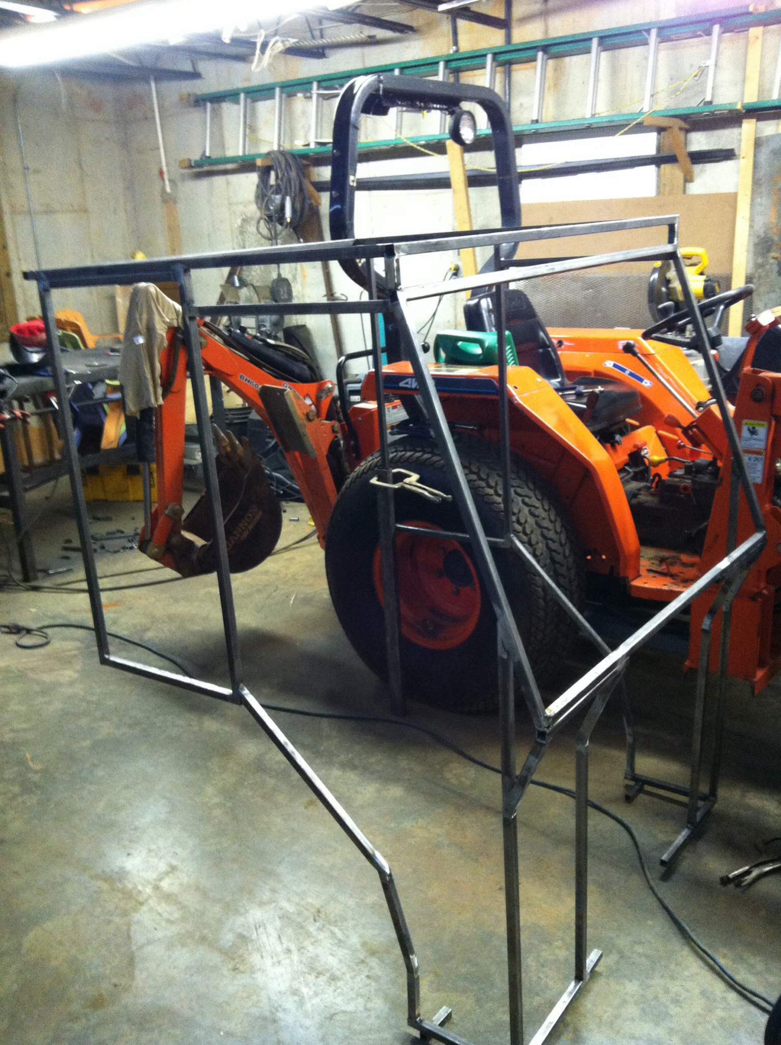

Tied the right and left cowl together and built the front windshield frame at 28" tall x 43" wide and set it at a 70* angle similar to a Jeep! It then comes up vertical for 3" or so. I then set the top horizontal distance at 37" front to back. I then tied the side windows to the front windshield at 90* to the rear door pillar. This also took a whole bunch of funky geometry out of the door as did the spar on the front. I ordered a pair of slam latches off of ebay for $16 total. I'll have to drill,tap and add an inside handle to allow me to work the latch from the inside. I still have a few welds to complete and finish grinding them flush for finishing.

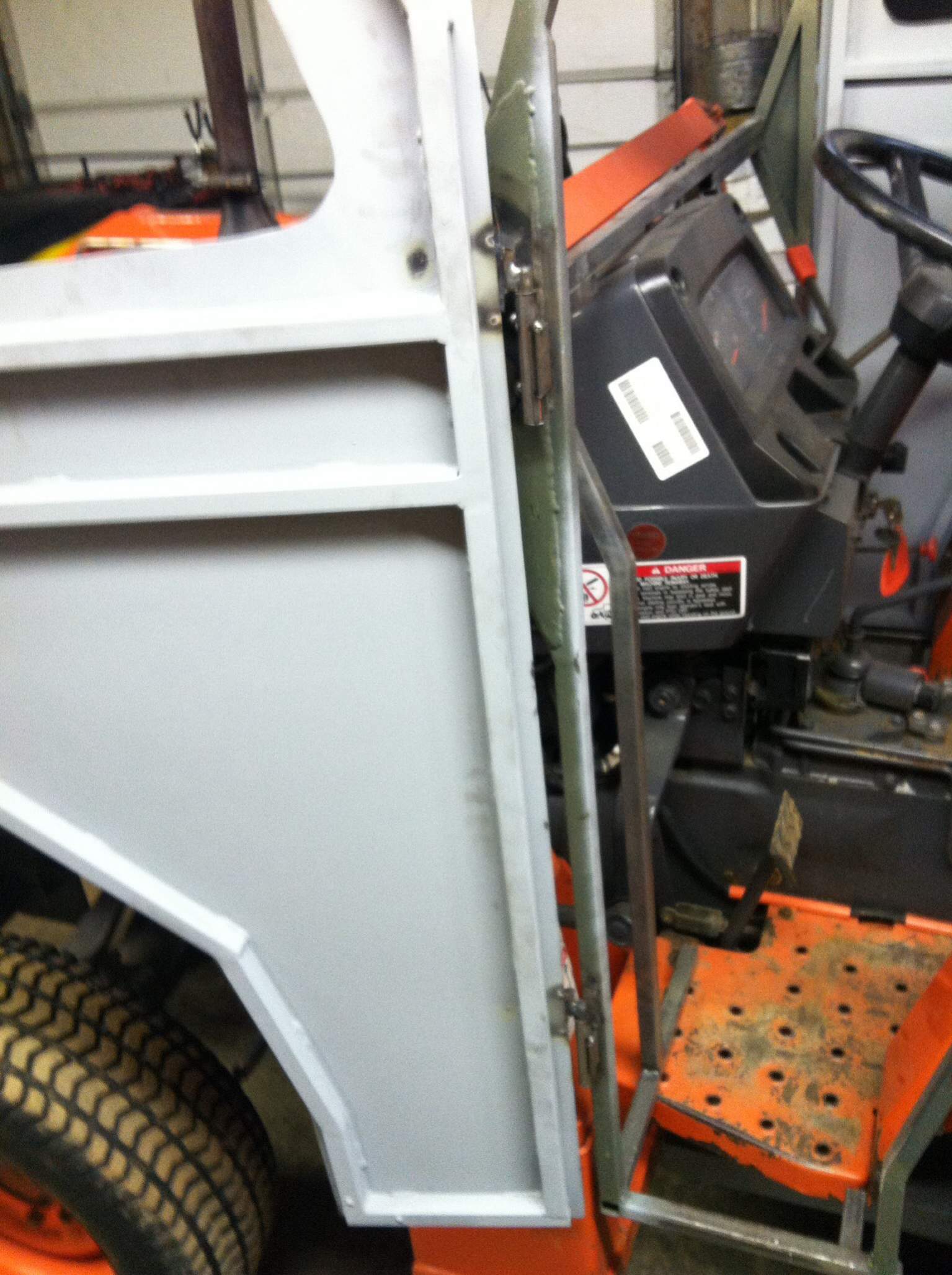

I'm not sure how I could have done anything with the door gaskets without adding a strip of sheet metal to make a flange to put the gasket on. Here's a pic with the flange. At the time it was taken, the flange was on the door frame only. The same flange was run around all the glassed openings to bed the glass. The seals I used around the doors are like the #2 or #3 from McMaster:
McMaster-Carr

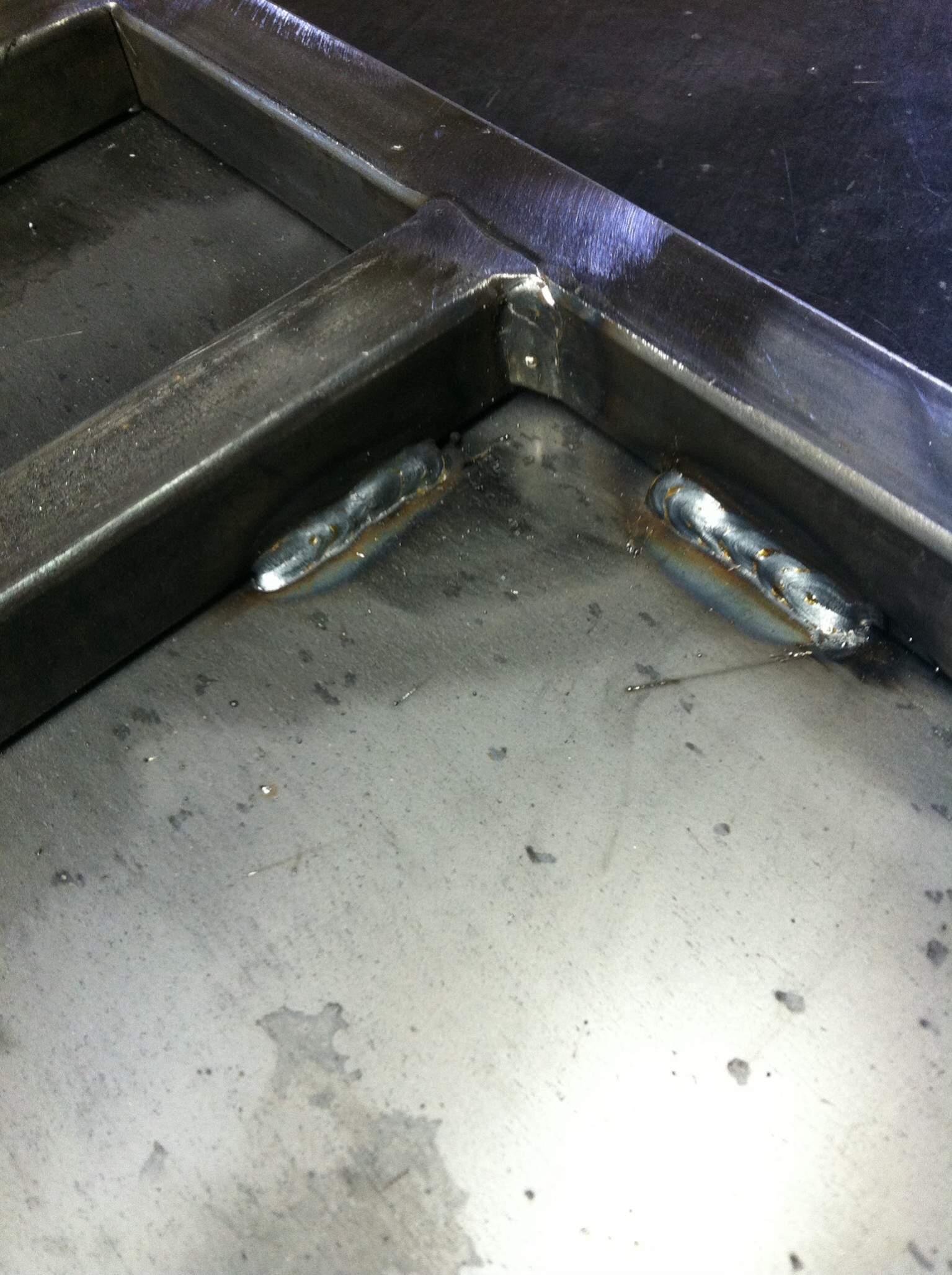

Today (4 hours)
Went over all welds and touched up, finished what needed done to them.

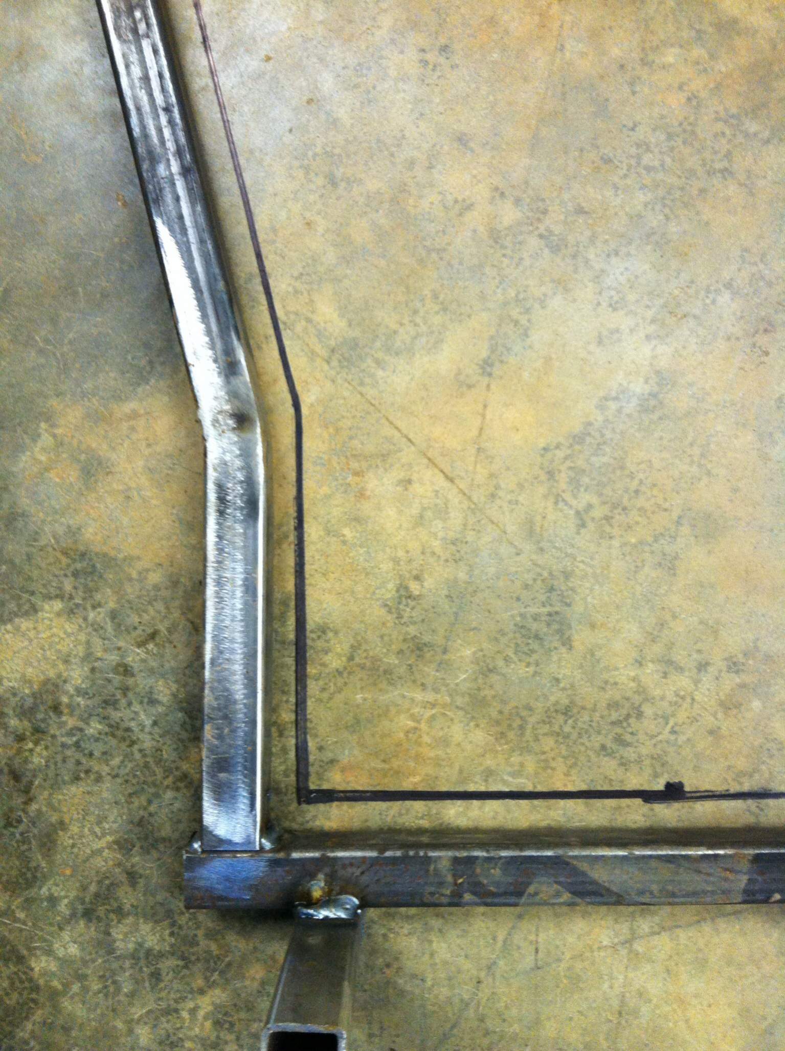

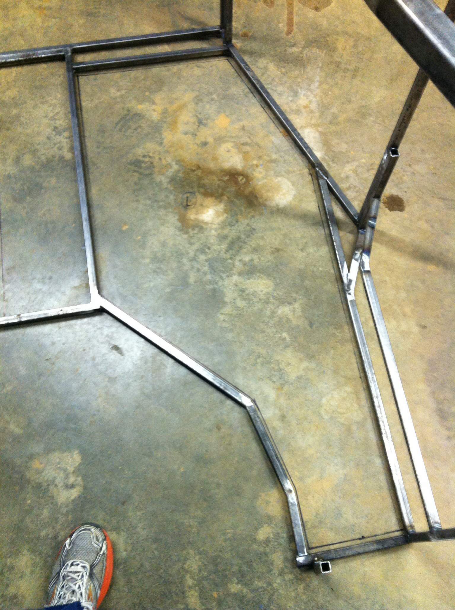

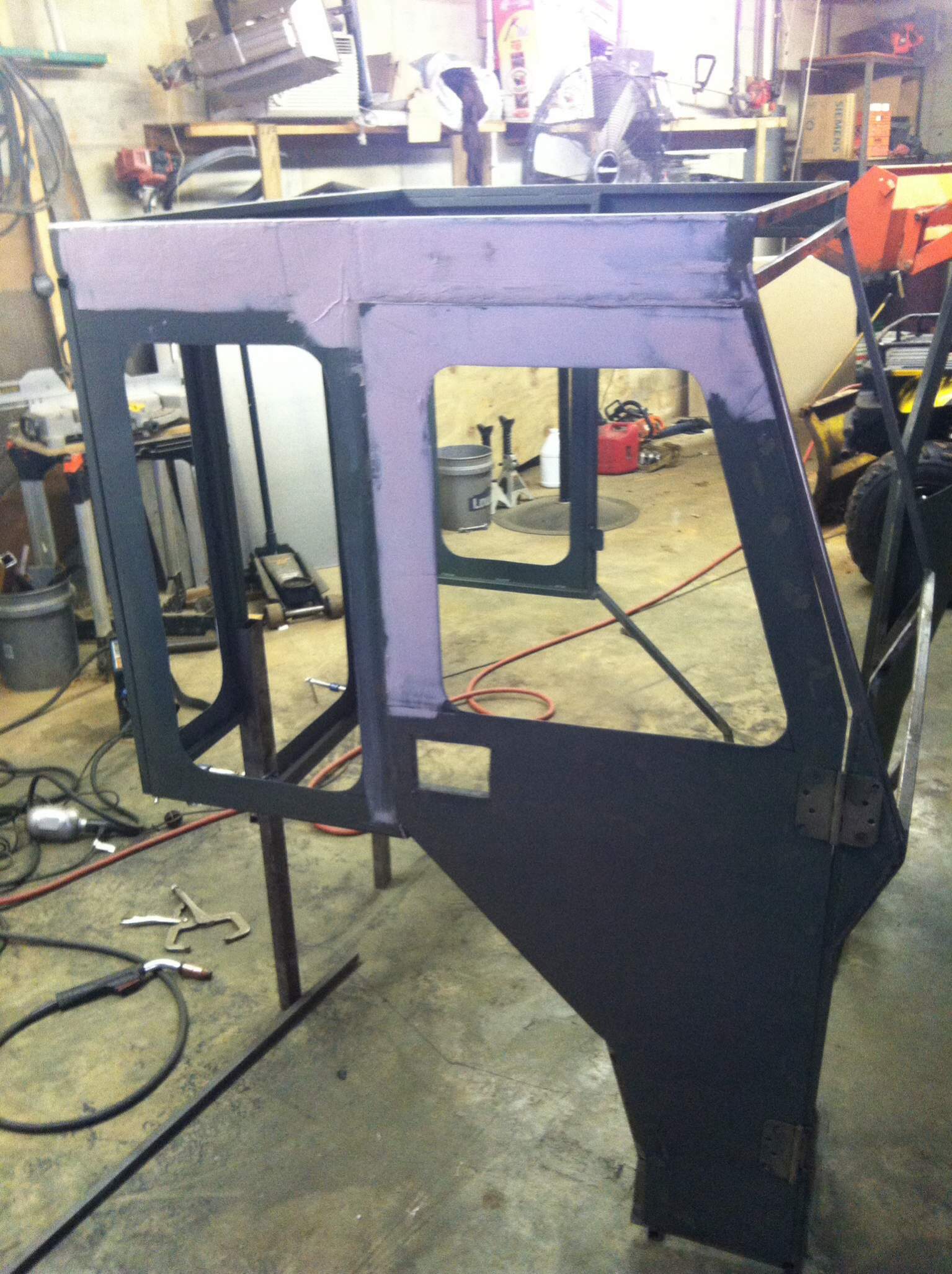

I then laid the cab on each side and traced the door opening onto the floor with a sharpie. I allowed 3/8" relief between the frame and the door. This made it super easy and relatively fast to frame out the perimeter of each door. I then added horizontal spars to accommodate the slam latches I received Saturday. Here's what that looked like
Just in case you all ever wondered what a welding elf looks like, here you go......

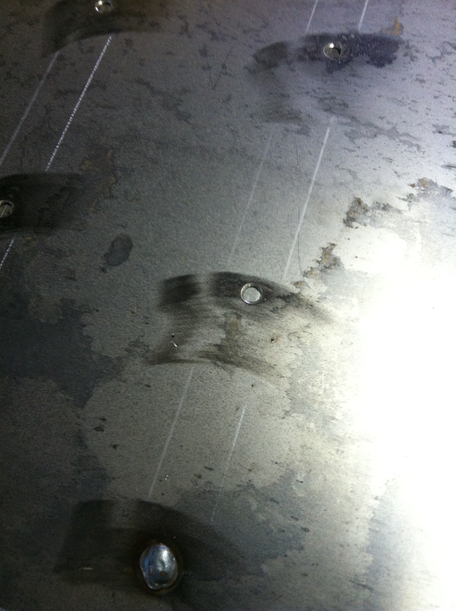

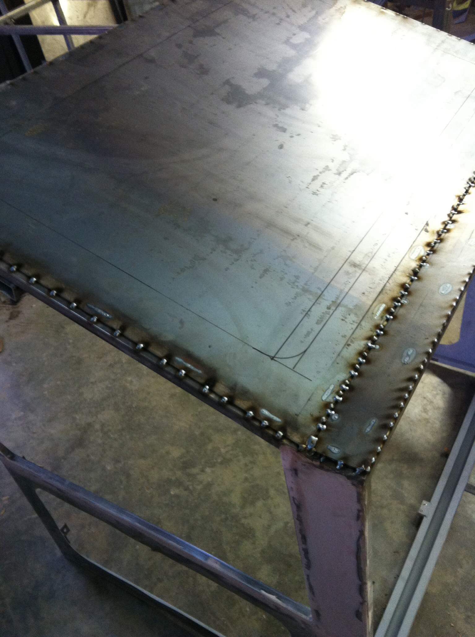

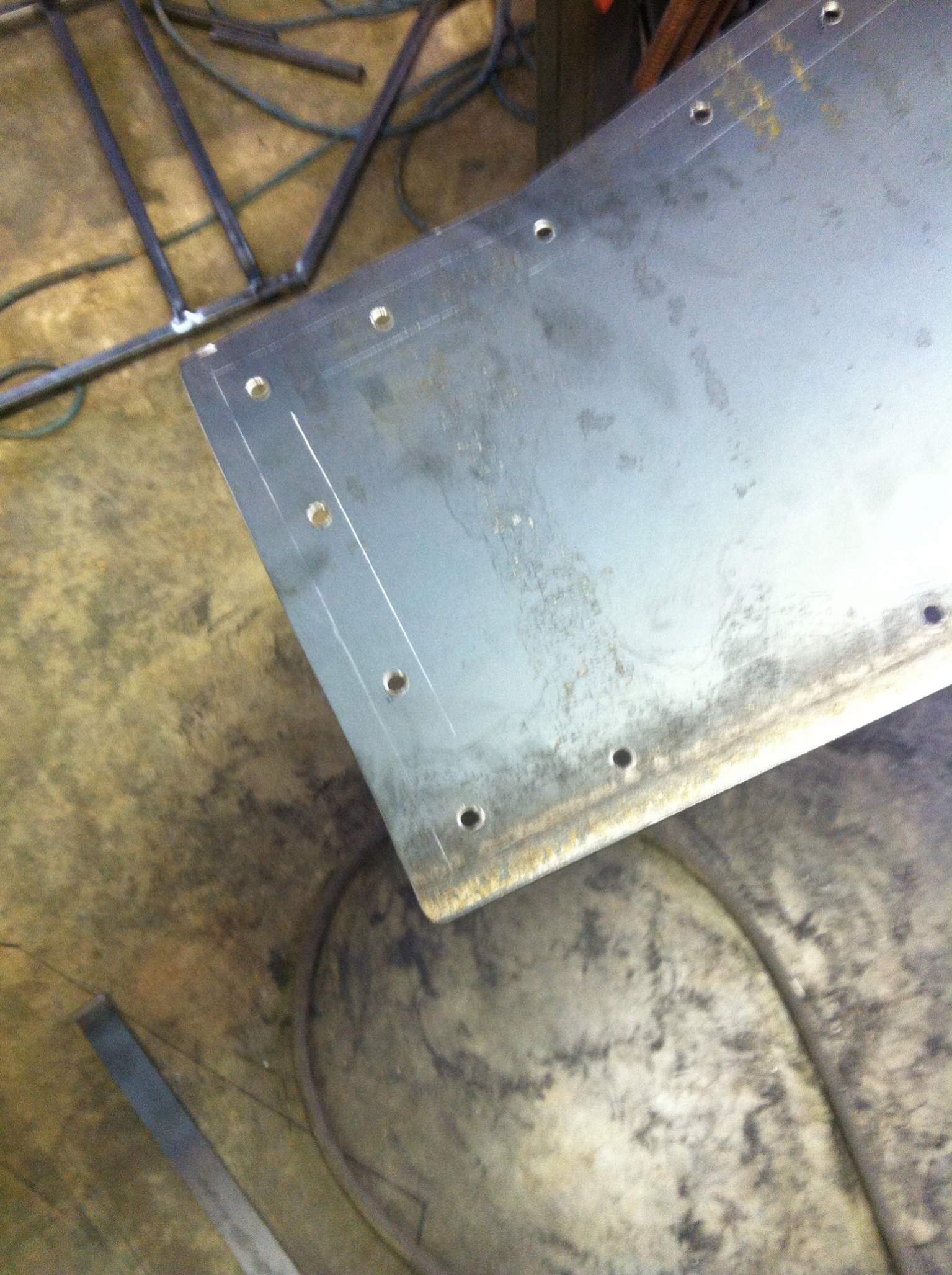

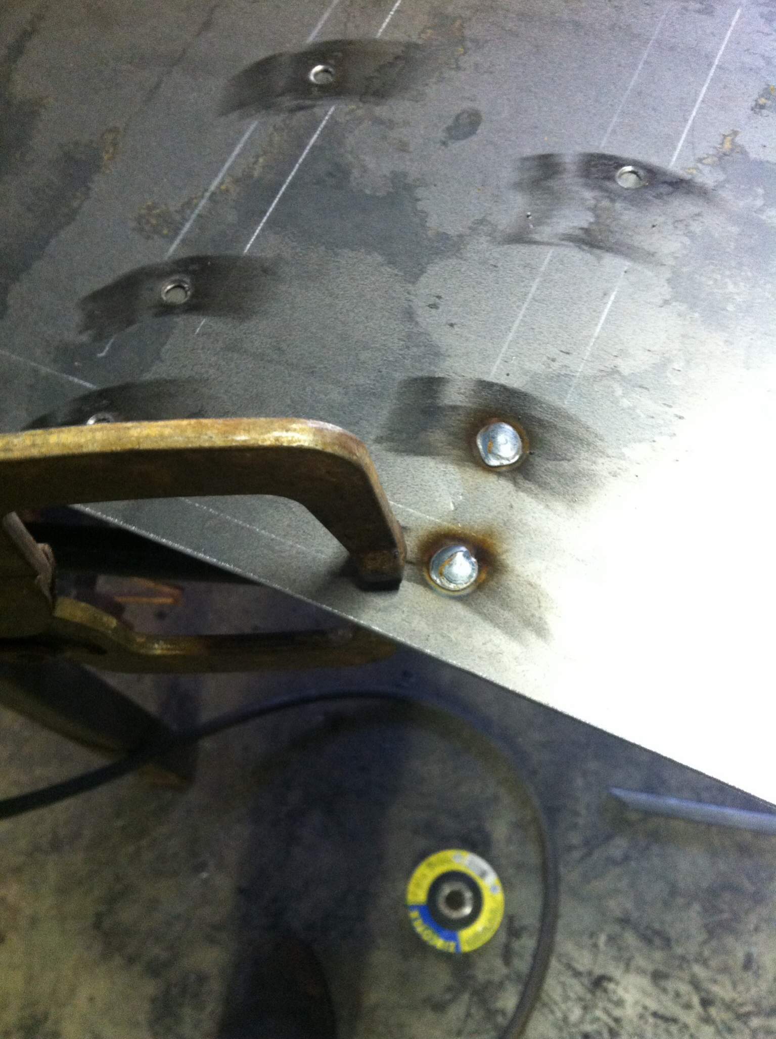

On to the tin work. I allowed an extra 1/2" overhang that I plan to add bead molding to just to finish it a little more. I drill many 3/16" holes to allow for plug welding.
Going to try and get windows cut out and sides and back skinned as soon as I can. Figured you guys might want an update and I'm gonna rest tonight. I've been thinking I might get some single stage paint mixed up in 'bota orange and try to spray this pig myself. ****, it's got to look better than using a short nap roller:laughing:

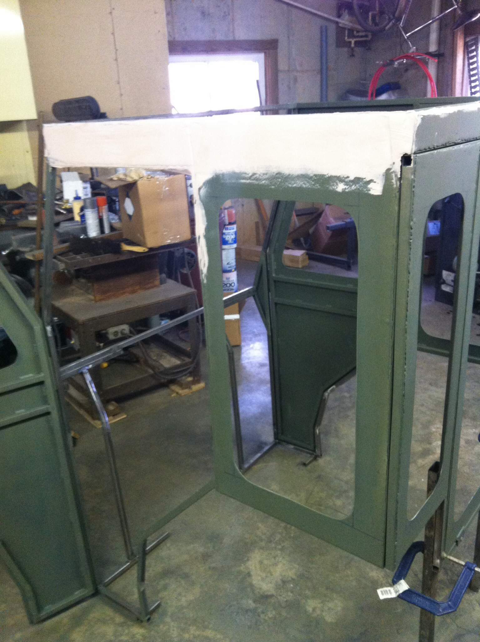

Time to get this updated. Been working off and on for the last week but more off than getting anything done. I'd estimate I've got another 10 hours in it. I've skinned out the area above the doors, the back removable panel, shot some etching primer on it, applied body seam sealer to the inside. I've got to skin out the front windshield and above it and attach all of my mounting brackets to the frame. Have got to fair out the whole thing too.........If anyone needs details don't be scared to ask.

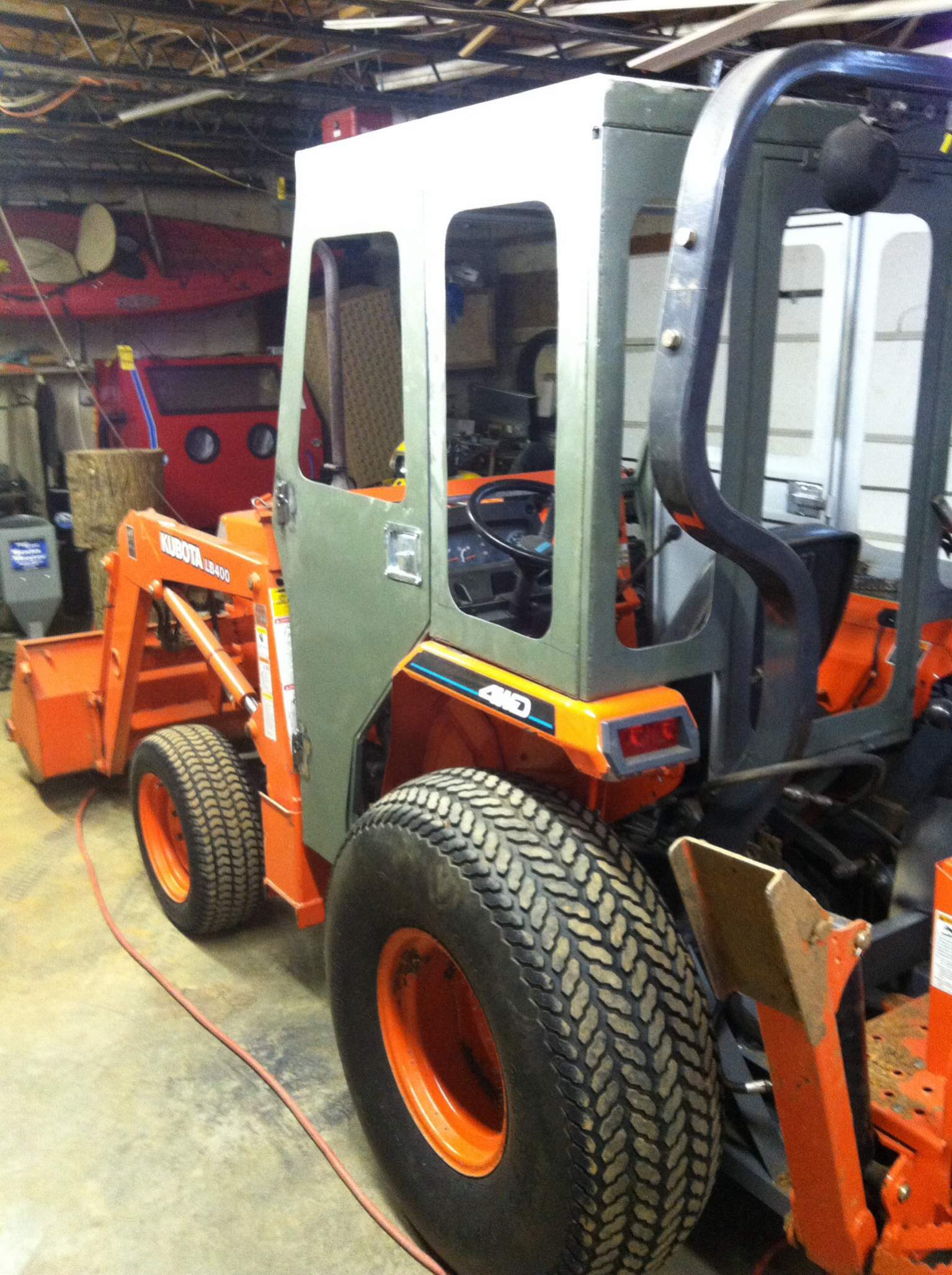

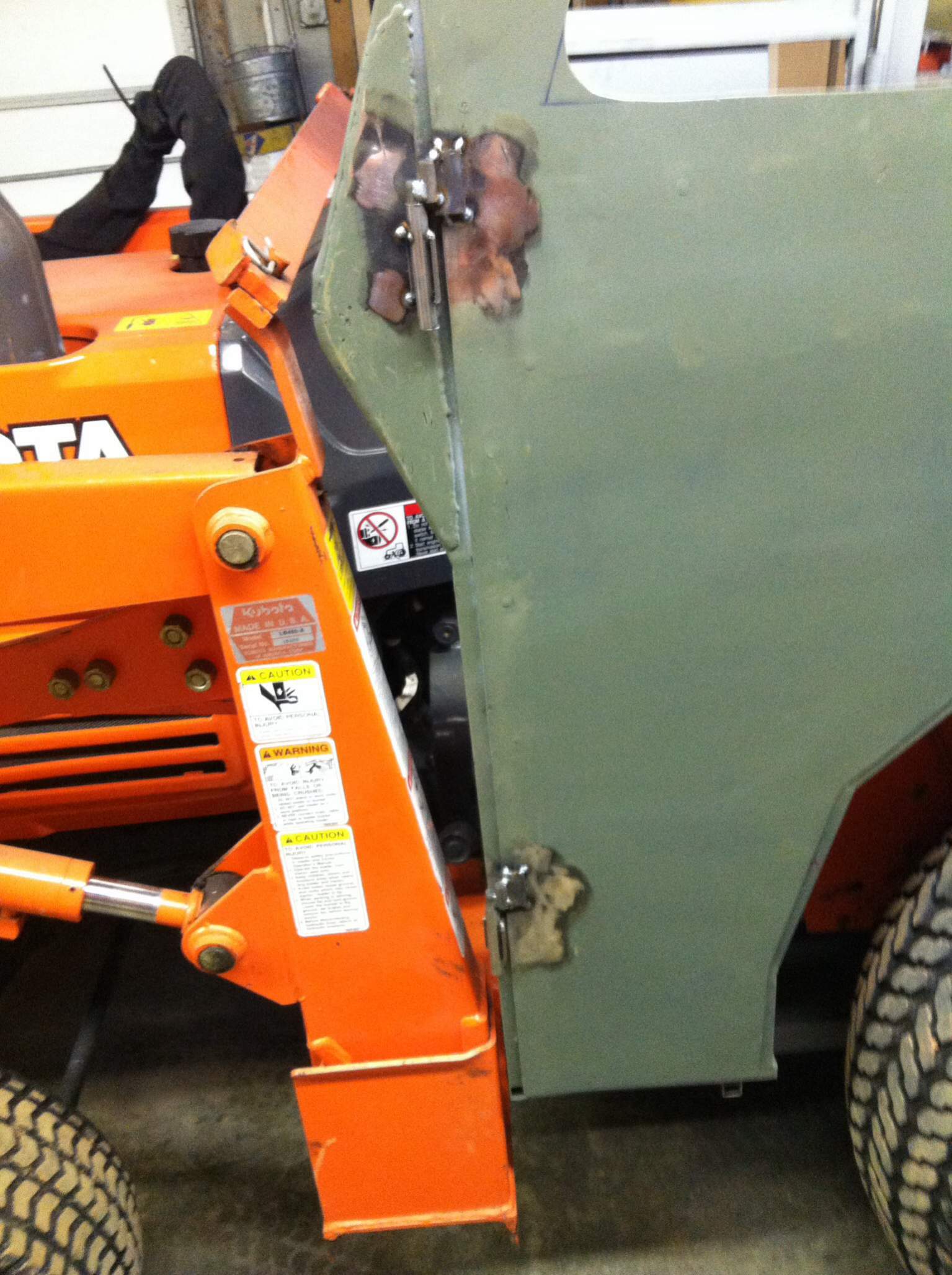

I've skinned out the front and made some hinges to replace the hoopie looking cheap door hinges I had on there. They are simple rods that fit into steel tubing. They work pretty slick and make door removal a snap. Got all the seams sealed and filled plug welds with filler and rounded edges. Also located and fastened mounts with final fitting/squaring. I've gotta get this thing in primer and put the 'bota orange on it and install the glass
I'll post a few more pics tomorrow.
