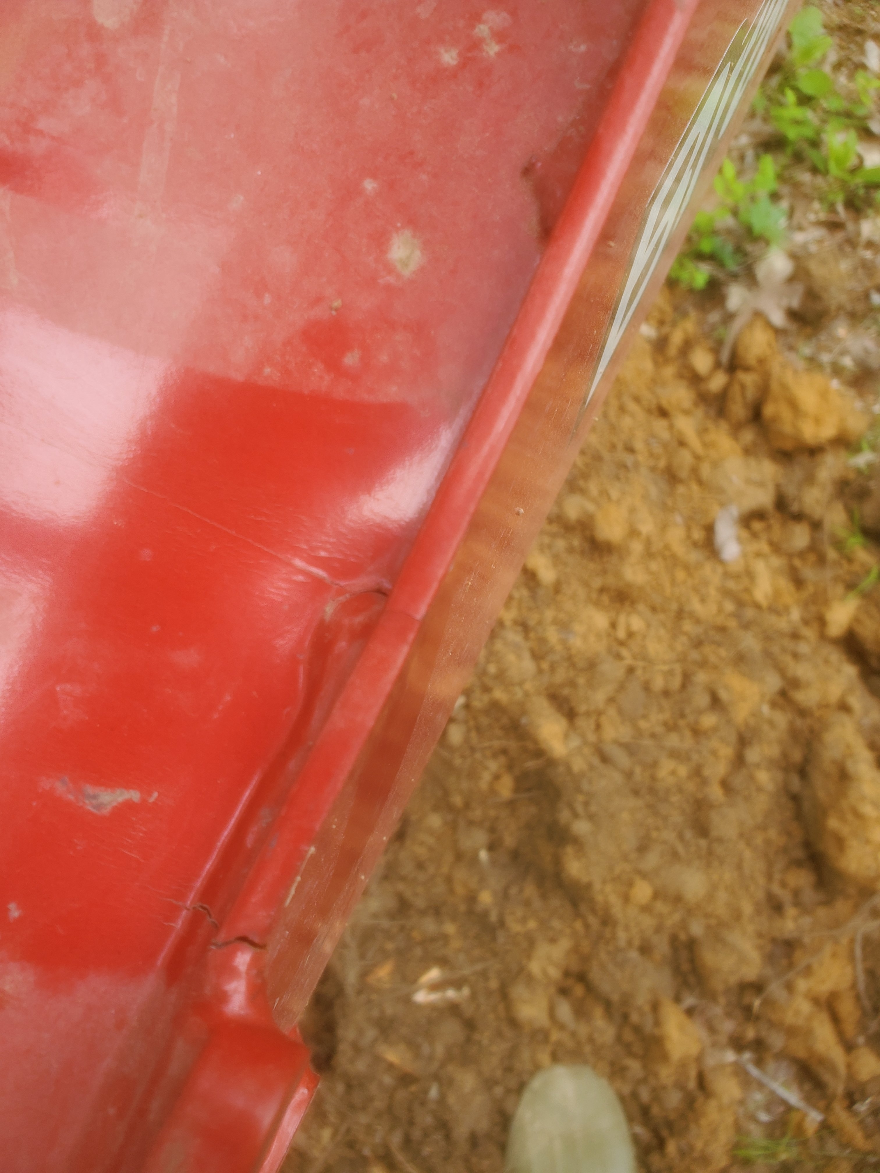

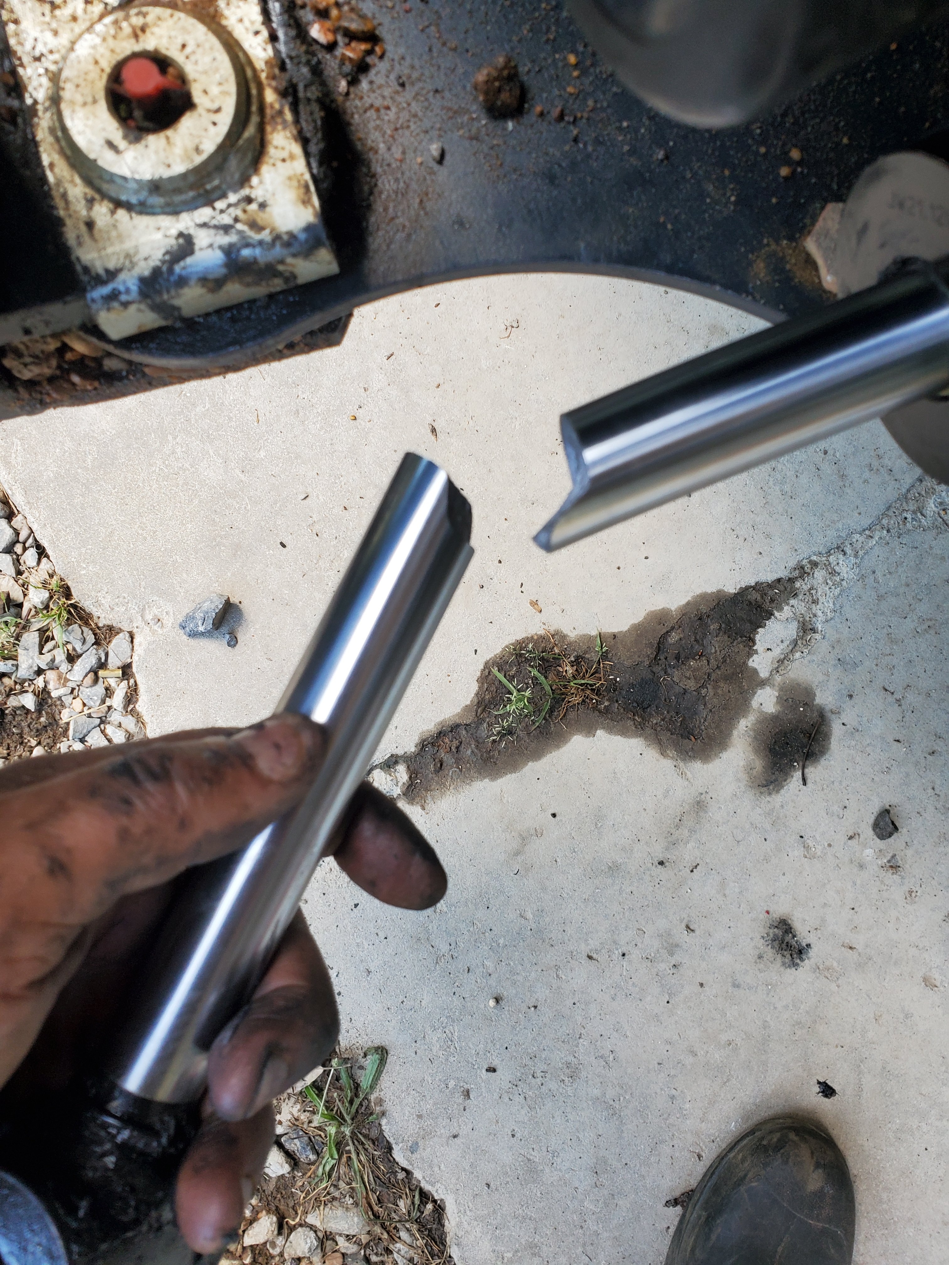

On the 100 hours the piston broke, i reported it, it was still under warranty. Dealer replaced it.

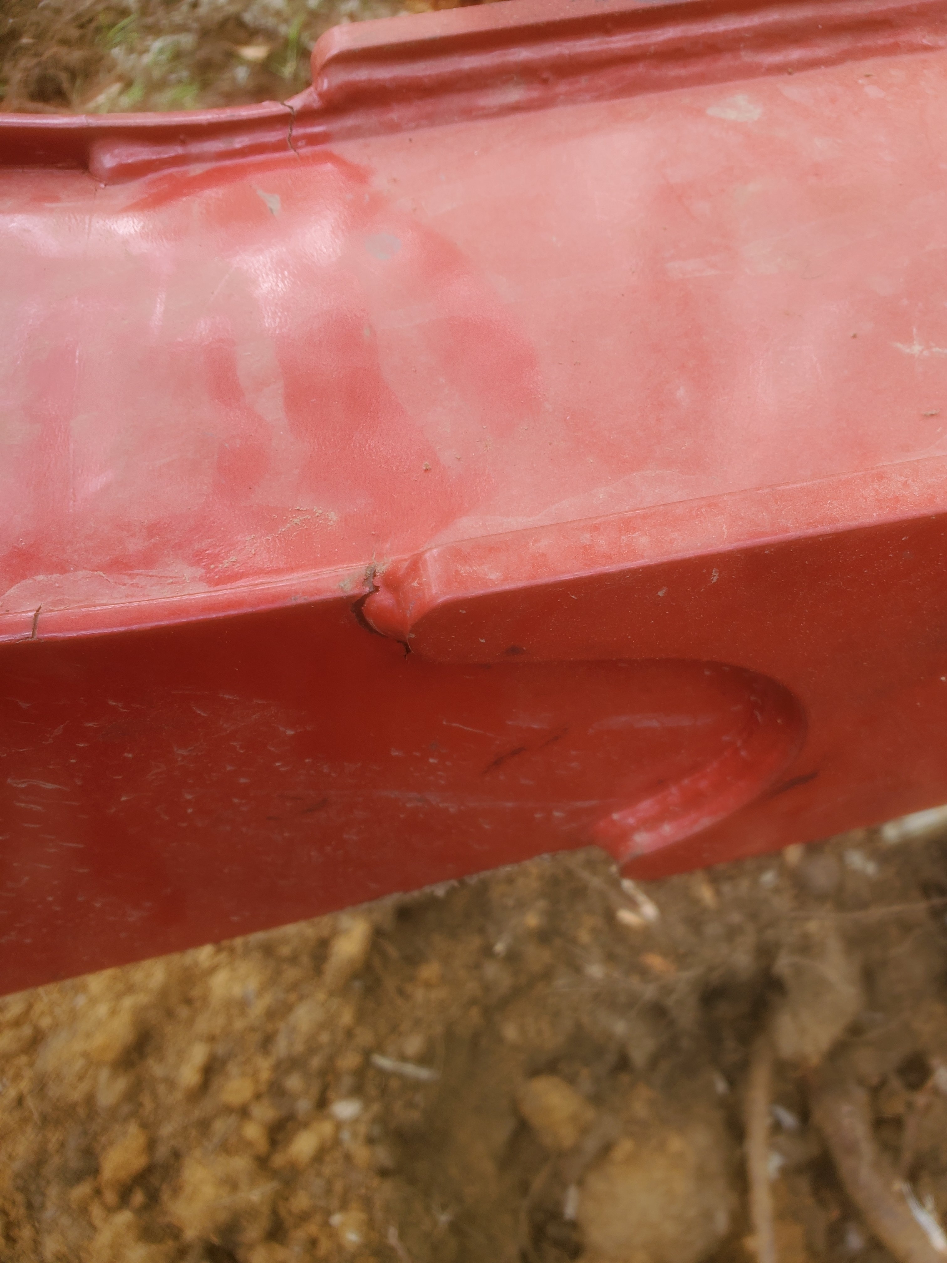

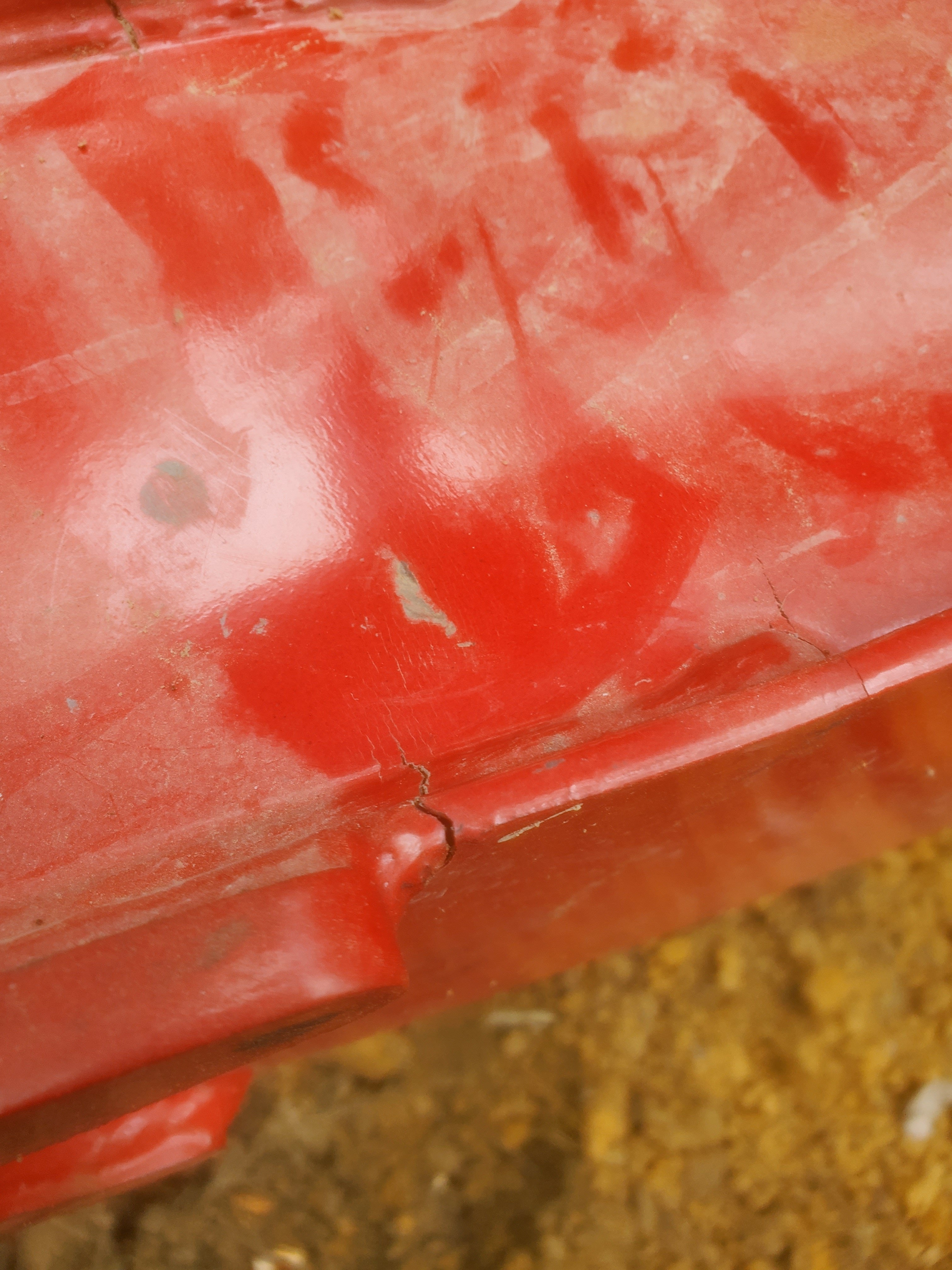

Now the boom has cracks!!!!! They beefed up the hydraulics but forgot to beef up the tractor
This is when the piston broke

The broken piece is the cylinder rod and curious what you were doing when it broke. Possible a defect in that rod from heat treat.
Hard to tell from pictures but is that just a poor weld where it is cracking vs actual metal tearing?
Not trying to make excuses for Branson, just trying to determine failure.
/ Holly F...ng Branson!!!!!!!
Nope, it is 2.5 years already. Warranty is 1 year.
The rod broke when digging a creek bed, really soft gravel. No defect was found by me nor by dealer, nor by Branson, He says he sent it there. Probably a lie as always.
The weld is bad, but the metal is torn as well. Metal cracked in two places on each side.

Sure doesn't look like a build quality problem. I mean, weld quality isn't great, but when you see metal tearing and not a broken weld, it's design issue. Material selected was too thin for the task.
The broken cylinder rod is interesting. When heat-treated hard, they fail easily under tension, not so much under compression. But of course the curl operation has them under tension, so I'd guess there must be some pretty critical specifications on the heat treating and annealing process for cylinder rods used in curl positon, and maybe this one did not get manufactured according to that spec? Could also be a design issue, if rod diameter is insufficient, but then you'd be seeing Bransons losing curl cylinder rods all over this forum.
