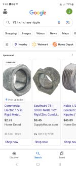

Half inch hole use an electrical chase nipple with a lock nut and bushing. Home depot.
