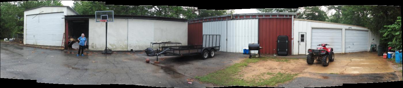

I've a workshop that's 40'x60'.
It's the building in the middle with the red side and white doors, with the trailer parked in front.
I'm wanting to put in a Hoist/ Bridge Crane/roof support using adjustable building columns (like Shop Tapco 12' 3" to 12' 7" Steel Adjustable Building Column at Lowes.com ).
Purpose would be twofold - to add support to a poorly built roof and to support some type of beam so I could throw a chain hoist over it to unload things, like furniture, woodstoves, engines, maybe a ton of bricks, off my dually.
I planned on tying it in tight with the roof trusses and concrete floor. The columns spec at a 13K load. The doorway span is 20'.

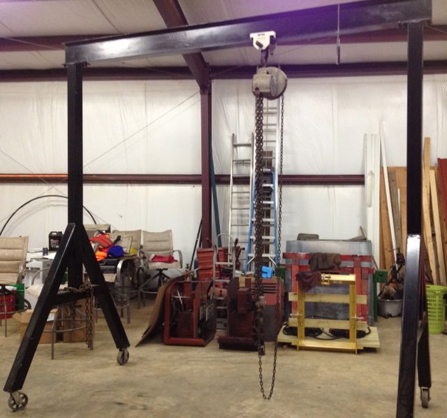

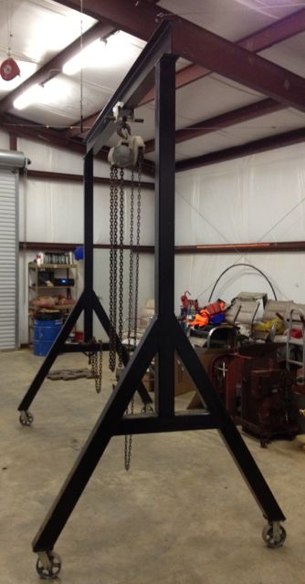

Here's the one I built. Ten foot vertical clearance and nine feet between the uprights:

An engineered wood beam will be deeper than a steel beam. Some pictures of the inside and where you want to put the roof support/crane would help us out.
