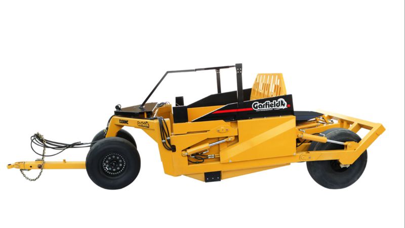

These may be too big: 550

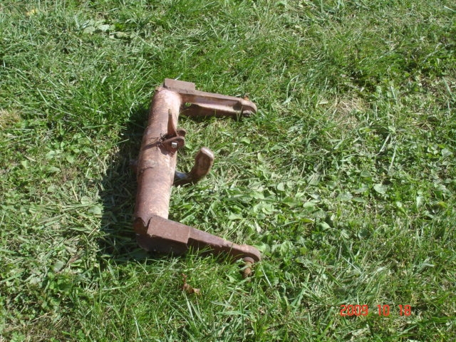

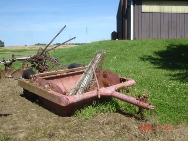

This may be more what you have in mind. Name brand is Overland Scraper. It was made in California, and made to be pulled with N series Fords. It holds approx. 1 yd. of dirt heaped. I have pulled it with my Super C Farmall, barely skimming to fill it. All my Ford 2000 wants behind it. I had an old Farmall M with a M&W .060 over bore kit in it, and 3 pt., and 200 lbs. of front weight, that pulled it best. I pulled it with the Massey 180 I had, and hooking in too deep, I rode with the front wheels off the ground about 18", until I stopped & backed up, and lifted it some. With no trucks under the front end, and a lot of draft, you can be looking up at Jesus, in a heart beat.
I have a Fast Hitch subsoiler for the Super C's, that I rip 8" to 10" deep, about 18" apart, then just try to cut 2" at a time with the scraper, and it will fill it, running over pretty quick. I've moved a lot of dirt with it over the years. When dumping, you have to trip it, then lower to get the cutting edge to catch enough to roll it up in the dump position, then raise a bit. It has a notch in the 1/2 dump position, you can grade your fill with. Does a dandy job of grading the drive too, cutting the high center, and spreading to the low spots.
