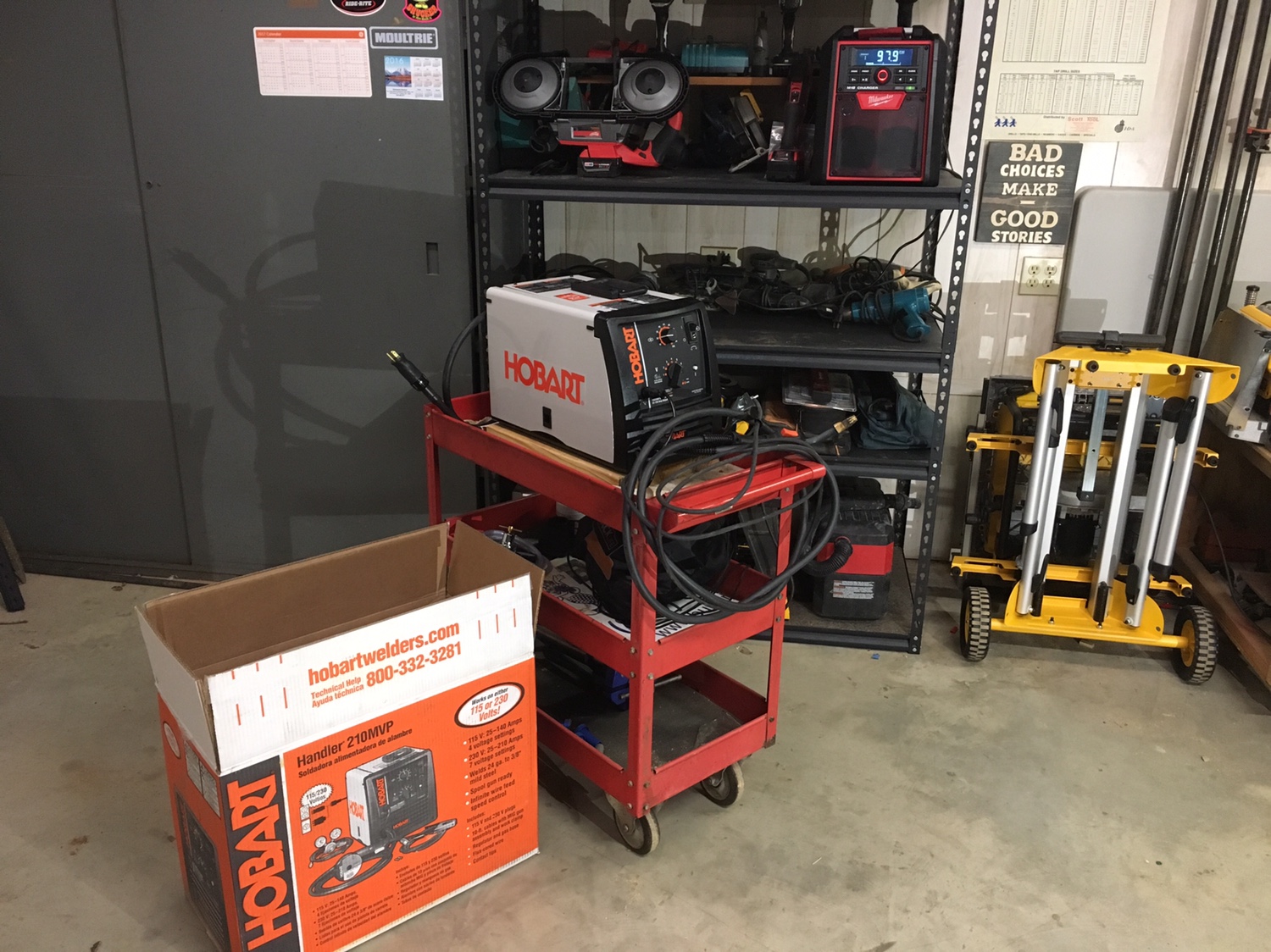

Thanks all!
I got it today and unboxed it and you all are right about it being a pig at 80 lbs. I was going to be smart and set it on my old HF cart then found out I couldn't reach the far side of the trailer I wanted to work on and had to lift it off and set it on the trailer. It is all there for sure.

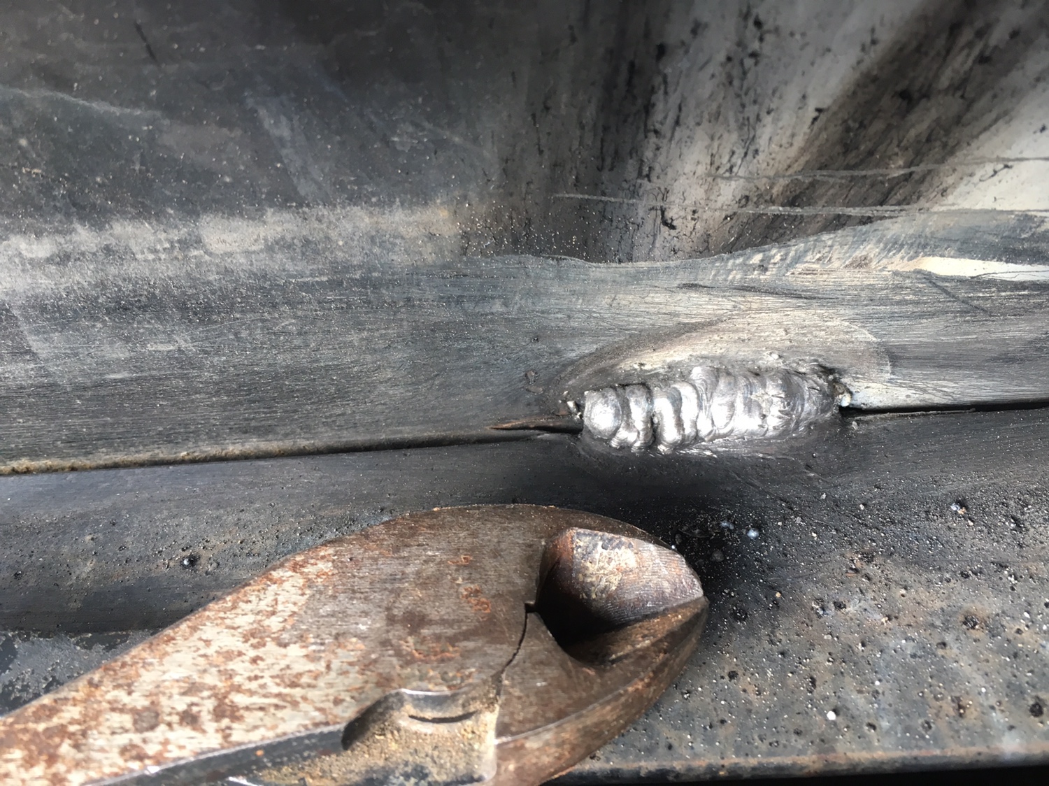

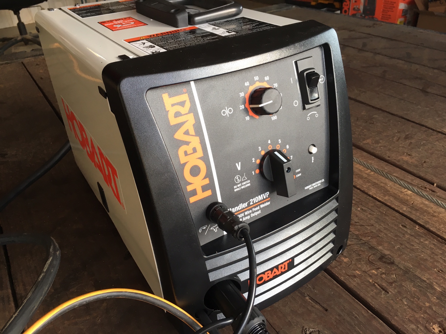

I set it up 110 with the supplied .030 flux core wire and got after those loose inner fenders.
First welds weren't the greatest and I only welded over the old welds that had come loose from the sheet metal. But it stuck. And paint'll help.
I was running a voltage setting of 4 and 20 on the wire speed. Managed to get bacon sizzling pretty easily. But my bead techniques need some more practice! IMG_2278.JPG
That's the only one you guys are seeing for now.
Really happy with it. Got to get the gas and some of the 023 wire aforementioned and a 220 volt receptacle when I head into town eventually.

Crank up the amperage a bit more, that weld looks like it's sitting on top with little penetration. Be patient, you'll get it. Just because the welder sounds happy doesn't mean that the weld is sound. Check out weldingtipsandtricks.com for a lot of good, free info, as well as the guys here are pretty great. I got my HH210 the year before they came out with the MVP (dang!), and I still love it. It does everything I need, just make sure you run good wire. I've never had a problem with Hobart wire.
As someone else mentioned, keep .023, .035, and .035 Fabshield 21b on hand. Welding in the wind SUCKS when your shielding gas blows away. I got tired of makeshift windblocks so I started using 21b a lot more. Don't be afraid to burn through a few spools of wire just to practice! Every bit helps!

I have that exact welder. It welds much much better hooked up to 240V vs 120.
