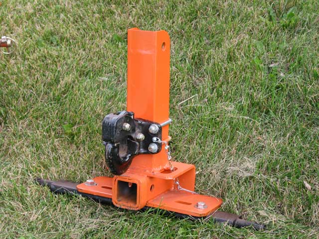

Well this is the first try at posting a pic, and since there has been a fair amount of chatter about them I thought I'd show my solution. The receiver now only gets one of those hitch baskets that goes on the back of trucks and cars. Since I can't manage to have only one hitch size in the yard, I thought this would cover it all and I can trip it while sitting on the bx. I can back up to the small trailer, boat trailer, enclosed car trailer or move the neighbors equipment trailer (you know the big doughnut) and don't have to think about what I need. hope it goes though and sorry about the long winded part of this.

Is that a "bumper mount" receiver inverted on a drawbar? Very nice solution!

Yes, good eye! Went to tsc and snooped around and the slots in the hitch would let it line up with my draw bar. I already had a piece of steel from a tailer that I wasn't in use that also happened to be the same size as the pintal hitch that I bolted on. If I had a full size tractor I would have used a heavier walled steel for the upright. Also, I welded the vertical tube closed so its boxed in and wont fill with water.
Thanks for the compliment!

Very nice, something for me to put together this winter for sure. Thanks for the picture.
