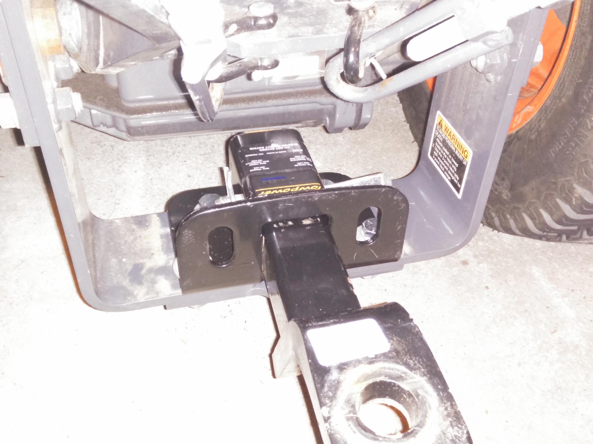

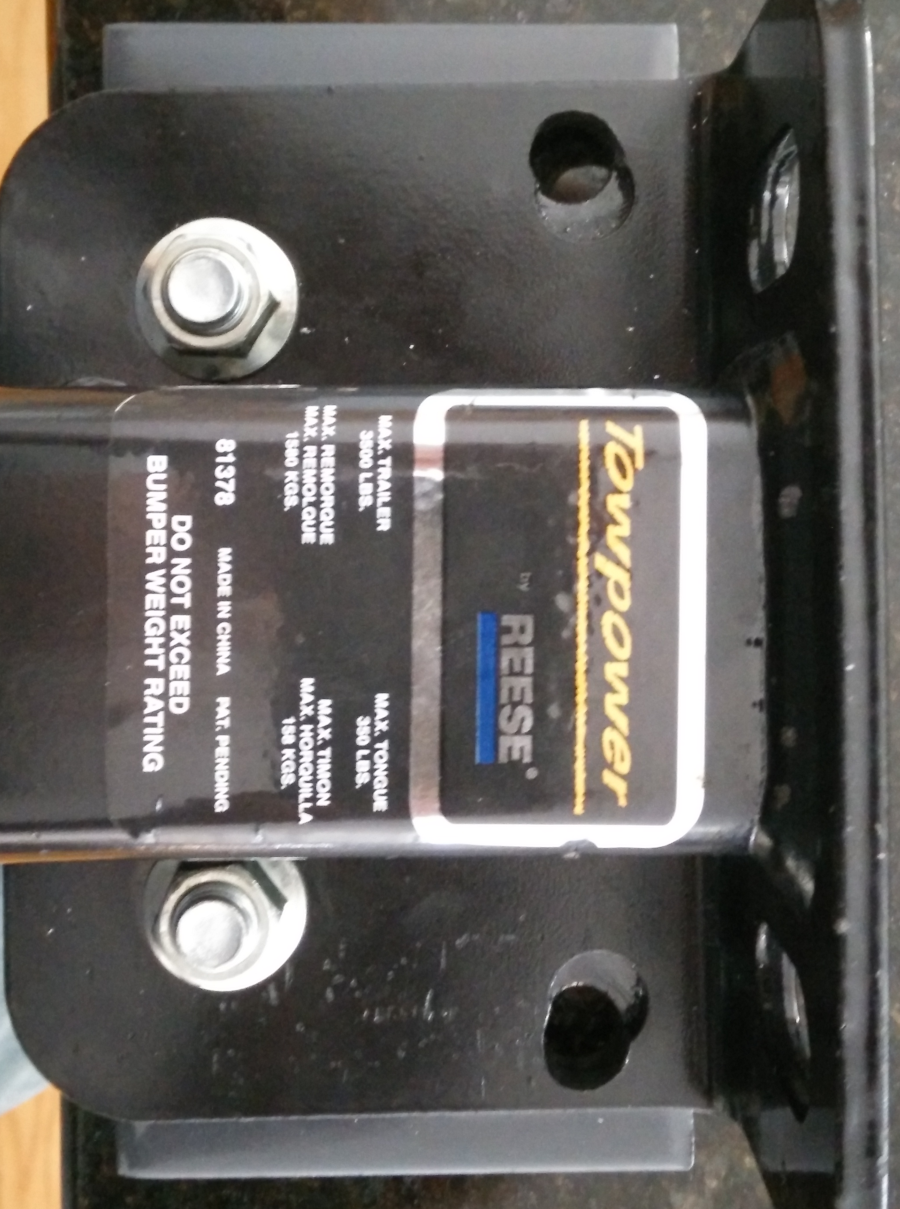

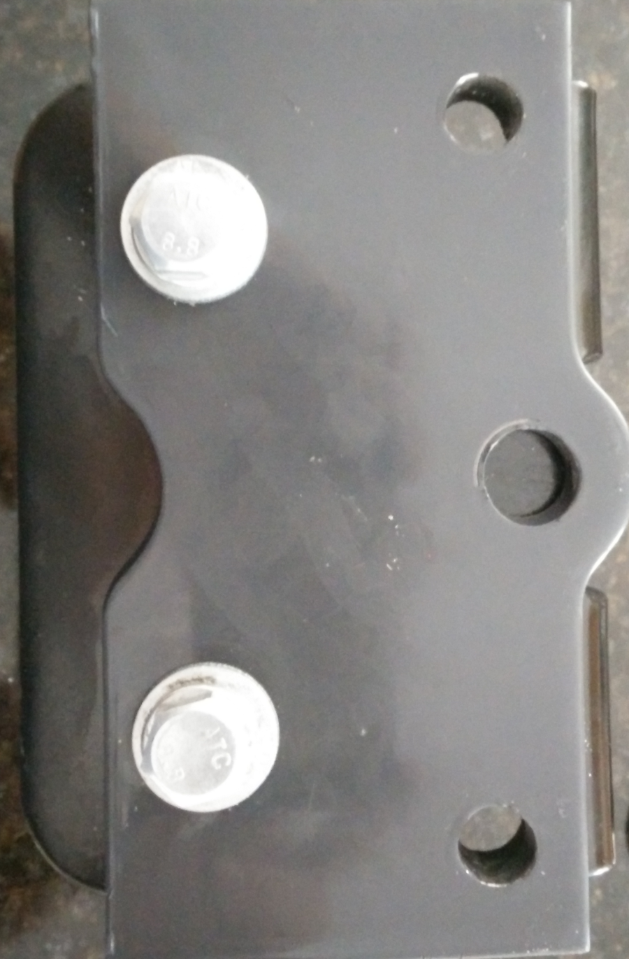

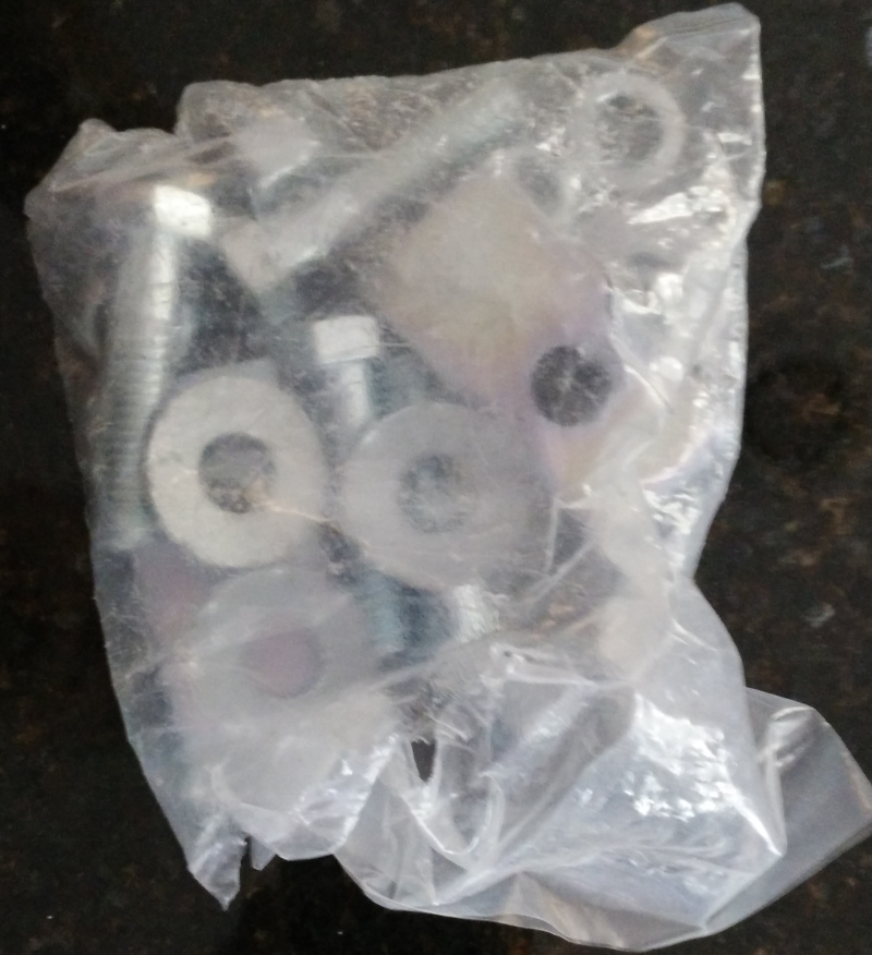

I know folks have had success with bumper receivers from harbor freight. I found this one on amazon for similar price, twenty dollars and change and free shipping if you have prime. What I liked about this one is that it had a smaller footprint but it was still a 2 inch receiver. It worked out really good because two of the bolts fit the BX exactly. The other two had to be drilled a little. The hitch also came with hardware and the bolts were long enough so I was able to put the original Kubota plate on the bottom for extra reinforcement. Here are some pics.

Forgot the pic of it mounted on the tractor

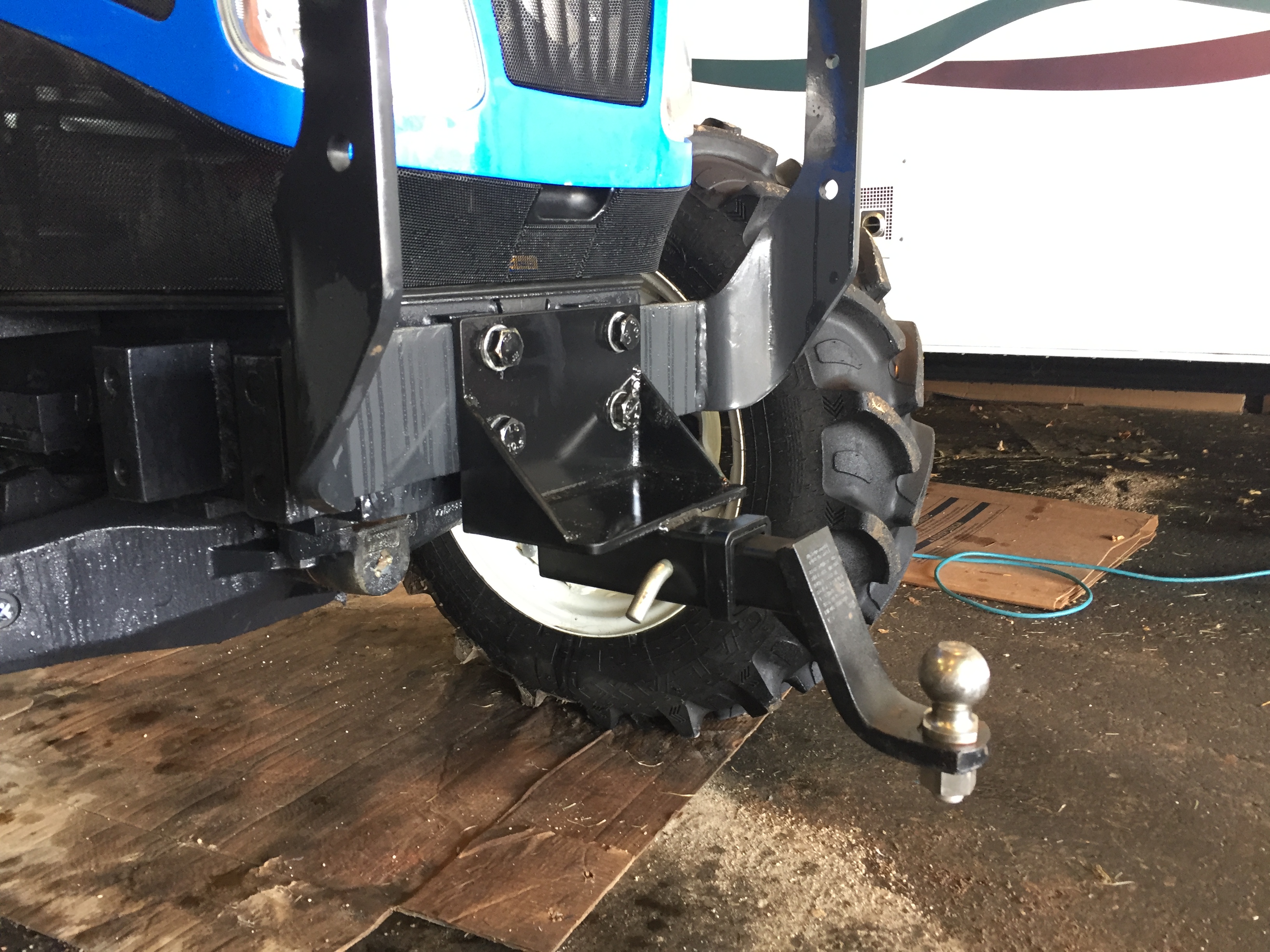

   / hitch receiver for BX #5
Here is my front mounted hitch. They are great for moving things into tight spaces. You have much better control over a rear hitch.
