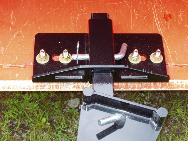

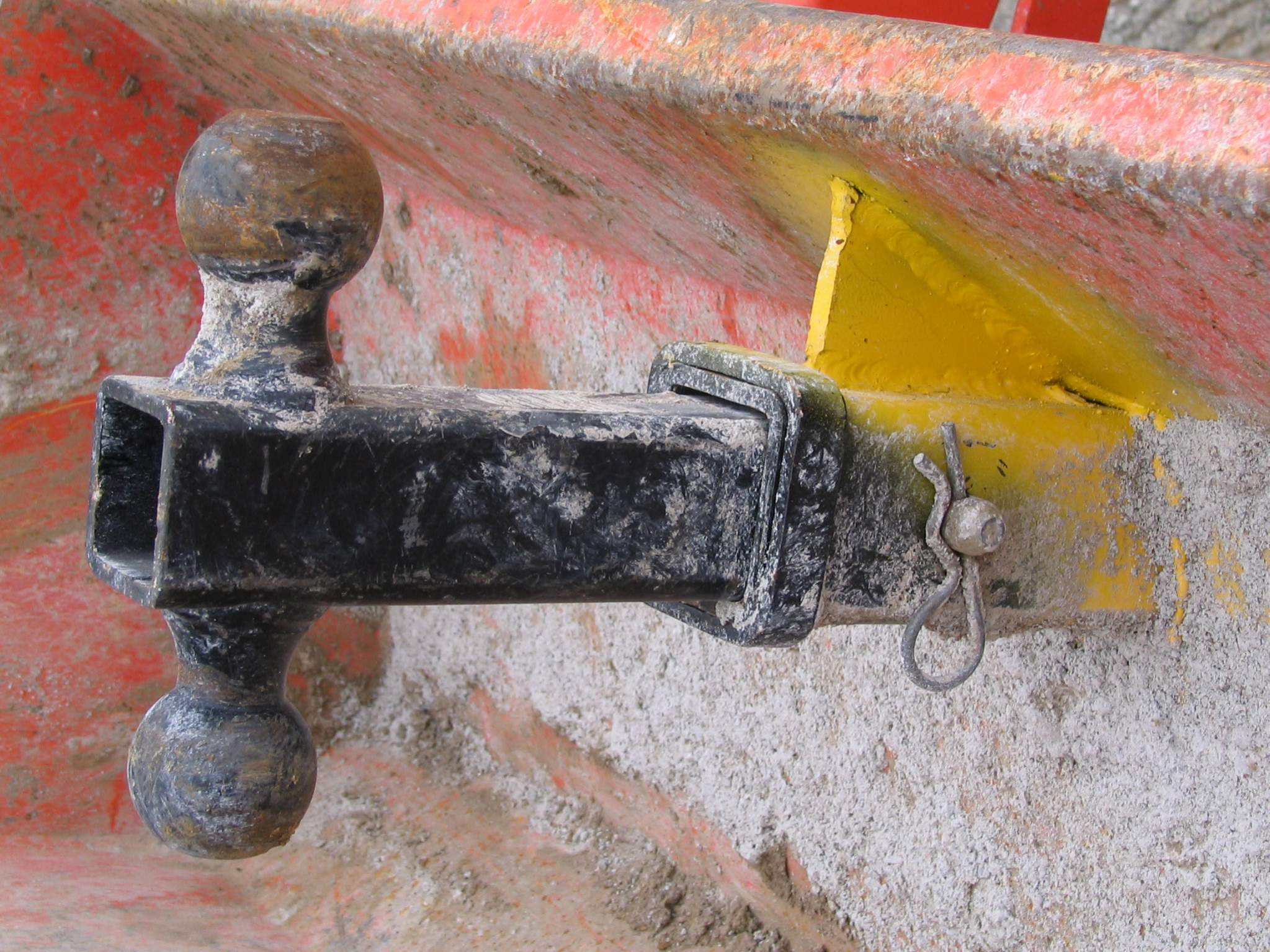

on the cheap- get a step and tow receiver hitch for around $35 in any auto parts store.
Turn it upside down in the front of the bucket and secure it on each side with a beefy C-clamp.
Then use your regular 2" insert with drop/rise, whatever.
I'm bolted on in the pic, but 2 C-clamps will do the job you need.

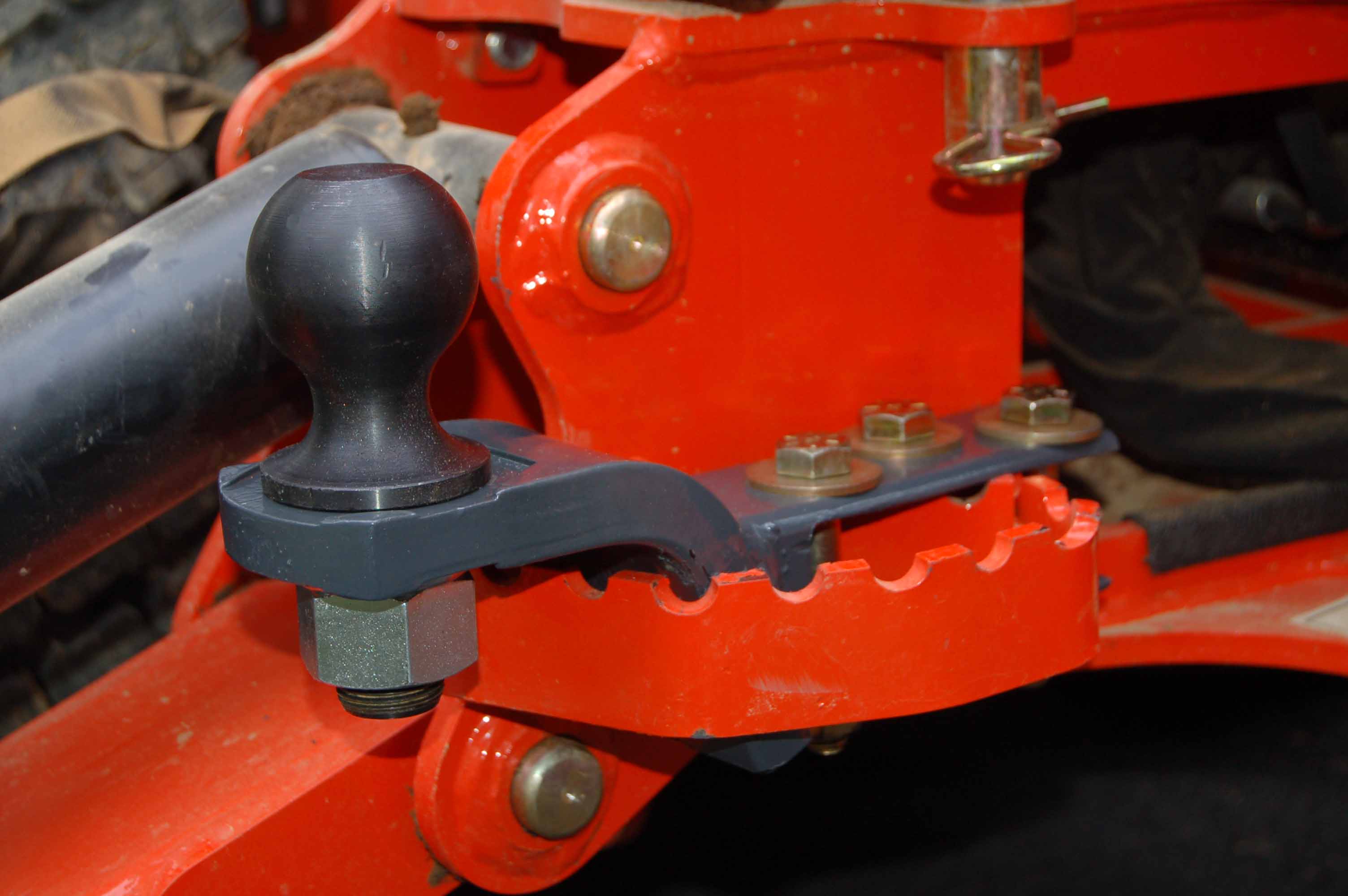

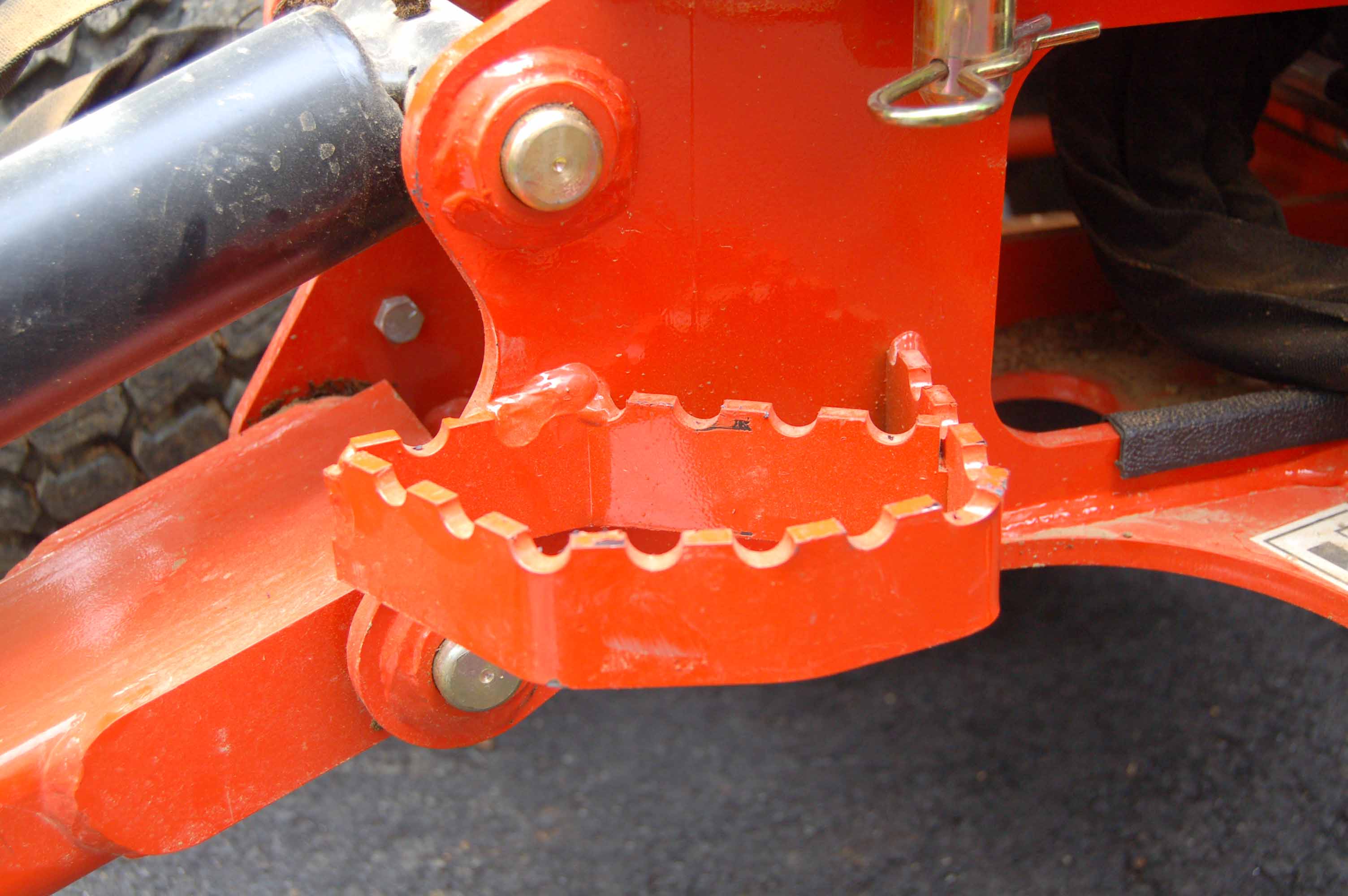

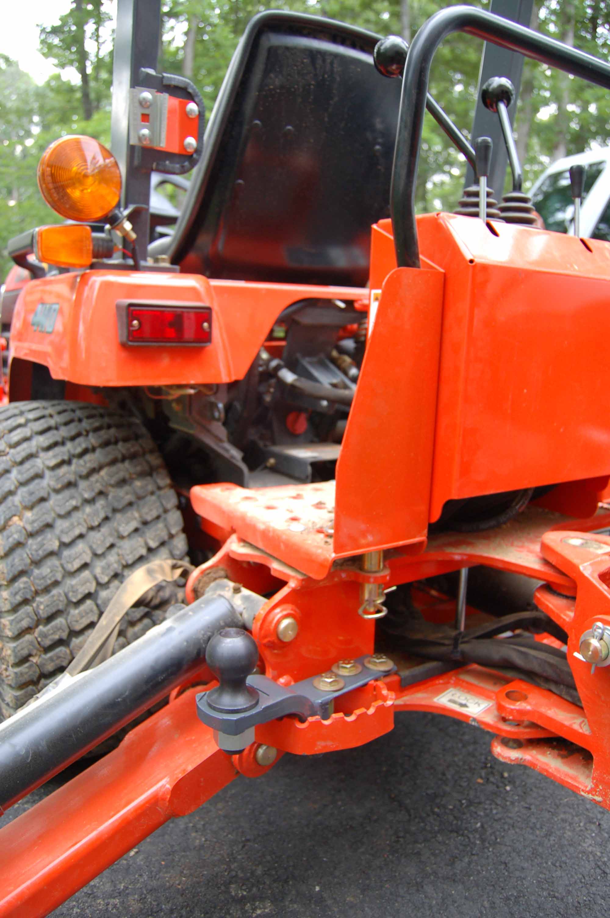

Or you could mount a ball on the backhoe step as one TBN member KeithInSpace did as pictured here.

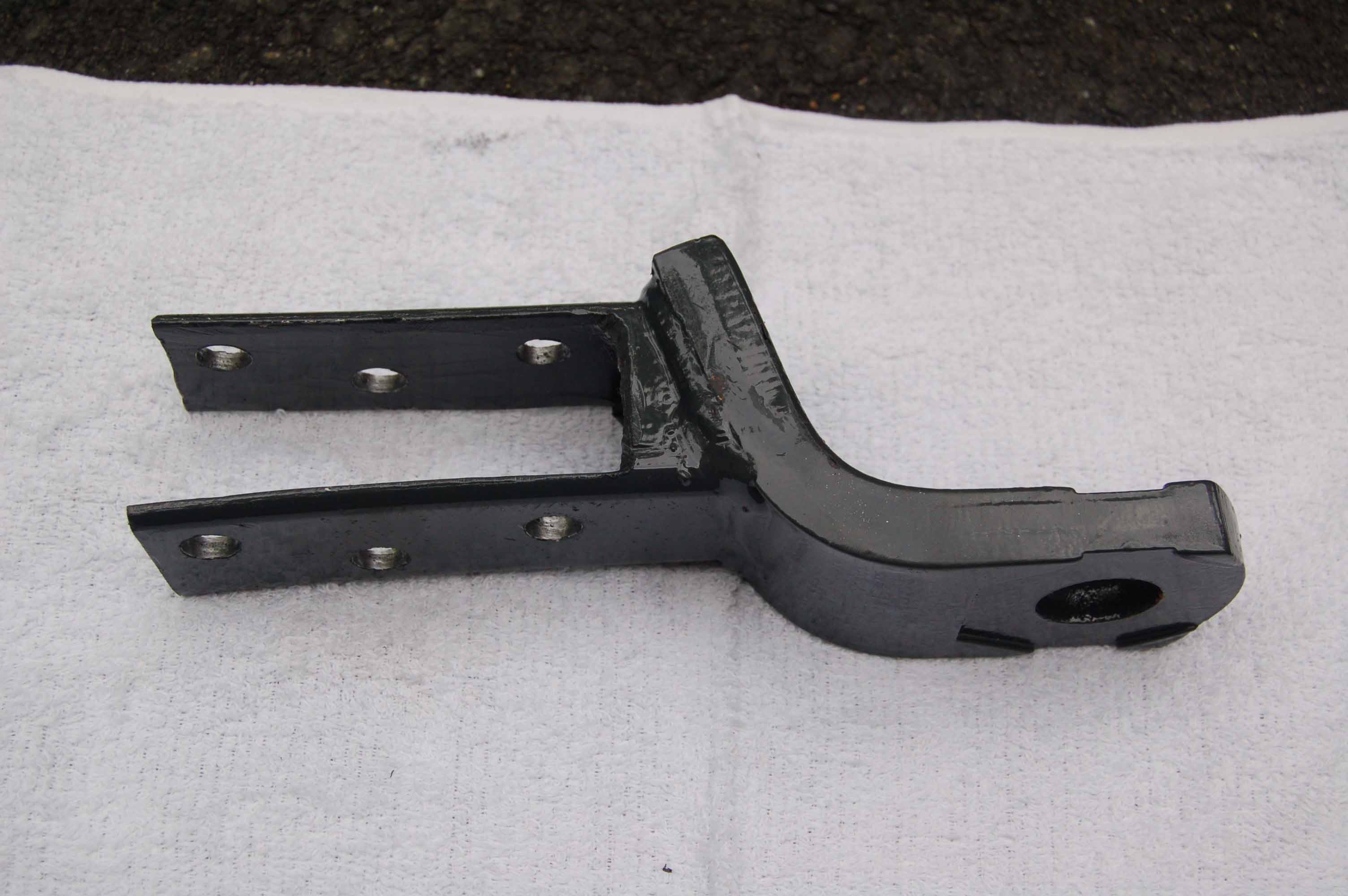

This is how I solved the issue for me. I have a nice hitch for the 3PH, but I hate to take teh BH on and off just to access it. So I mounted a ball to the BH.
I've pulled my 20' trailer around the yard loaded with post-storm tree litter without any problems.
And no holes.
This is on a Woods BH6000, so I'm not sure if it would work on your BH. Step's prob'ly different Just an idea.
EDIT: Darn...beat me at my own game, Mr. Hedgy. You rock.
