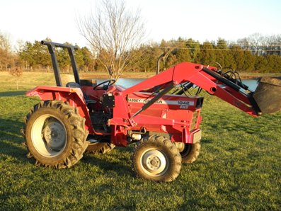

here is a photo of my Massey Ferguson 1042
