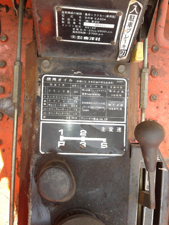

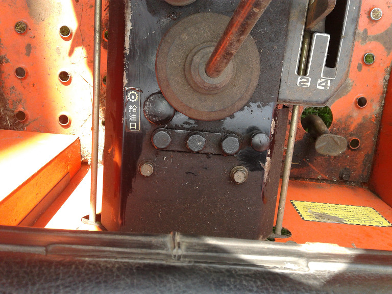

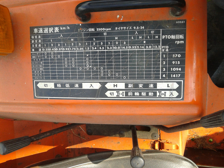

Since their is not much info about these little beasts, here are some pics of the original info decals, might help somebody who has unreadable decals ...
