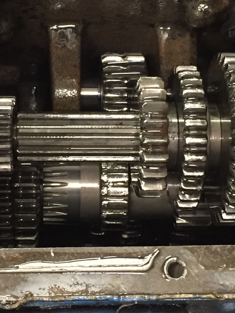

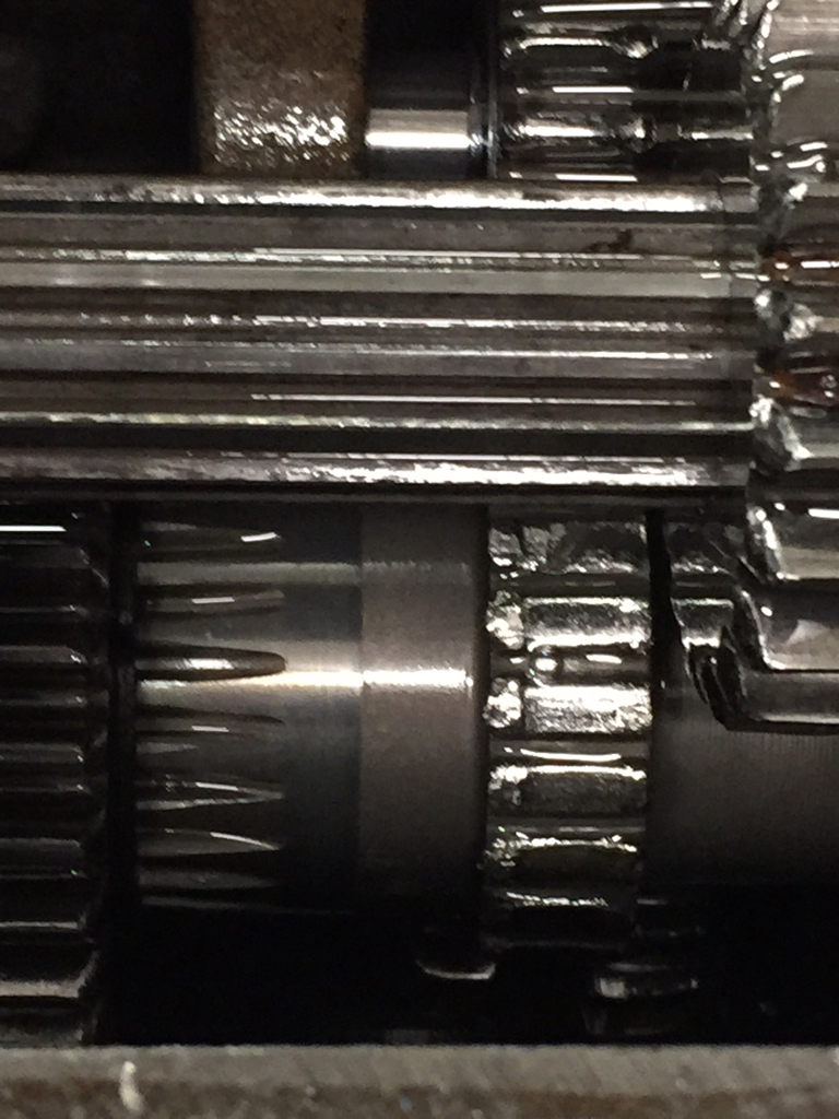

Bought a Hino in really clean condition.
Bought under 600 bucks and only thing wrong was water pump and missing 2nd and reverse gears.
Water was easy, but after draining the transmission and flushing with deisel, found a gear on the input shaft (bottom shaft) with stripped teeth.
Has 1 and 3 and for a bit I can live with it, but how hard is it to change that gear out?
I assume split the tractor, do I have to take the diff apart too?
Is this something over 1000 for a shop to do?
I would like opinions please,

Hinomoto 370 not 379
   / Hinomoto beaver 379 2wd lost 2&R #3
Haven't HEARD OF A 370. If it is an n series, the gear were have to be repaired or made. I'd think labor would be blow $1000.
