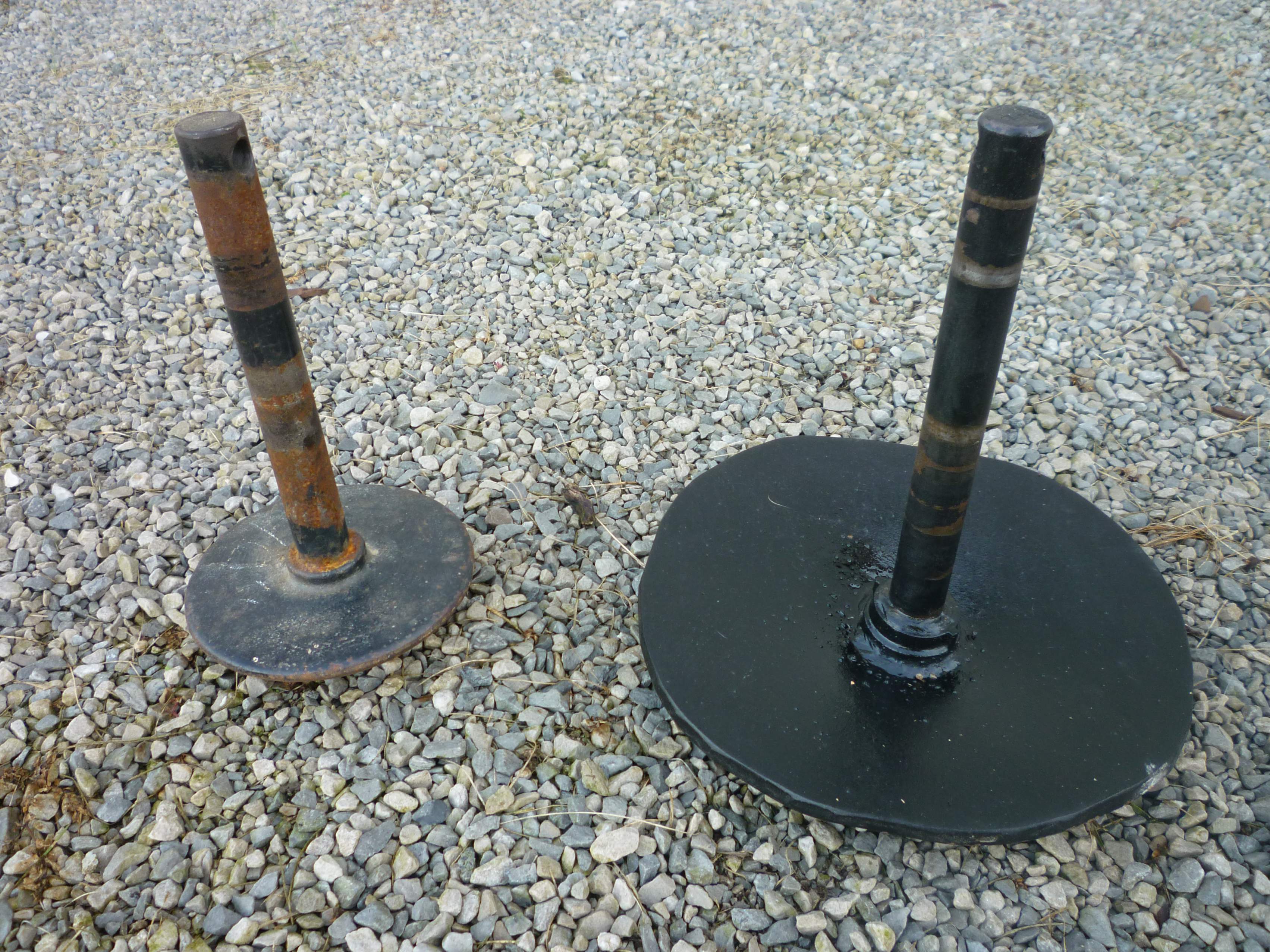

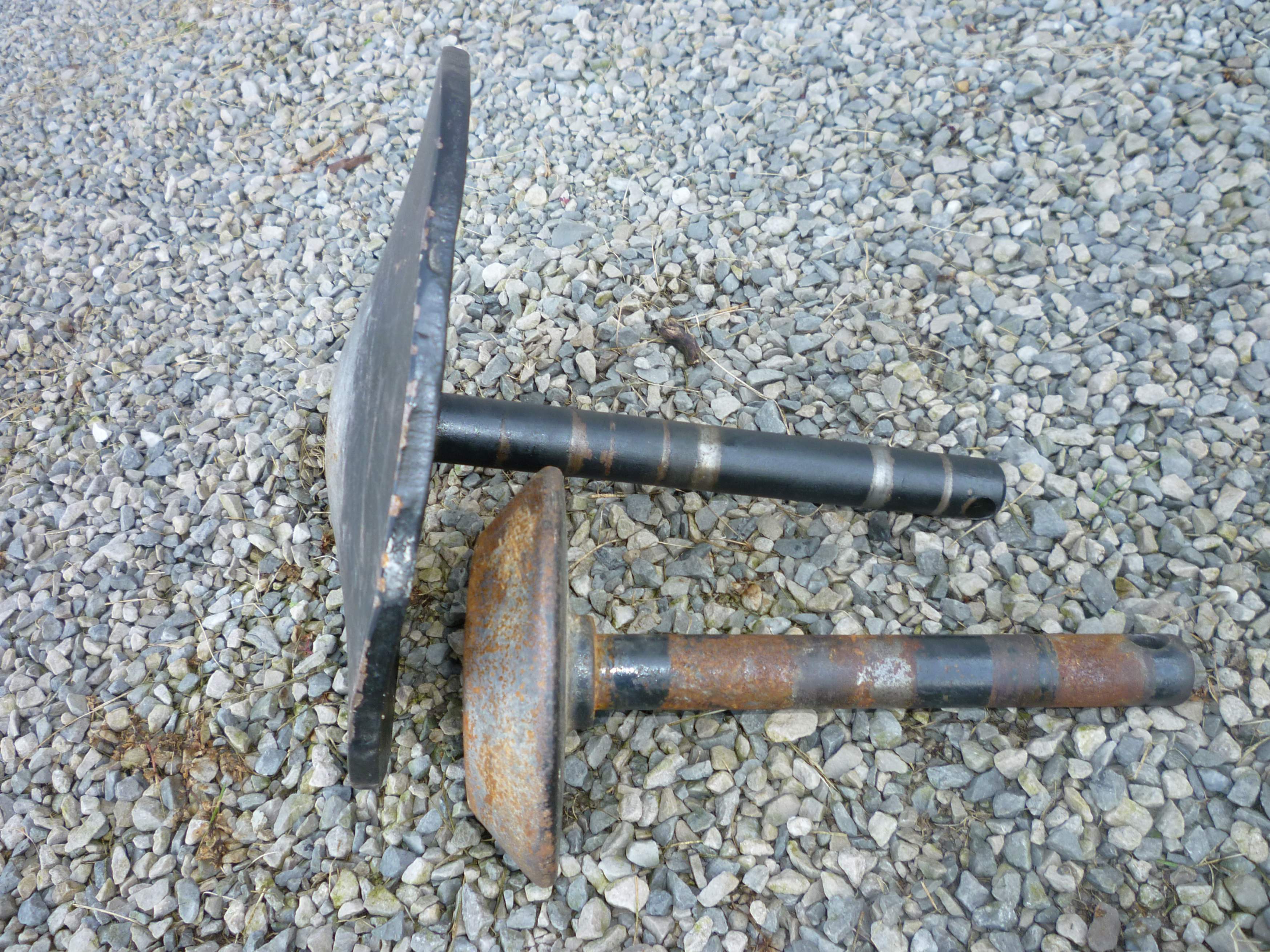

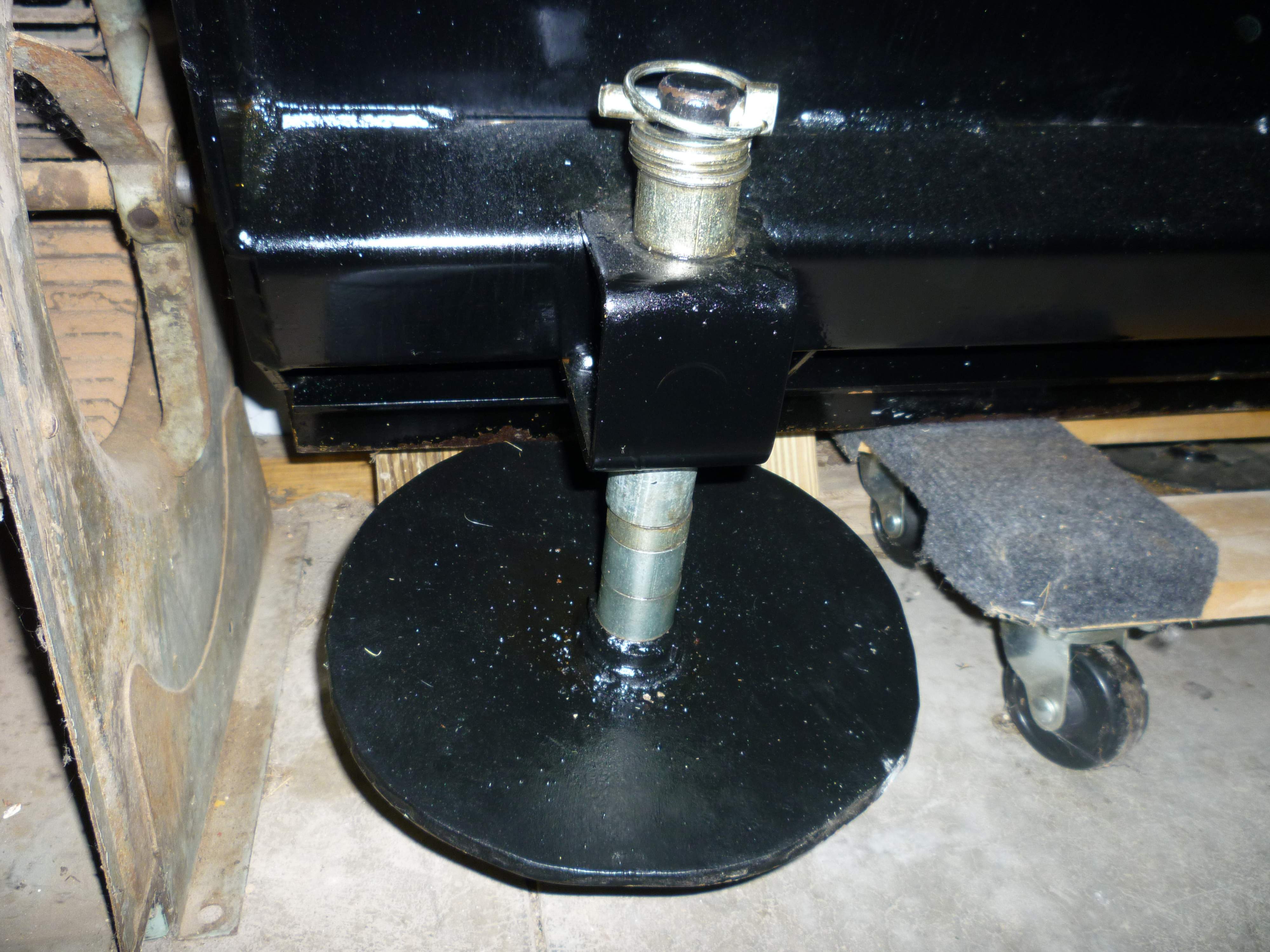

I swapped out the shoes on my Hiniker Big Ox for some larger custom shoes. In the attached pictures, you can see the difference between the originals and the larger 10" shoes I had made. The larger shoes make a big difference when plowing the soft mushy drive when it's not frozen solid yet or the frost is thawing in the early spring.

Thank you for the great info. Those are definitely huge shoes! I wonder why they make the available skid shoes so small? I would think if some company make them they could sell a bunch of those nice big skid shoes.
