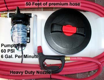

Hello, I am investigating building a sprayer for fire retardant. I found one that advertises a 6GPM @60PSI pump for about a 25 gallon tank. I can find 12v pumps that do ~4 GPM at 45 psi, but I cannot seem to find a 12v pump that will do higher volume at higher pressure. Any sources you know of?
Thanks

Your not finding them because the torque required for 6GPM@60PSI requires a large motor and a lot of electrical current. Probably outside the normal practical applications. I am sure someone makes one, but you are going to have to look. Here is something close from Surplus Center. Note the 30A current draw... Surplus Center Item Detail

I think the pump you are looking for would be too much electrical draw on your rtv my cabin has a 3 gpm 45 psi 12v diaphragm pump and it draws close to 10 amps when running. Can your rtv supply that much power continously?

I'm not sure they'll quite make it to the 6 gpm (they might), but I've used Shurflo 12 volt pumps in RVs and on a 55 gallon spray rig that my brother owned to tow behind his Kawaski Mule and I towed it behind my B7100 Kubota. I know they make them up to 5.7 gpm and 65 psi that pull 10 amp maximum. They're pretty durable, but also easy to repair/rebuild if necessary.

I have the RTV900 and now that I think about it there is a hydraulic outtake in the rear where the bed dumps.
Unless these folks are fudging on the pump, there does seem to be a smaller pump (maybe 24v) that will output the 6gpm at 60psi ... might be a marine pump of some sort ..... this image comes from this website
