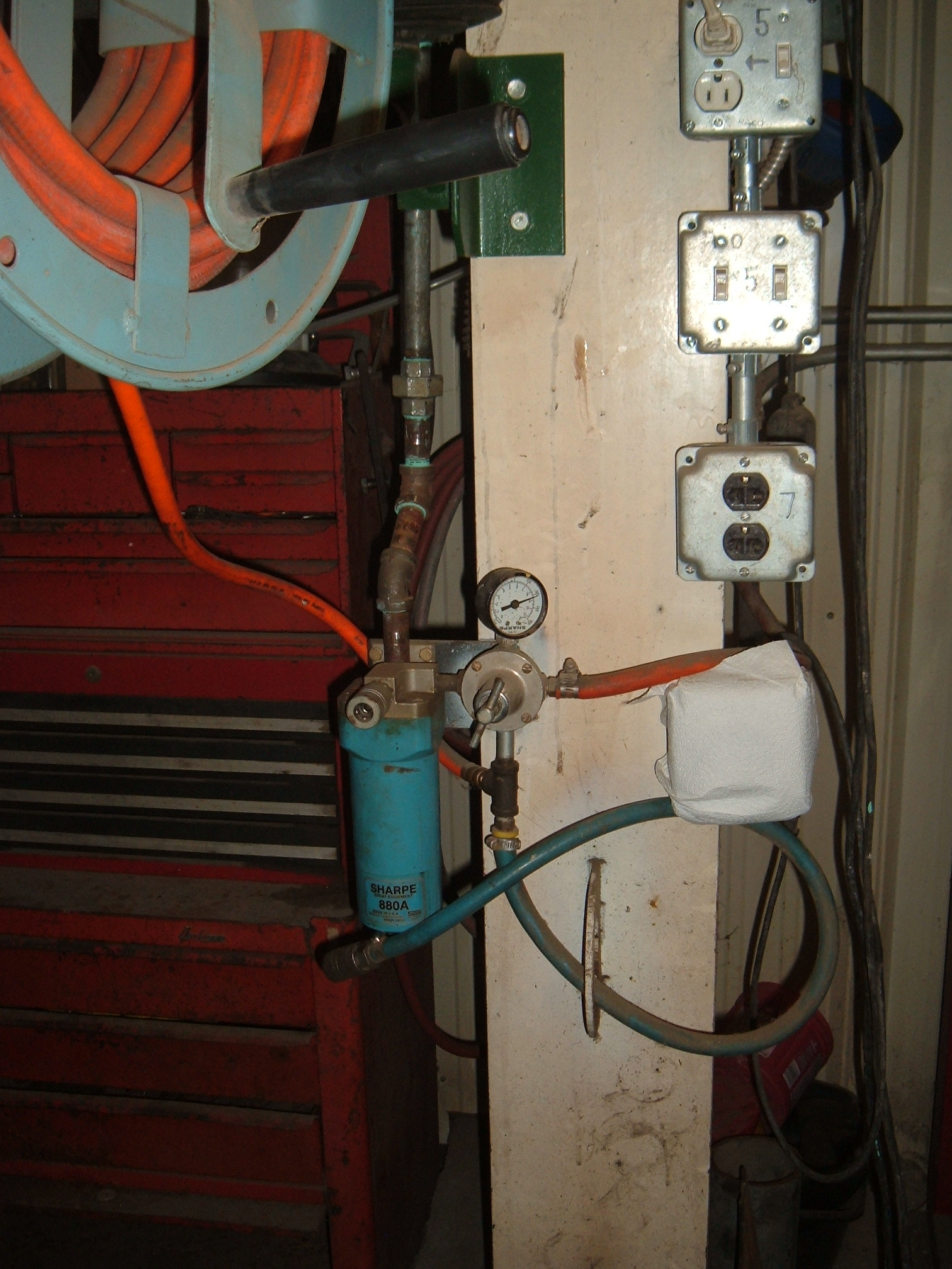

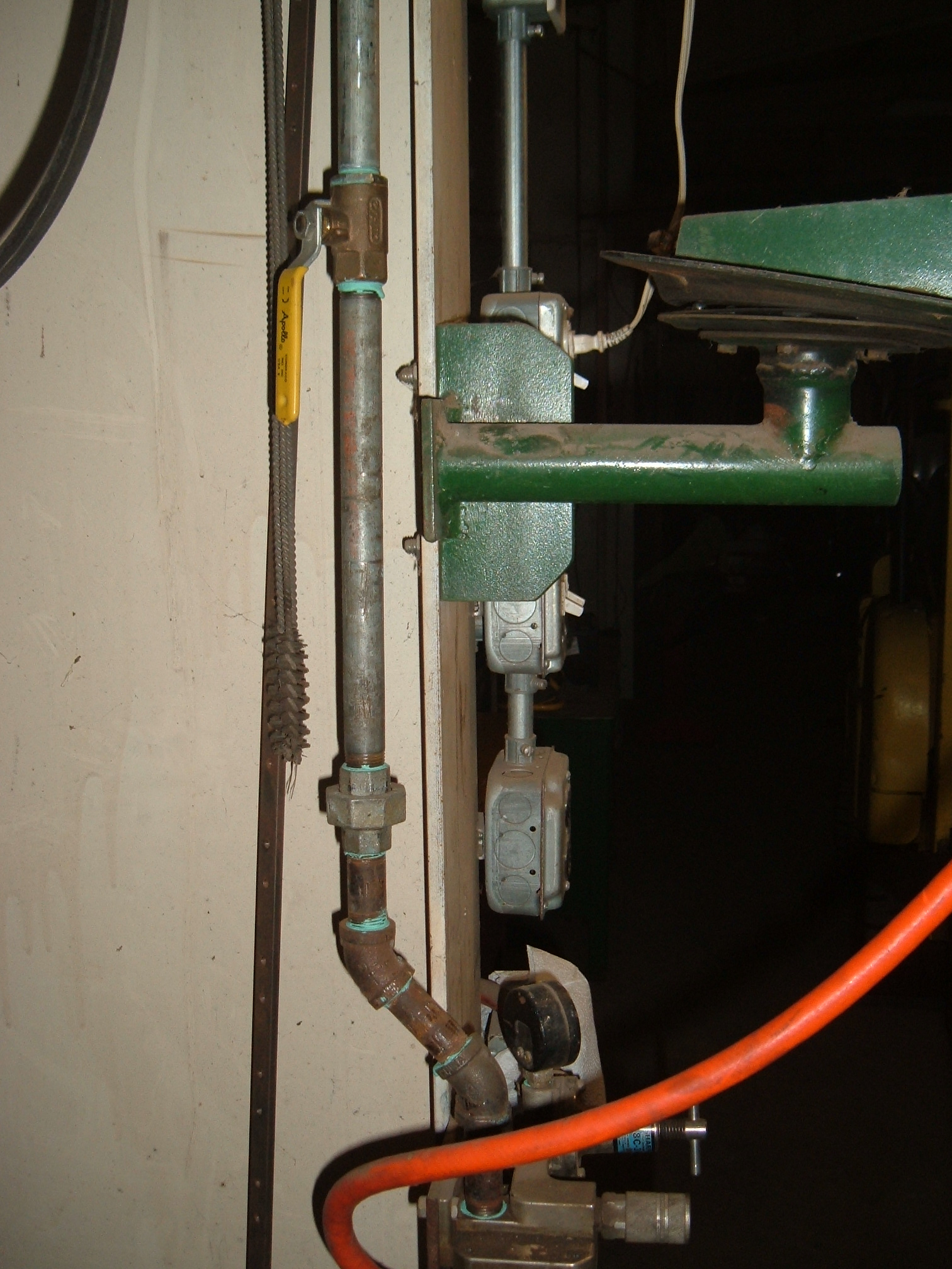

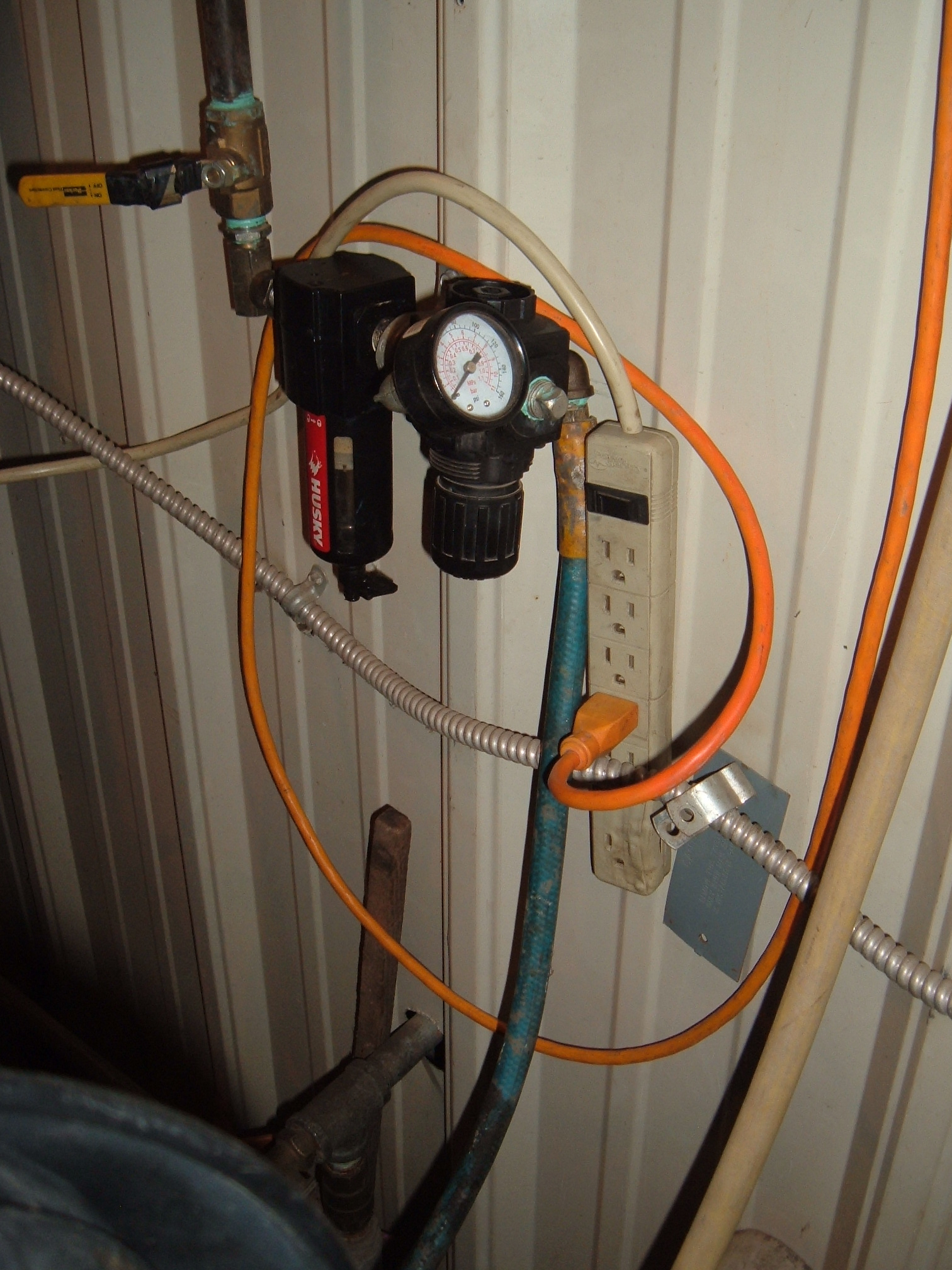

Another thing, we seem to worry about coupler performance and then install 2 or 3 in series. Number 1 easiest way to improve air is to reduce amount of fittings and shorten hose, that could include increase hose size also. A proper air system has 1 quick in it,,, at the tool, from a reel or fixed whip. Those hydrants along the wall are amateur, iut adds another coupler and allows disconnecting hot hoses. If a hose is needed why disconnect the lead and hang it on the wall, I screw the whips on or use reels, all screwed to the supply. No opportunity for anyone to come along and fool with it, hose end provided for connection to tool. Got the place covered and actually overlapped but we never move sections of hose for routine work.
I think someone left a fitting ahead of reg for bypass but it could be removed, we never use it. Note location of service valve, AHEAD of any fittings on hard line for local disconnect. 3rd pic, that reg feeds 1 reel, the one before feeds several outlets.
I think someone left a fitting ahead of reg for bypass but it could be removed, we never use it. Note location of service valve, AHEAD of any fittings on hard line for local disconnect. 3rd pic, that reg feeds 1 reel, the one before feeds several outlets.View attachment 738199View attachment 738200View attachment 738200View attachment 738201
Nice setup!
