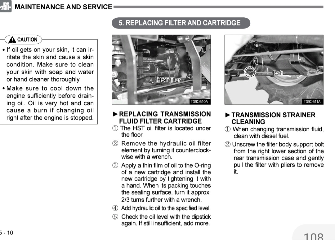

Hi,
I can't find the hydraulic filter on my TYM 474 2024.
   / Hi,i can't find the Hydraulic on my TYM 474 2024? #2
Here's a screenshot from the manual.

You'll enjoy the fact TYM doesn't paint them on like other manufacturers
