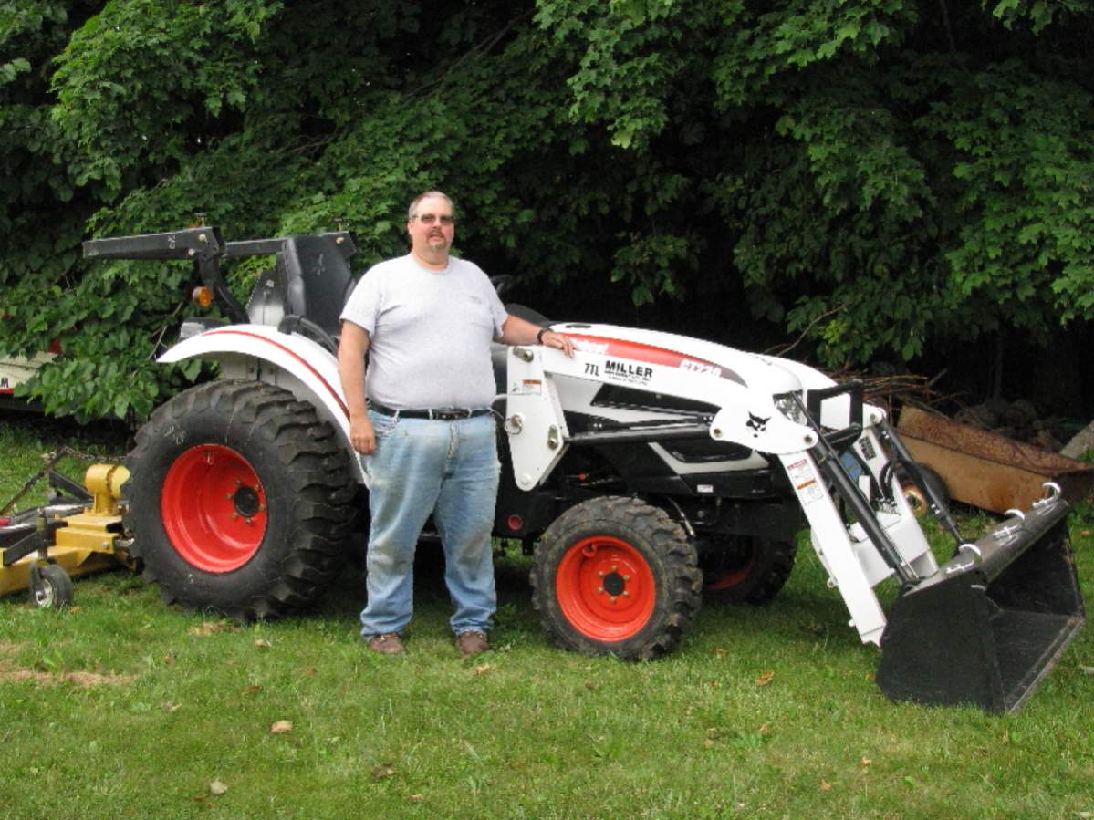

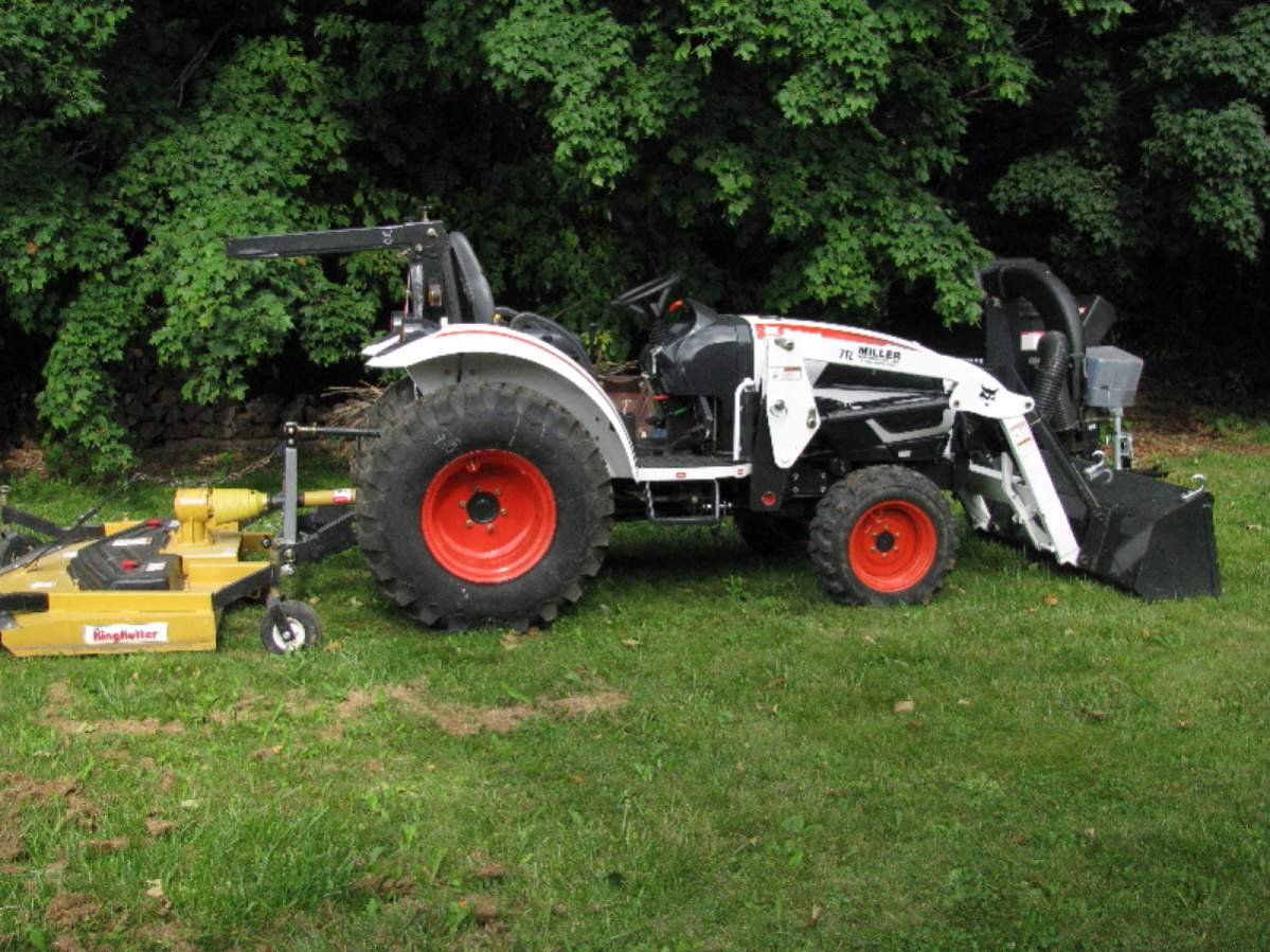

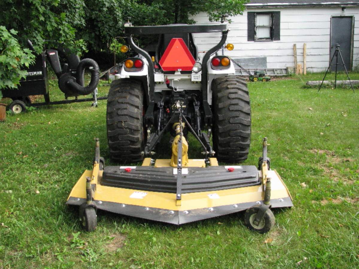

This is my first time posting, been mostly reading. I bought a ct230 about a month and a half ago. Absolutely love the tractor. Anyway I want to add rear remotes soon and I'm wondering how difficult a job it's going to be. Oh I might add it's a Hydrostatic. Thanks Much.
