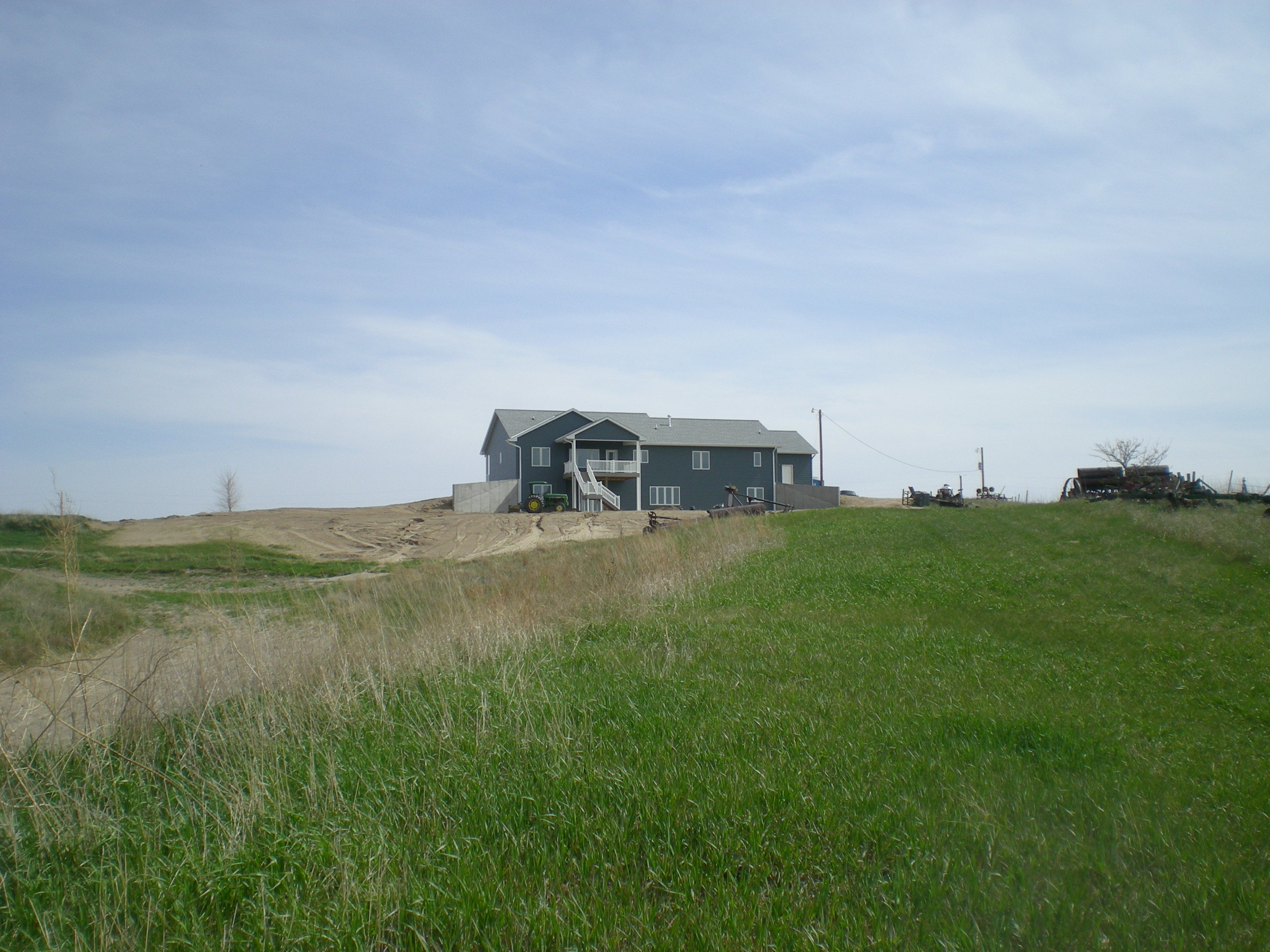

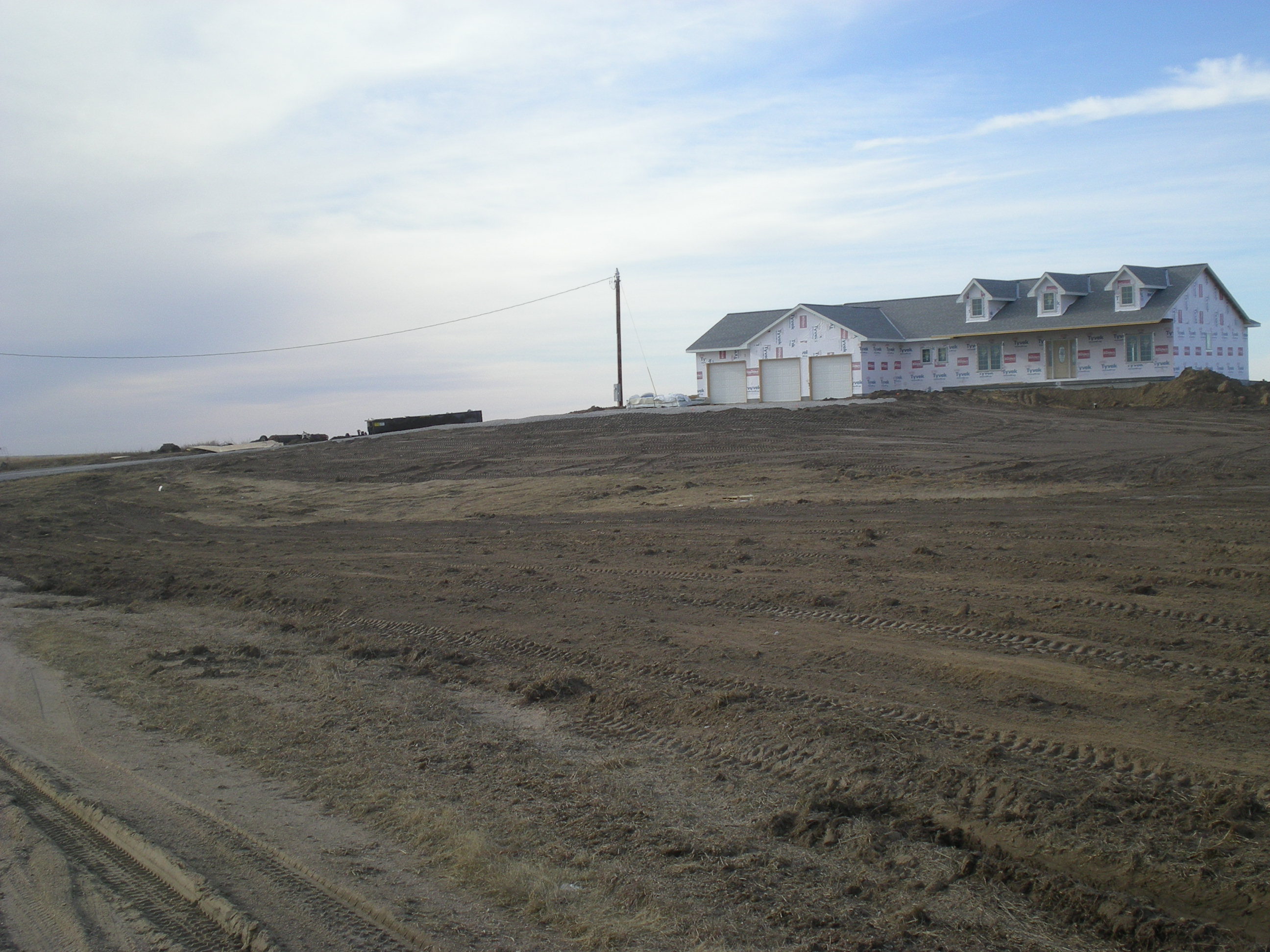

Thanks everyone! I live in Nebraska and get about 3ft of snow on average. Being up on a hill I will end up with much larger drifts than that in front of the garage. I do have a job where I can't skip work if we get a lot of snow. So I need something that will do a great job removing the snow we do get.
I did start out thinking 2000 series. Then the guys at work (all with a lot more land then me) talked me into the 3000 series. This was mostly because of the limitations of the 2000 series loader, thought I would be safer with a larger tractor, higher resale, and larger implements. I was surprised there wasn't much differance in price so thought 3000 was the way to go.
I attatched a picture of the back of the house and the front. I don't know helps to see what I am looking at. These are older pictures.

After looking at the pics I would go with the x748 with a 7 iron 60" deck and a front mount 54" snow blower.
With some landscaping work and a little smoothing with a landplane grader you could mow at a good speed. Certainly no need for a bush hog on this property. Once this place is landscaped there wouldn't be much need for a larger tractor. I would skip the larger compacts such as the 2000 and 3000 unless you want a tractor to play with.
